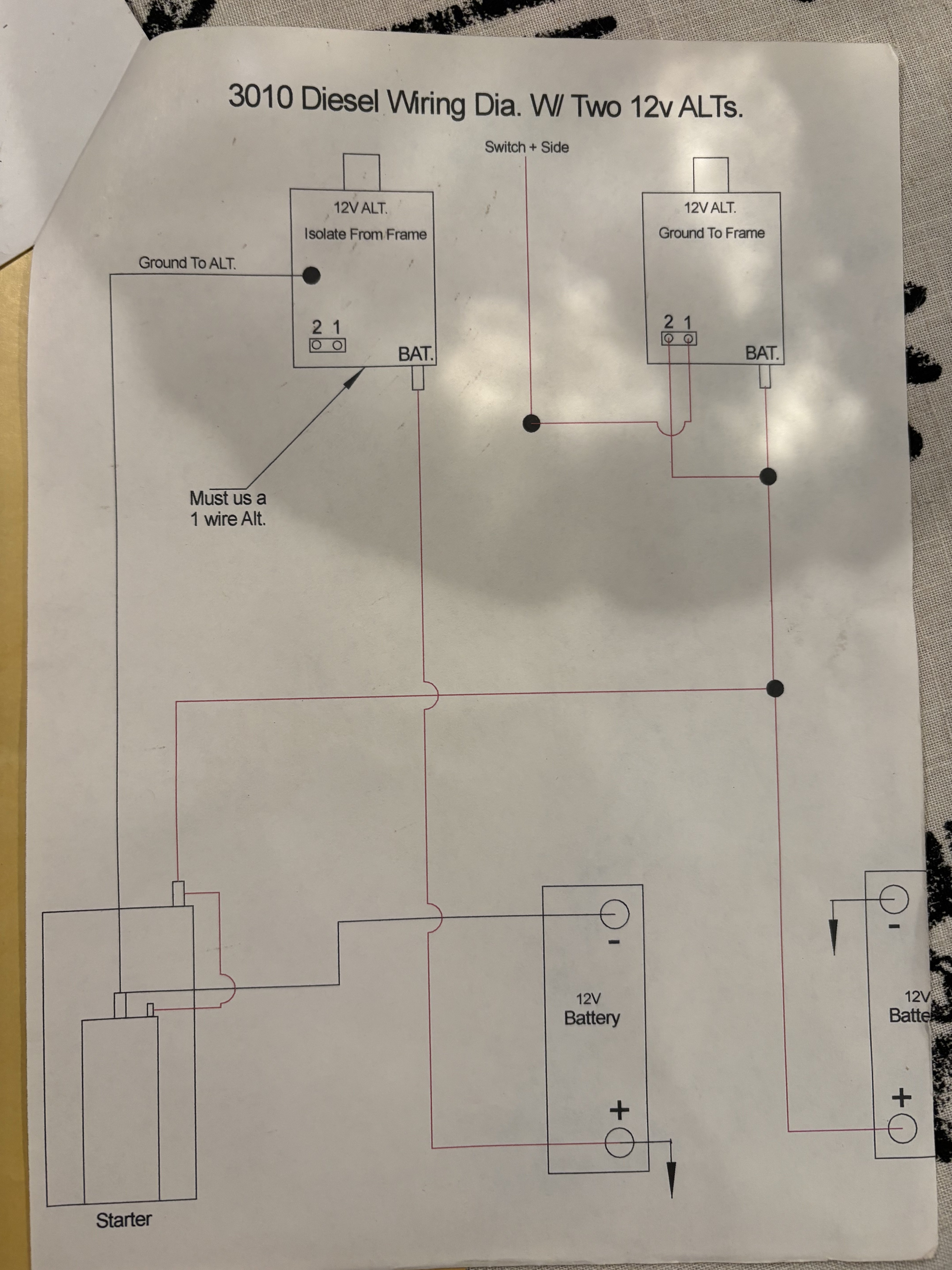

If you change a 4010 over to 12 v system with alternator what all has to change and can the same wiring harness be used or not?
Does anybody have a 4010 with a factory cab they can post pictures on here?
Starter is the expensive item
Remove the voltage regulator
Decide if you are using original battery locations and if so remove the midpoint ground and make a chassis ground cable that to both battery negatives and you will similarly connect the positives in parallel.
My 4020 has a replaced wiring harness from the 70s
If it was me I’d buy a harness for your 4010 from brillman setup for the 10si
Both standard and row crop it would be b3028-205 as the part number for the engine harness and that should be all you need. It’s 284 dollars and but then it’s done right no splices nothing that would rub.
If you do the whole tractor the lighting harness is a different part number for the standards
The good news is all the lights were 12 volt so no need to mess with that if they work but you have some high dollar choices to make
One can use the original 24 volt wiring harness by attaching both brown & blue wires that were originally attached to 24 volt starter to top post on 12 volt starter solenoid. If one wants fuel gauge to operate correctly then fuel gauge must be changed to a negative ground fuel gauge similar to 4020's after serial # 201,000

Batteries & 12 volt starters are much more powerful today than in 1961-1968!!!
I'll guess I understand JD 24 volt systems much better than the average older tractor owner. If I owned a JD tractor with a 24 volt system the very first time that 24 volt system gave me any problems I'd change it over to 12 volt system with a gear drive starter & alternator.
One major drawback to JD 24 volt system is not many choices of 24 volt alternators are available for installation & """having to keep electrical draws virtually equal on circuit A & circuit B"" for generator to keep batteries successfully charged.
