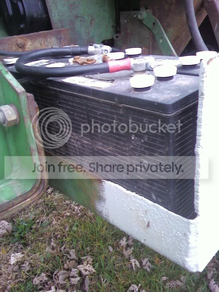

Does anyone have a link or photo of a 4020 that has replaced the two skinny batteries with a single battery?
Just looking for some tips on switching my 1968 4020 diesel over to a single battery.
I was thinking of building a custom battery box and bolt it just behind the starter. Might have it also double as a step.
Anyone have any tips?

Are you still 24volt or have you converted to 12v? You can't run 1 24v battery with out damaging the rest of the wiring. You have to run 2 batteries to get your 12v neg and 12v pos circuits that run everything. If your 12v now I can take a picture of the box that dad and grandpa made decades ago for dad's 4020, was just angle iron and 1/4" plate welded and then bolted to the frame below the starter. Both long batteries sit side by side in the box and use short wires to the starter. The box was running longways (paralell to the frame) at first, but after the loader was installed we drilled new holes in one end of the box and now its perpendicular to the frame still below the starter. It is very convenient to work with his batteries compared to mine with the 2 factory box under the platform. I can try to get a pic of dad's set up later today or tomorrow if you want it, its not pretty but it works great. Oh and on top they put a "lid" that was a plate with angle iron that is a toolbox holder. The lid had 2 slits (one on eache end) that slide over a bolt to keep it from sliding around and the toolboxes have never fallen off (to heavy) no matter how rough the field or steep the hill was and the tractor has nearly been rolled more than once due to some of the hay fields we used to have.

Ok here are some pics of dad's battery box. I took them from my phone before I went to disk this morning.
[/img]
The box is more than strong enough to stand on when working on tractor. I had some trouble uploading a few of the pictures to photobucket (vzw internet card on a Us cellular tower, they periodically bandwith cap me at 1.2kbps upload and download, when I go to town where its vzw tower it flies all the time) I will try to get the last few uploaded later. Its nothing pretty as it stands now, its just functional and has lasted about 40 years. Hope teh pictures help.
