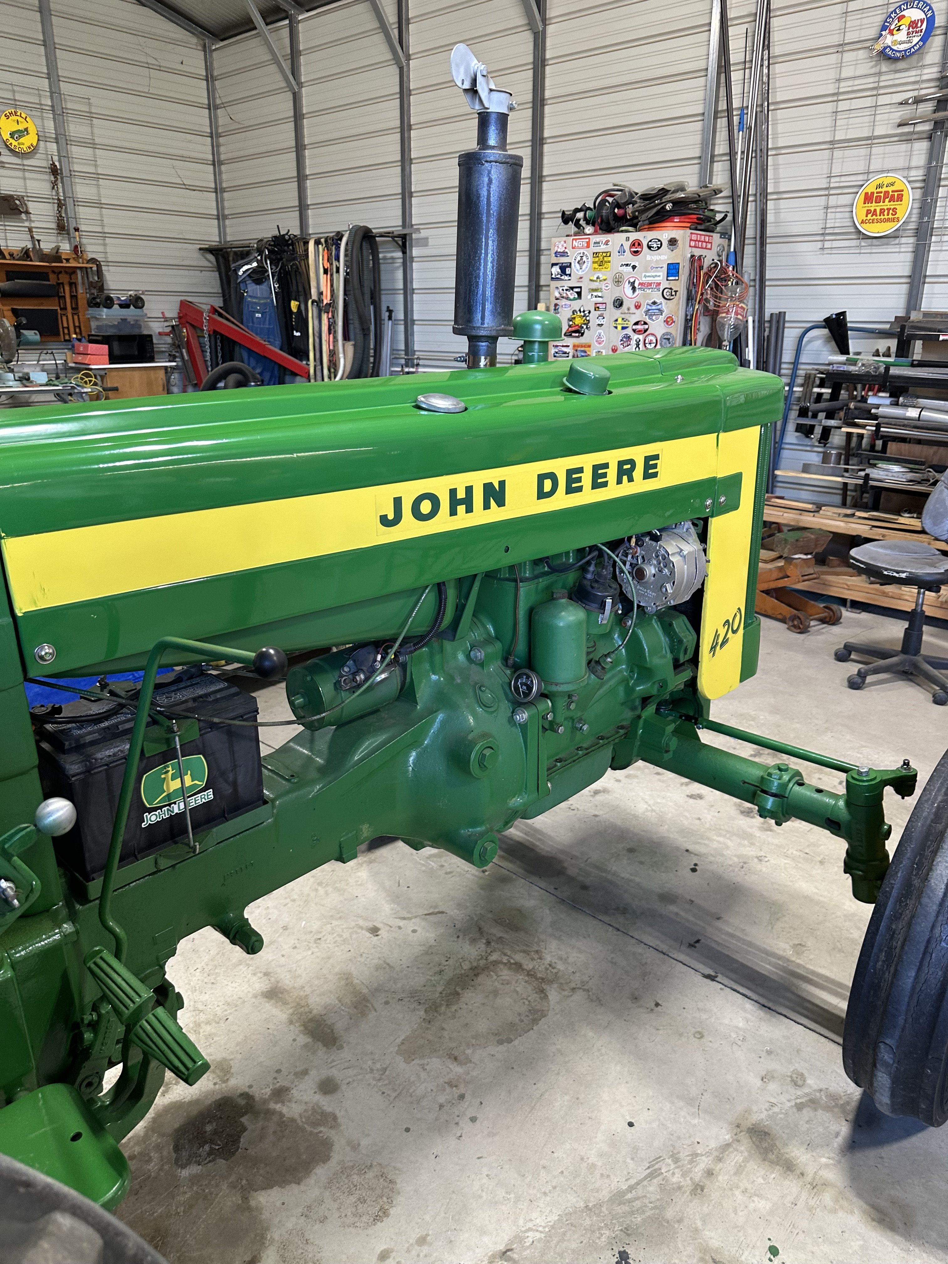

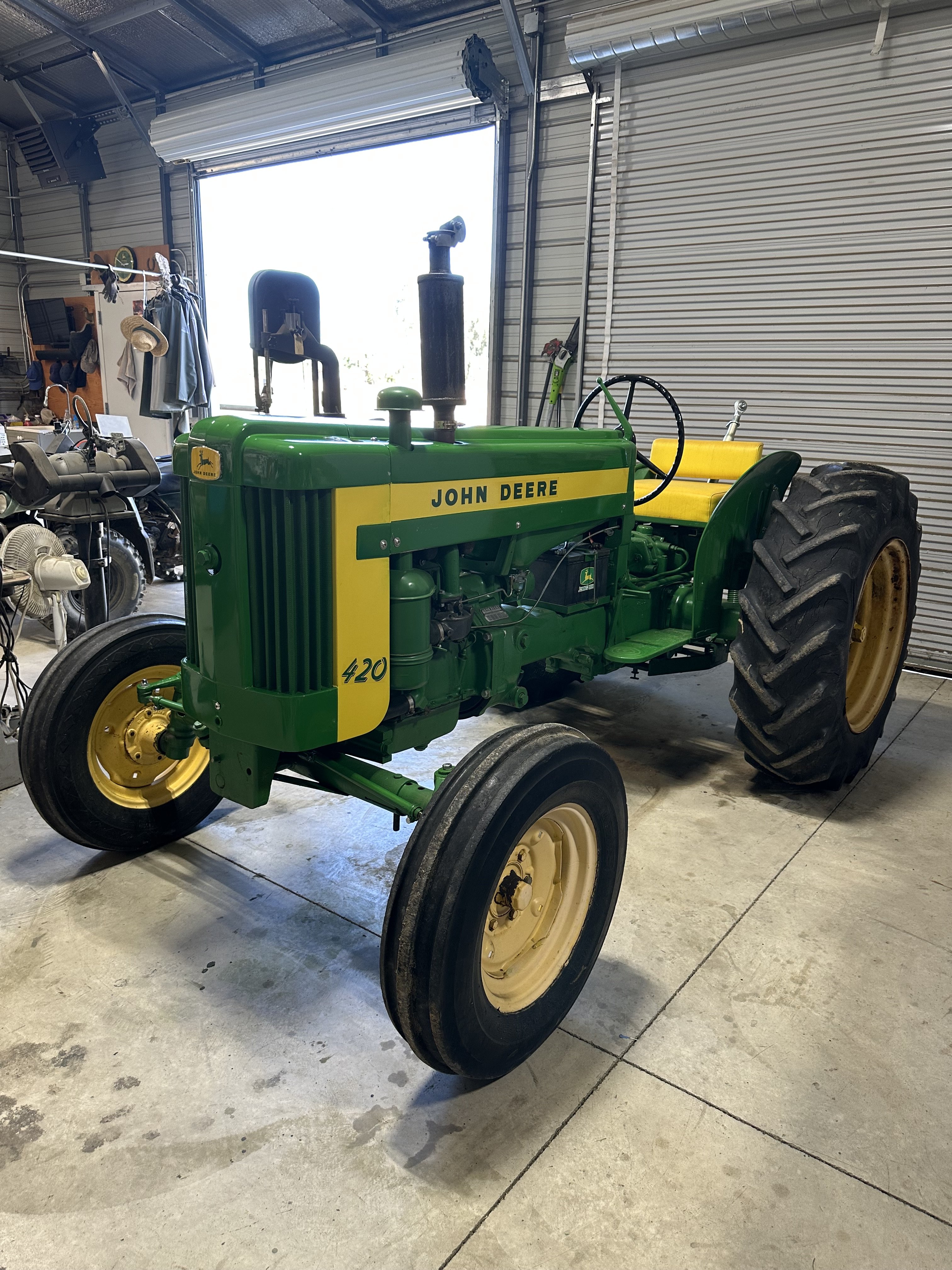

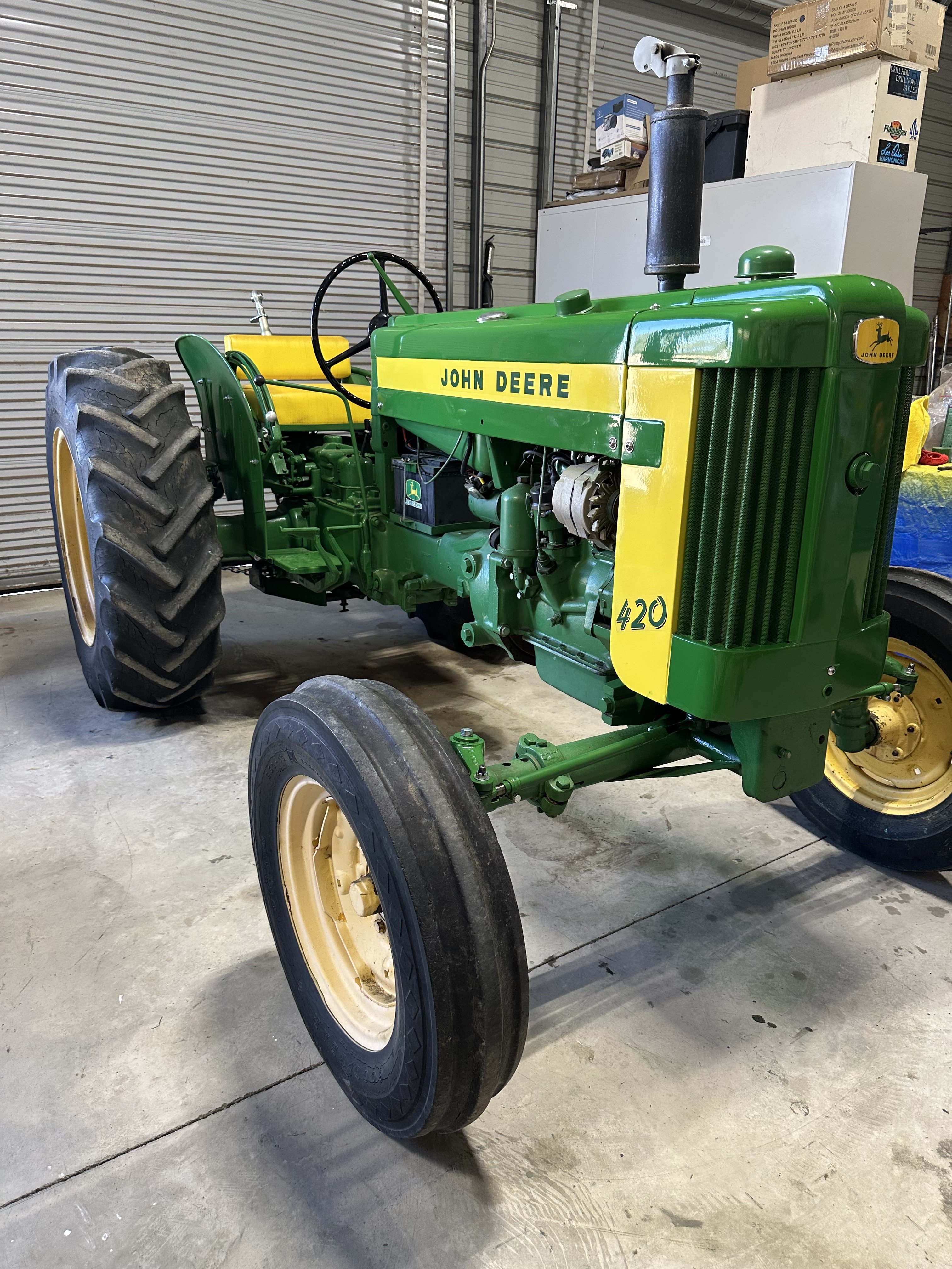

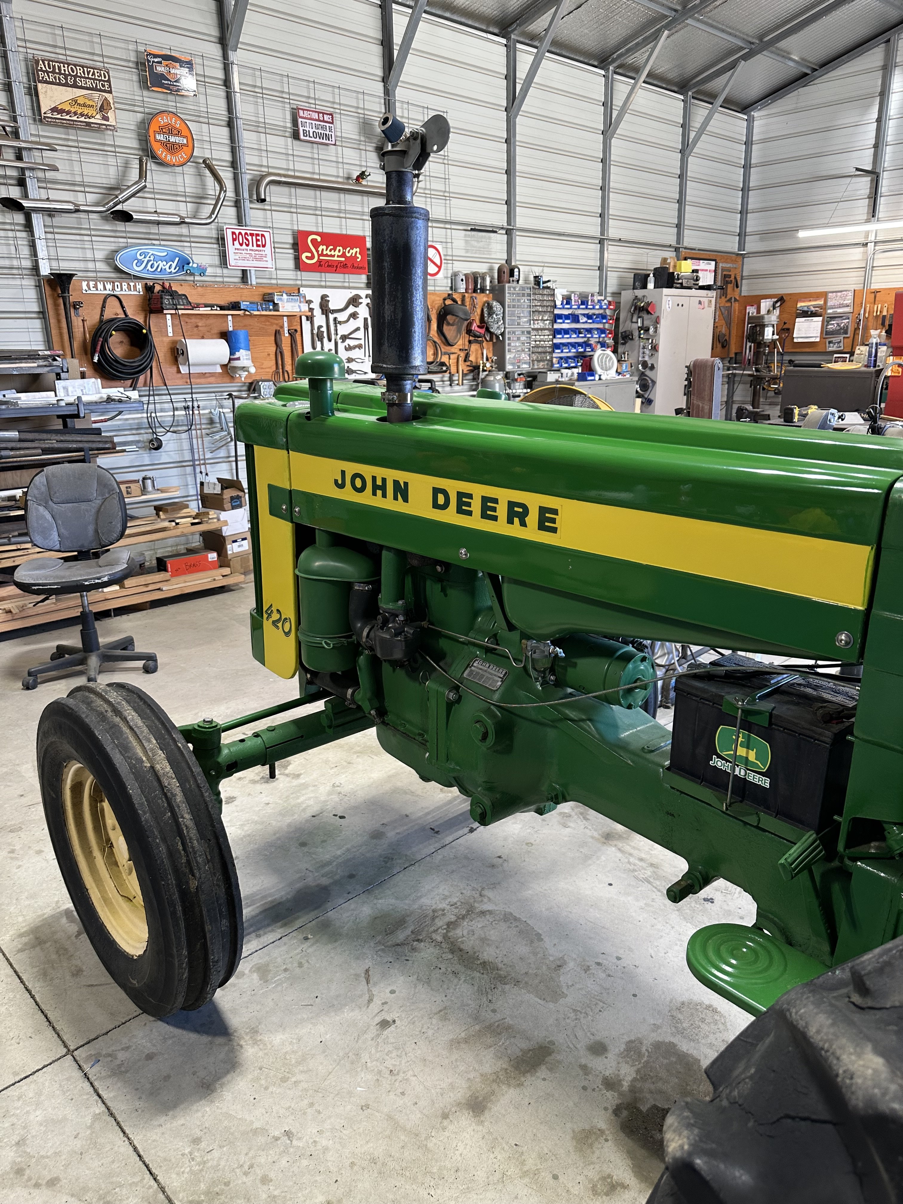

I did my best to get the decals on and I’m disappointed with the type, I like using vinyl letters as opposed to plastic film. I found a very nice restoration online and gauged my placement from that.
Oops. Forgot the pics. I lost one of my hood bolts so I’ve got to get another one. I used stainless steel socket heads.

You took pictures, you are good! The hood John Deere is located different by serial number. I made my own reference guide. You know where all your decals go? In your John Deere 420-430 Parts book, in the back, list all the decal that should be on your tractor. Best decals I know of are; Jordes Decals, can see at Jordes Decals.Org from Iowa 515-571-1027. Good looking decals?
