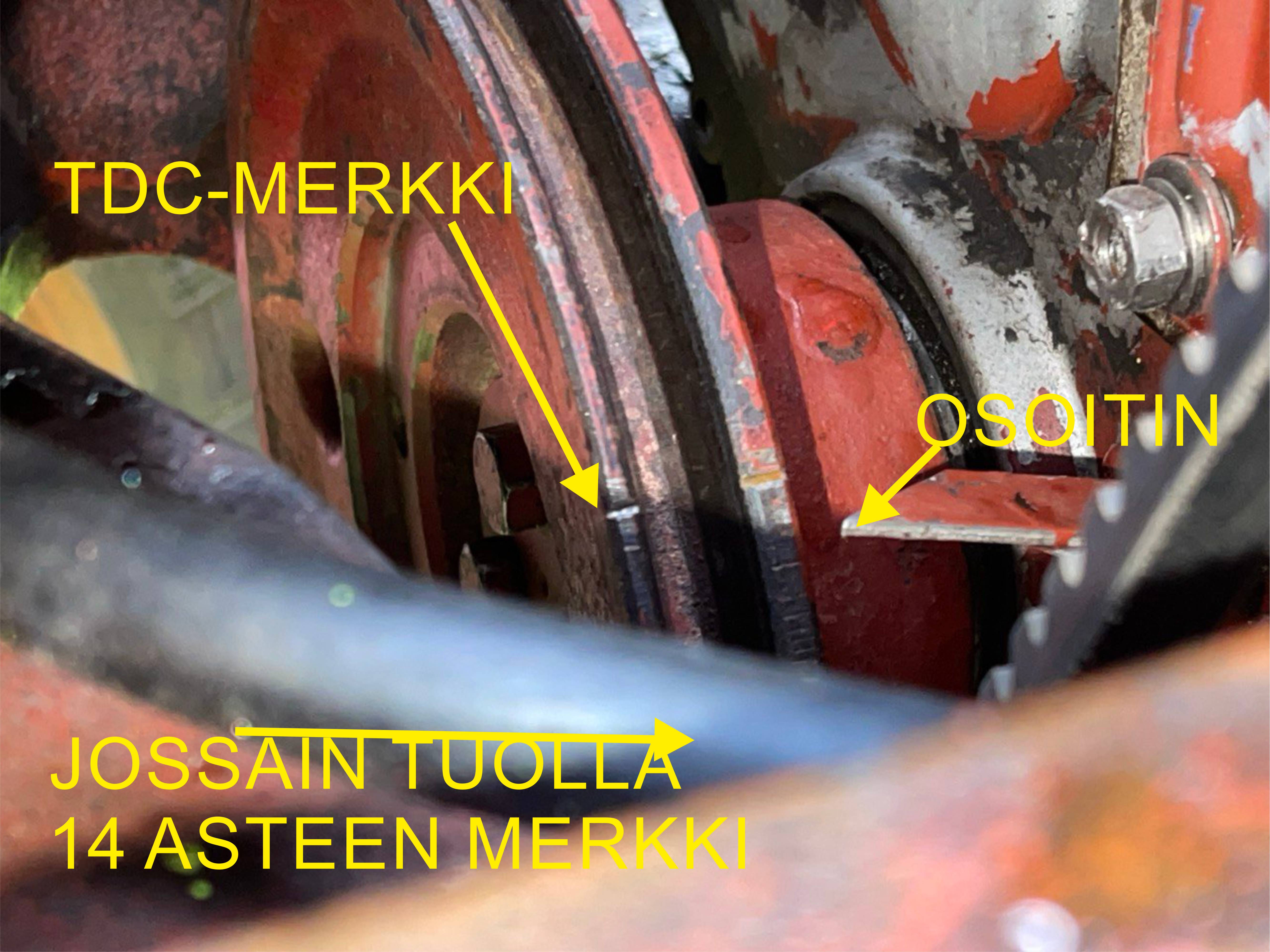

Ok, now I found just "how it really work". In nutcell: "When cylinder #4 change from exhaust to in, cylinder #1 is in work phase". Now I really understand it. Simply rotate motor to right rotation. When #4 valves "change", pulley wheel TDC mark tell #1 is tdc, end of compression, fuel injection (14 degree before of course). And pump mark on position. NOW it is clear and simple!
BUT all is not! (Sorry, texts are finnish, I forget save edit version).
* As you see, between TDC mark and needle ("osoitin") are not near together. "Needle" is attached with two bolt. So it location is "exact". BUT. Needle is near "inner" edge and marks are "outer" edge. Maybe right read position is "from front". But I really I does not want remove cooler, front loader etc etc. I can peek it needle only from a little hole under charger. So- how I can read this? Depend of viewing location... it make about 01 degree error in reading... reason distance between mark and needle is about 50 mm.
* As all stupid persons, I marked nothing. Also injection pump. I open it pump lid and I found it pump timing mark. But I remove it "pump indicator needle"- and when I install it back, I notice it is possible move +/- 2 mm. Of course this make error to timing. Only way is remove pump (again!) and carry it to diesel service- only reason adjust it pointer...?
As you see, timing adjust is not easy. First this pulley mark is not exact. Second, I does not understand it "pump indicator needle" location is adjustable...
