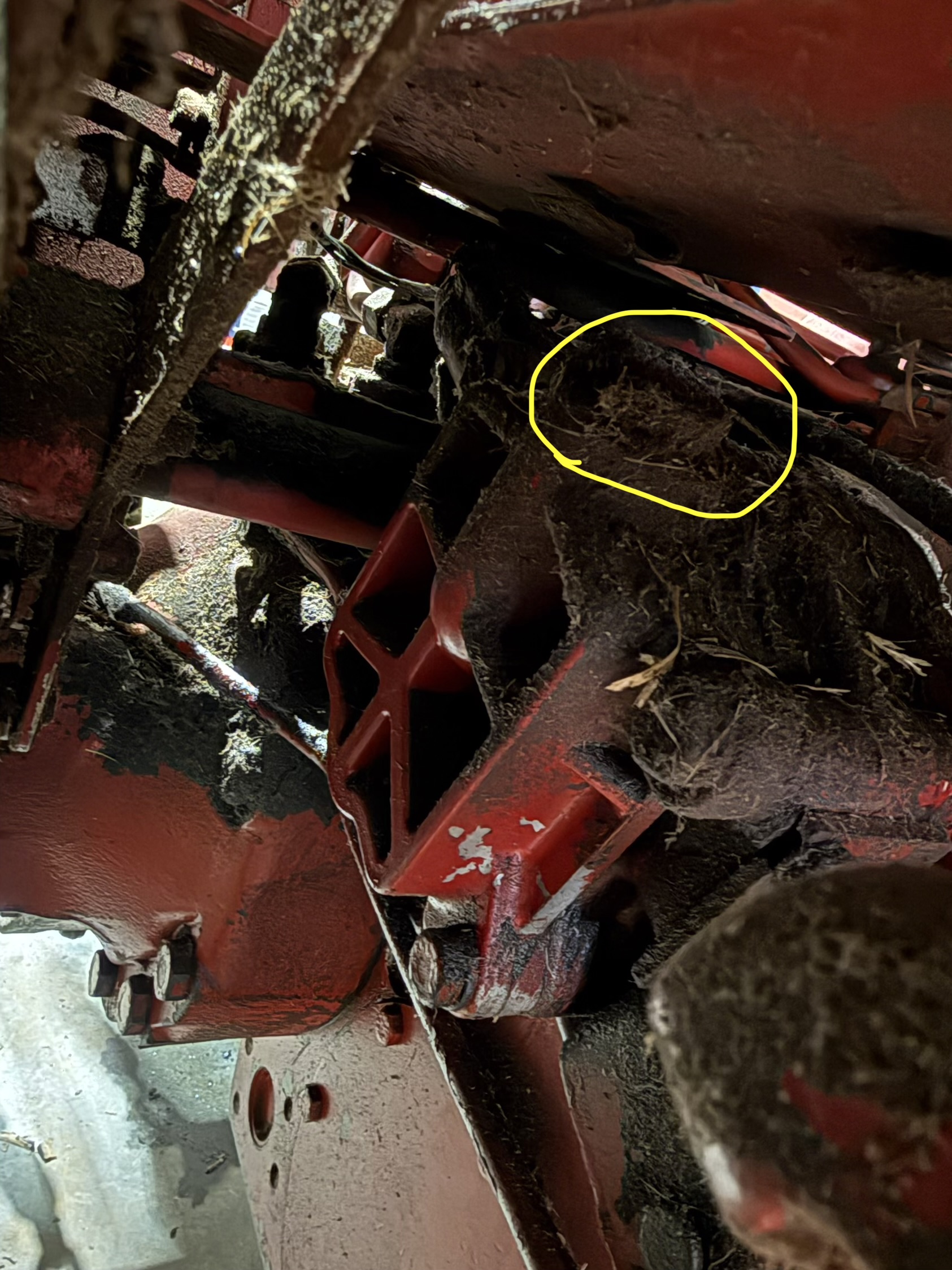

Power beyond---- it would be a block that mounts directly on your auxiliary valve with a fitting on it to hook a hose to go to your 3 spool valve. Then the return goes into a plugin the bottom right side of the differential.. You would still have use of the original auxiliary valve
If your 584 is an IH Louisville, KY, USA assembled tractor then the Power Beyond end plates are expensive.

I know it’s filthy, but there is a plug on the top that I have circled. Is this a power beyond plate? I believe my tractor was assembled in England.
