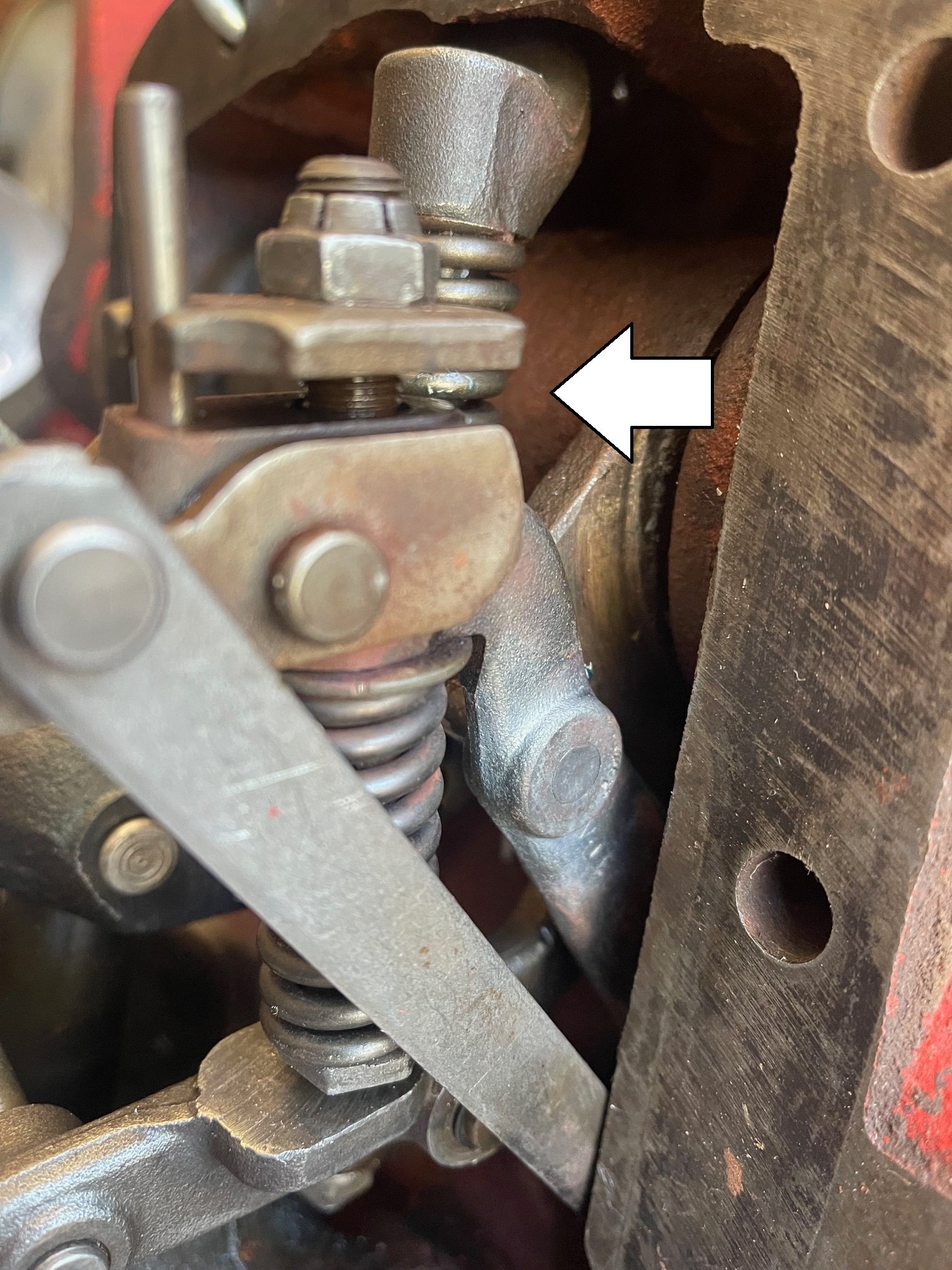

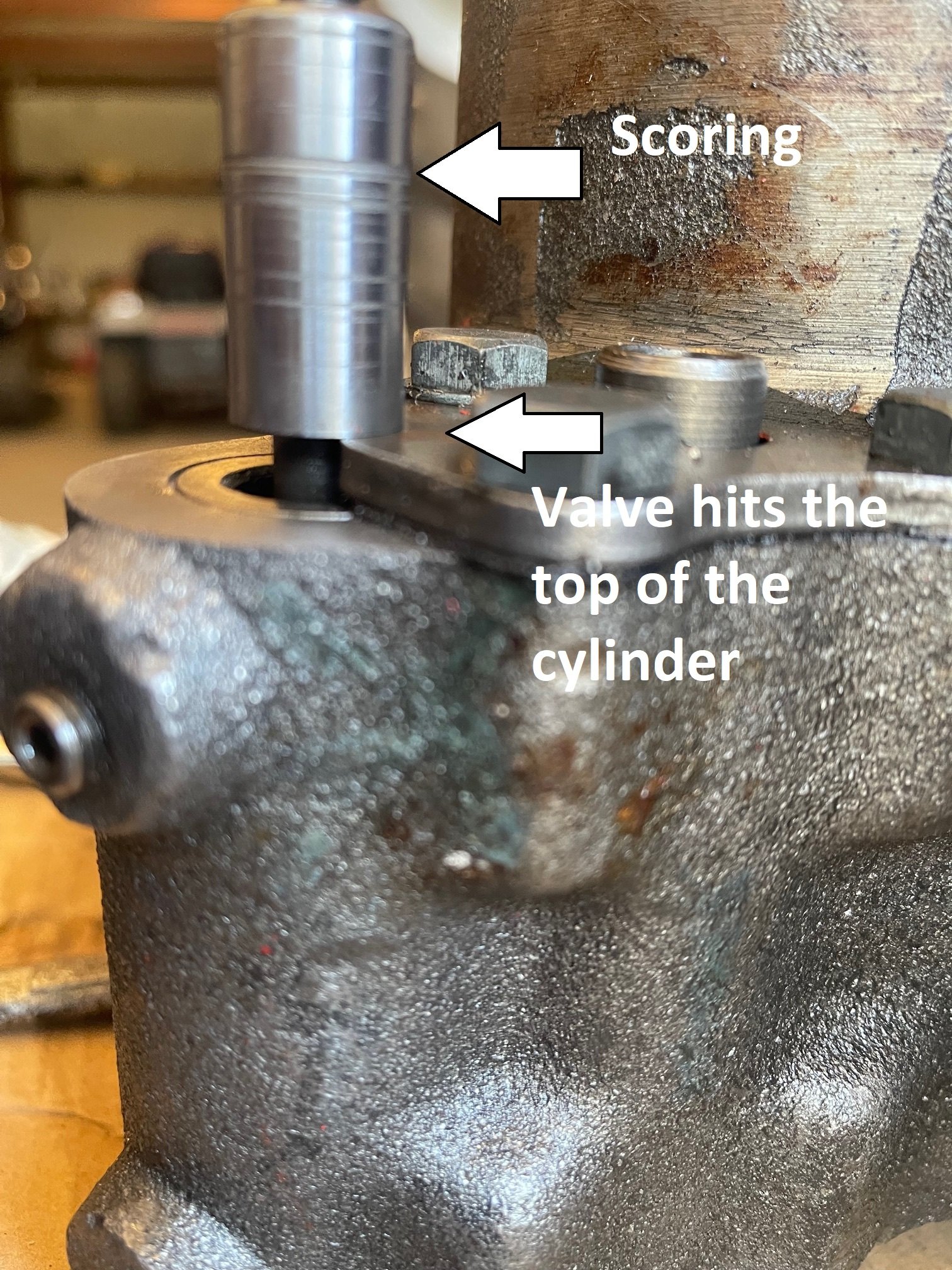

P1 - when I now change from draft control adjustment to position control adjustment the valve hits the top of the cylinder.
Also, anyone know why the valve is scored?

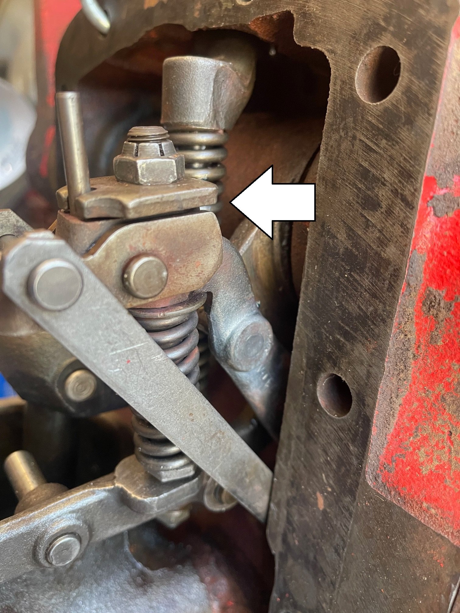

P2 is the gap of the position control spring assy. when the lift lever is in the center position
P3 is the gap of the position control spring assy. when the lift lever moved to the upward position. should the gap be there?
Should the valve hit the top of the cylinder?

My last comment. Really! Do a search for the Chicken House Mechanic and watch his videos tearing down and reassembling the Hydraulic Top Cover. Something doesn't seem right and maybe his videos will help. You may not want to hear this but I would think it better to disassemble every part of the top cover, replace all gaskets, seals and O rings and reassemble while comparing your work to the CHM than to reinstall the Hydraulic Top Cover and hope it works. The top of your control valve that is scored looks nothing like the ones I have seen. ( See my previous picture. Good luck. If you get it working please post the fix.

Before I re-install. a couple of questions.
Update. I went through the video again, adjusted the position control to avoid any collision with the piston housing and reassembled the cover.
The lift arms will only rise about 2 inches no matter how far the lift lever is pulled back - Failure is so depressing.

4. Don’t give up! Are you sure you have the little lever under the seat (position-draft) in the right spot when making your adjustments? Put it in a vise upside down and move the control handle and then the lift arms, it is a mechanical linkage, you should be able to figure it out.
Hi Gene,
The arms will only rise hydraulically 2". I can manually raise and lower them (slowly) by hand and did so several times, thinking there might be air in the system.
Did not work. I thought of the bent idea but did not see any indication. There was some scoring on the valve as seen in the picture, but no one seems to know why or how it could become marred. This might be a clue, but the valve is not bent.
I'm sure I made all adjustments correctly - 3 times. I do not think the valve should be hitting the top of the piston cylinder
