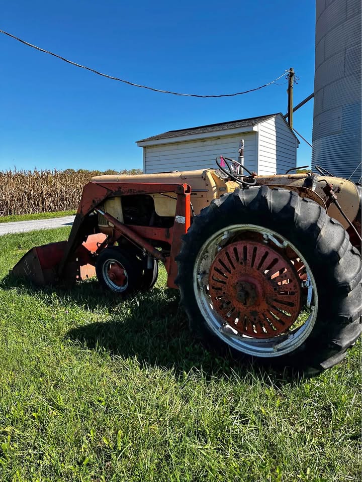

Looking at a 600B Case tractor, with a loader and a Case-matic tranny. I know nothing about a case-matic, what do I look for? He says it workd "really nice". Also it has a factory loader. Asking $3250.

I don't know much about the transmission but lately I have seen a few 600's for sale. I thought they were a nice machine. I would want to see it running and try it out.
If I were in your shoes I would get someone who knows the Case O Matic system andf have him check it out,, if properly maintained they were a great transmission and many have never been opened up. A COM in good condition should maintain full system pressure on the dash gague in Direct drive with hot oil. If the rear bushing is worn the pressure will drop badly in Direct drive and it is a costly fix and some of the parts are NLA. I love the COM but would know how to buy, not to discourage but be wise.

Overall, the tractor seems to have been well taken care of which would entice me to give it a close look. The usual motor checks and a shifting/ driving examination of reverse and forward gears. The Case-omatic drive allowing easy shifting, the oil clear. A lot depends on how you would intend to use it. Light work verse heavy demanding. Cleaned and touched up it would be a head turner at a tractor show.
Thanks, man. I'll check it out, then. My usage would be fairly light.
Grumpy, it would be good to get the tc oil hot, the first failure is usually the rear PTO drive shaft bushing and shaft wear, the oil that engages the direct drive is sealed at the rear by shaft to bushing clearance and when that gets loose oil goes by the clearance and the direct drive will not engage or will slip. If the owner will allow, put it in 4th gear high range, lock the brakes or chain it to something that will not move, and let it slip at full throttle to warm the oil so you can check direct engagement with hot oil. You can not hurt it doing that unless you would boil the oil out of it and I have never seen that happen. Hopefully the TC pressure and Temp gage work. They are not at all a troublesome tranny and many 60 years later have never been opened up. There is a learning curve after you buy and get it home.
