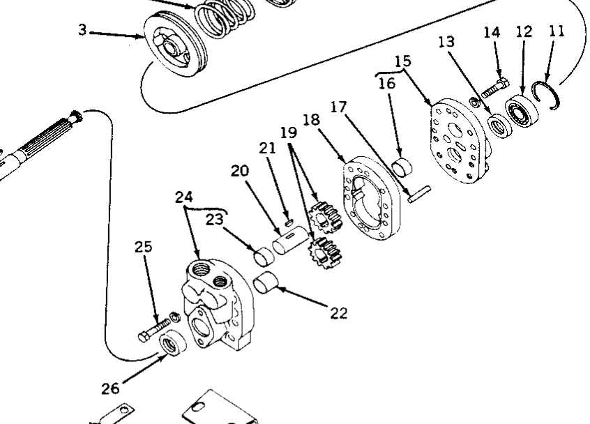

Are the pump seals you are referencing AF1925R? Item #26 and 13?

The original seals were WIDE with two outward- facing seal lips in one "case", the replacement seals are half as wide and you will need 2 for each location Install them with the lips and "garter springs" facing outward and put some grease in the areas between the lips.

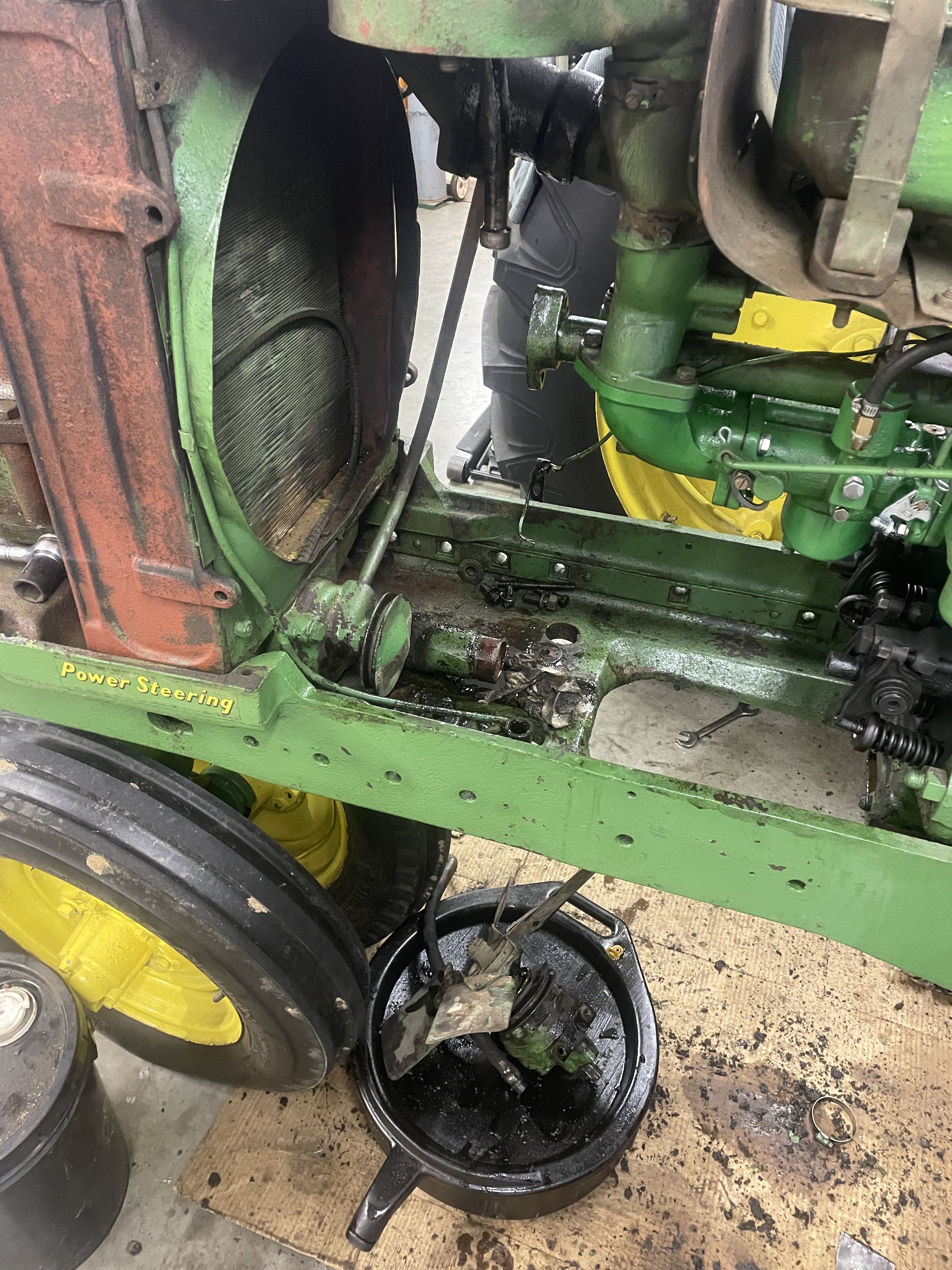

Guess I never tried to get the pump out that way, afraid of hitting the rad. You are lucky the shaft came apart so easy.
It really wasn’t an issue, I didn’t have to slide the radiator forward as some and the manual have described.

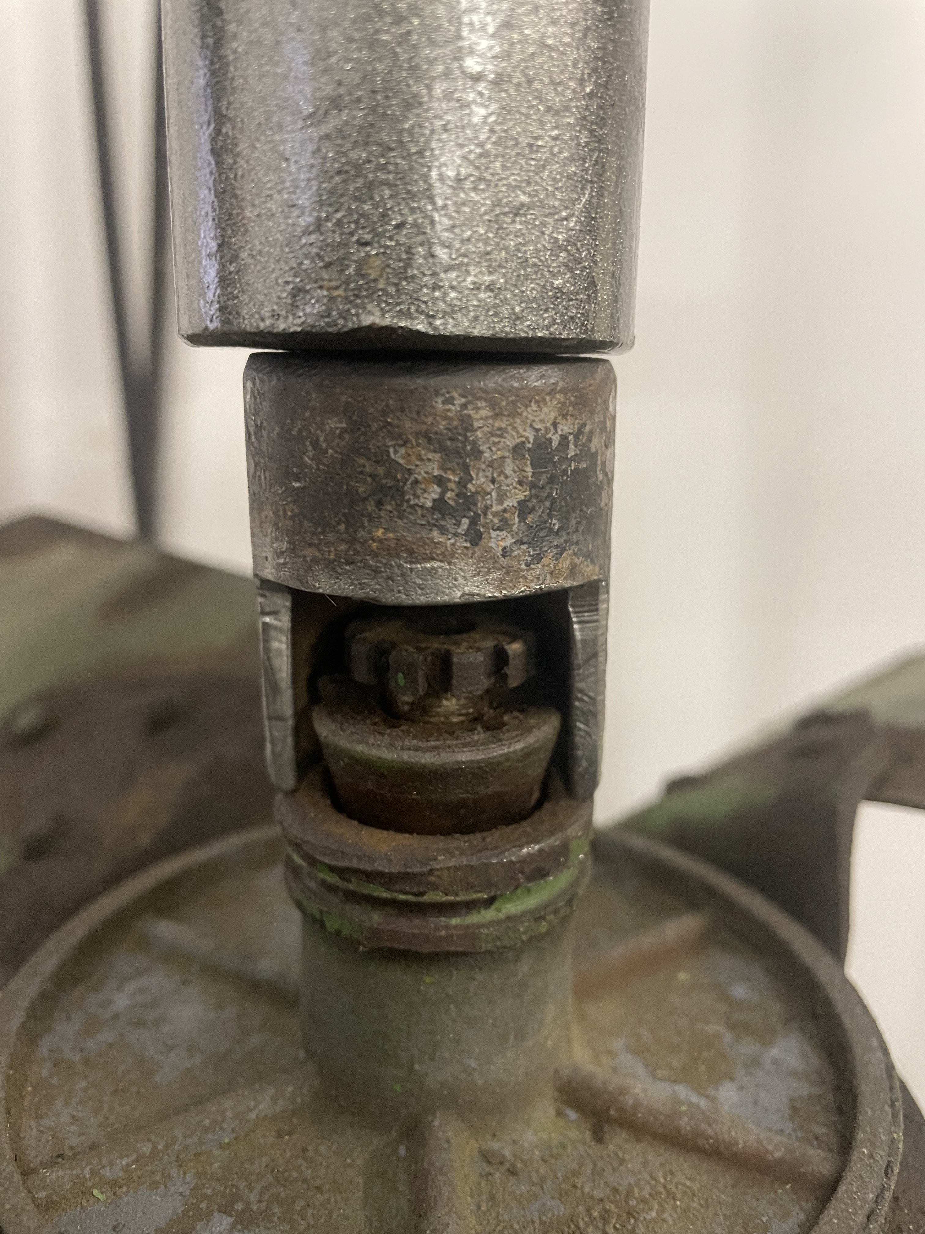

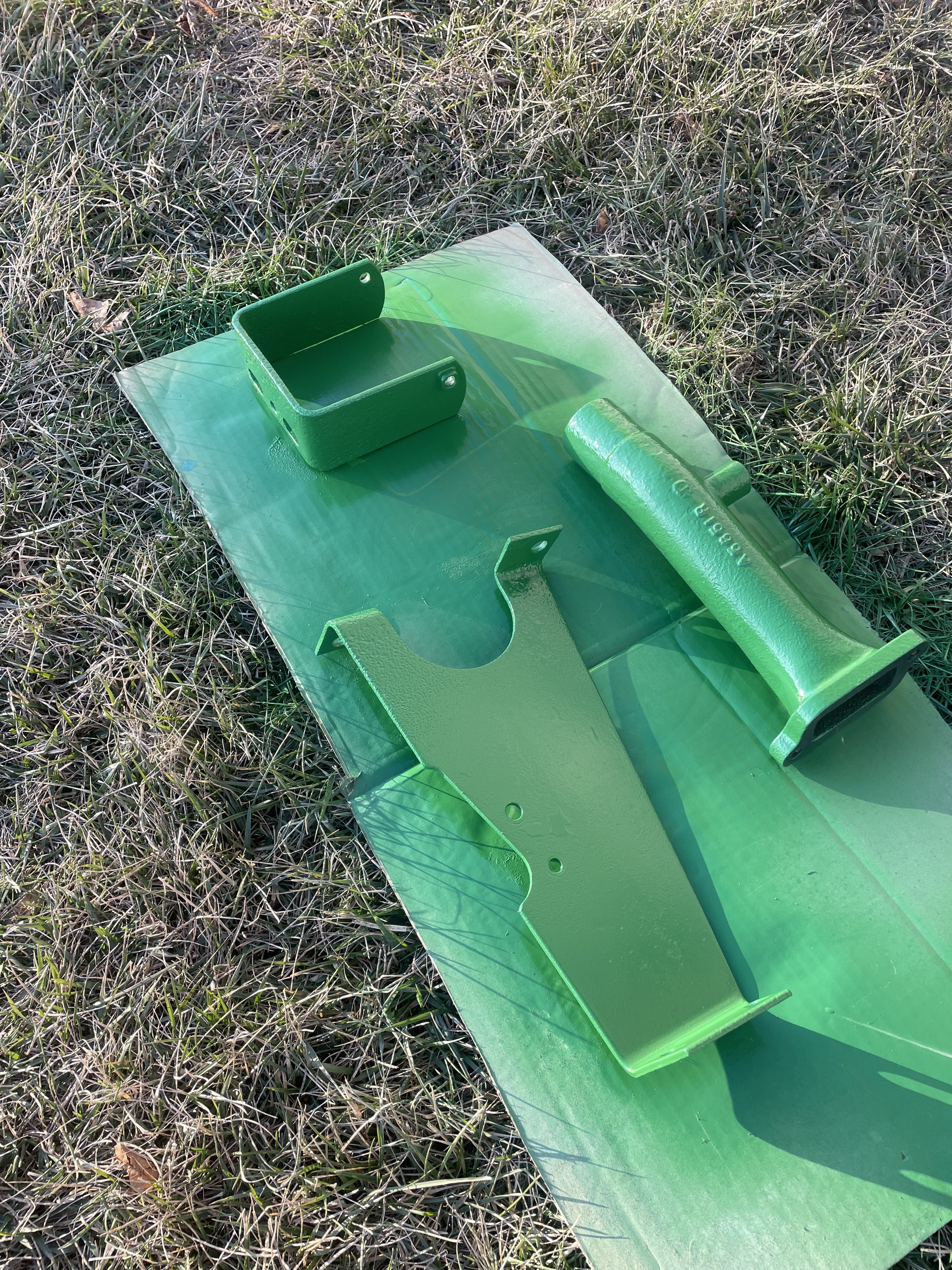

I’ve cleaned up and painted a few parts, removing the fan and splitting the pump is next. Any pointers on fan removal or on how to split the pump? Unfortunately I don't have a press, might have to get creative on that or bring it in to work.

Use a press, just did one . Don't push on shaft .
Like tom said, use a press. Those wedge halves can be a pain. I took a pipe and notched a good third of it away an inch high. I think it's only 3 inches long. Made this for working on a 4020 seat suspension and has worked for this. Make it just so it contacts the outer edge of the retaining collar for the wedges for clearance.
I've gotten the wedges out by using a 1" 1/2 drive deep socket and an air hammer. The 1" socket fits over the wedges but pushes down on the collar holding the wedges in place. The air hammer works great for rattling things loose. If you don't have an air hammer you can try a regular hammer. If you can get things to start moving the spring usually won't push anything back up at you because everything is rusted to the shaft.

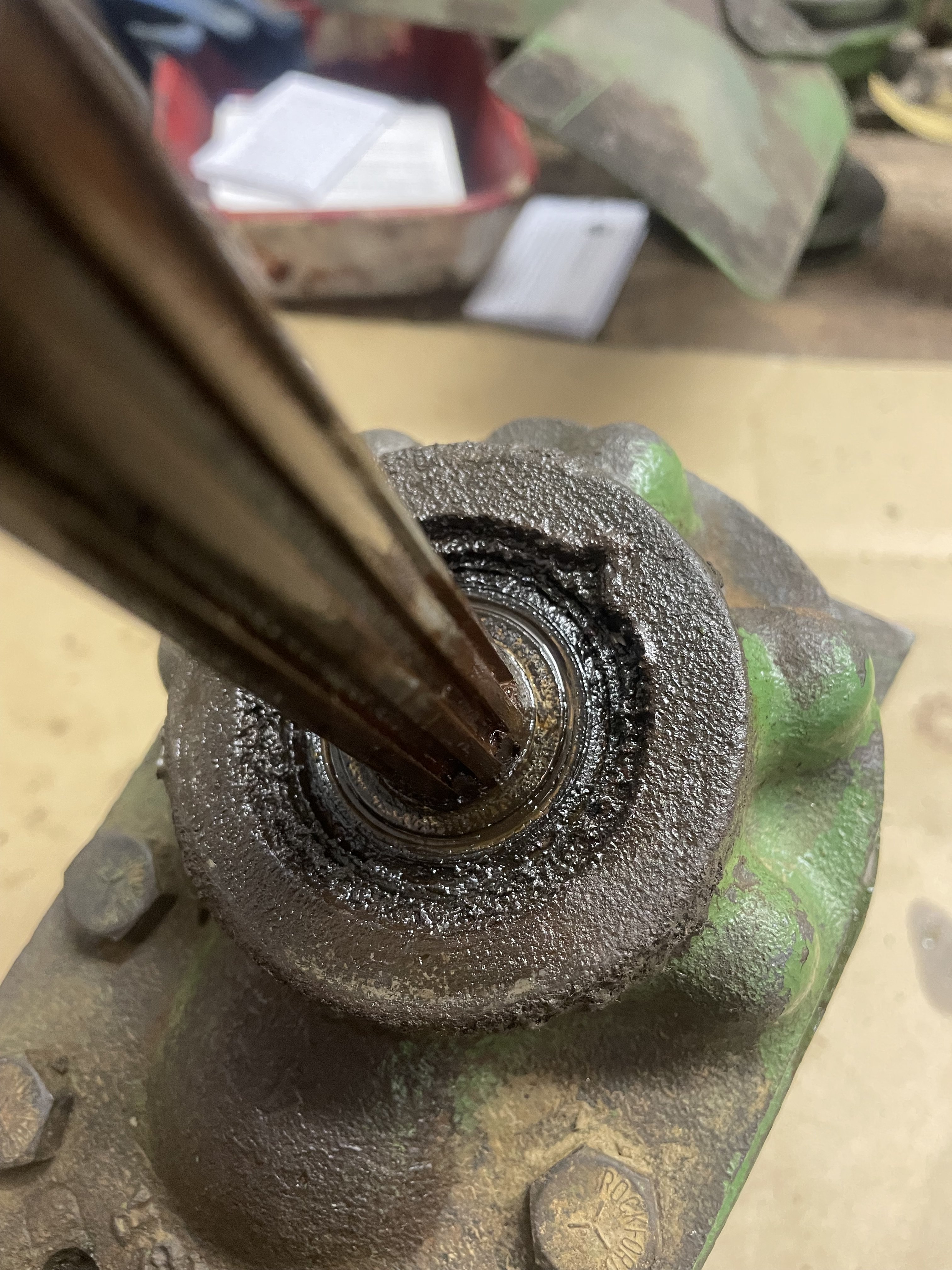

I needed a press so I went ahead and bought a 20 ton from HF. Made a quick tool from a 2” section of 1.25” ID pipe. Fan removal was really easy using this method. Pictures below for anyone getting ready to tackle it themselves. Looking at the seal with the fan off I’m pretty sure it was time…
