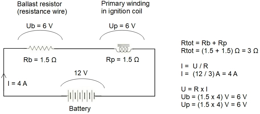

Sorry to disagree Tony,
6 Volt coil worked just fine with a BALLAST resistor added to the circuit to reduce the current flow thru the coil.
That's how my 64 Ford 4000 runs today.
V=I x R
Voltage = Current times Resistance (Voltage measured in Volts, Current measured in Amps, Resistance measured in Ohms)
Ohn's Law - simple electrical theory.
Double the resistance (coil plus a ballast resistor of equal resistance) when you double the voltage yields the same current flow.

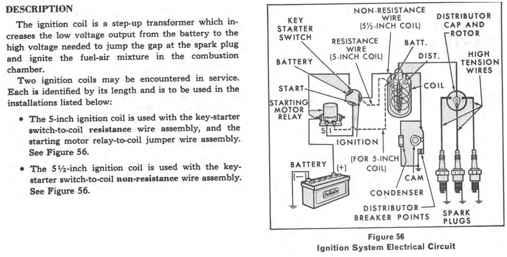

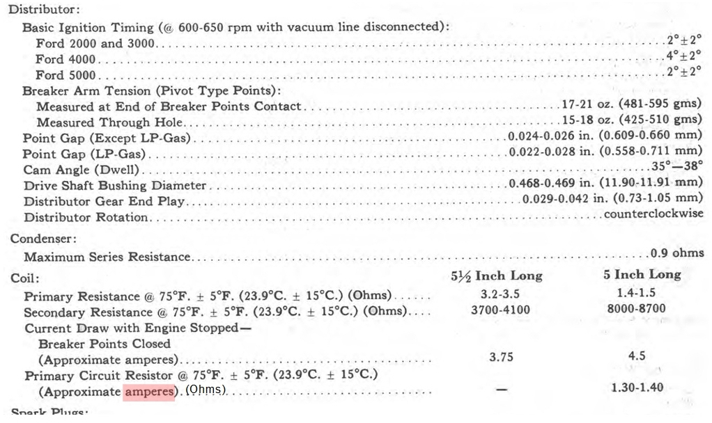

This is from a manual for Ford 1000-series, they all had 12 V systems. There was a mishap regarding the ballast resistor, see correction at red mark.
Anyhow, data for primary resistance and current through breaker points for the 5" coil make 6.3 - 6.8 V across the primary winding. A 6 V coil in a 12 V system from factory.

What the part number ? That doesn’t prove anything ? I forgot to ask how do you saturate a 6 volt coil with 6.3-6.8 volts ? That’s a 12 volt coil
With either an internal resistor or a resistance wire built into the harness which was typical on the three cylinder tractors . This particular debate has nothing to do with the three cylinder tractors because they all came from the factory as 12 volt tractors with 12 volt coils .

Tony, please explain the difference between a 6 volt coil and a coil that says "12 volts external resistor required". The external resistor reduces the voltage at the points and primary to 6 volts, so the coil is essentially the same as a 6 volt coil except for the external markings.

All of the 1965-1975 Ford tractors with gas engines had 12 volt systems and they all used an external resistance wire that is essentially the same as an external ballast resistor, so the voltage at the primary of those coils was 6 volts. The current part number on the NH parts site is D5TE12029AB. The description just says coil and does not specify 6 or 12 volt.

That particular coil is a 1975 3 cylinder tractor 12 volt factory installation coil which does use an external resistor because the original 3 cylinder application the tractor used a resistance wire in the wiring harness . It is NOT a 6 volt only coil like the 8BA 12029 coil that Soaked was talking about .
It is a 12 volt only coil when it was produced by Ford it is not a 6 volt coil and never was from the factory . It is also not the current part . Show the theory behind 3.0 ohms creating 6 volts of resistance . I do not care about Aftermarket manufactured parts that use any random part number on any random chinese piece of crap coil . This debate started because ole Fred wanted to use a dedicated 6 volt only coil on his 12 volt hack conversion . You said it would work as did Soaked then you said all the manufacturers did that when they were converting from 6 volt to 12 volt . I told you a 6 volt ONLY coil will not work on a 12 volt application . So when you prove Ford put 6 volt coils on 12 volt applications I will explain the theory behind it . I do not care about any other manufacturer than Ford , I do not care about anything aftermarket this is about Ford and only Ford .
