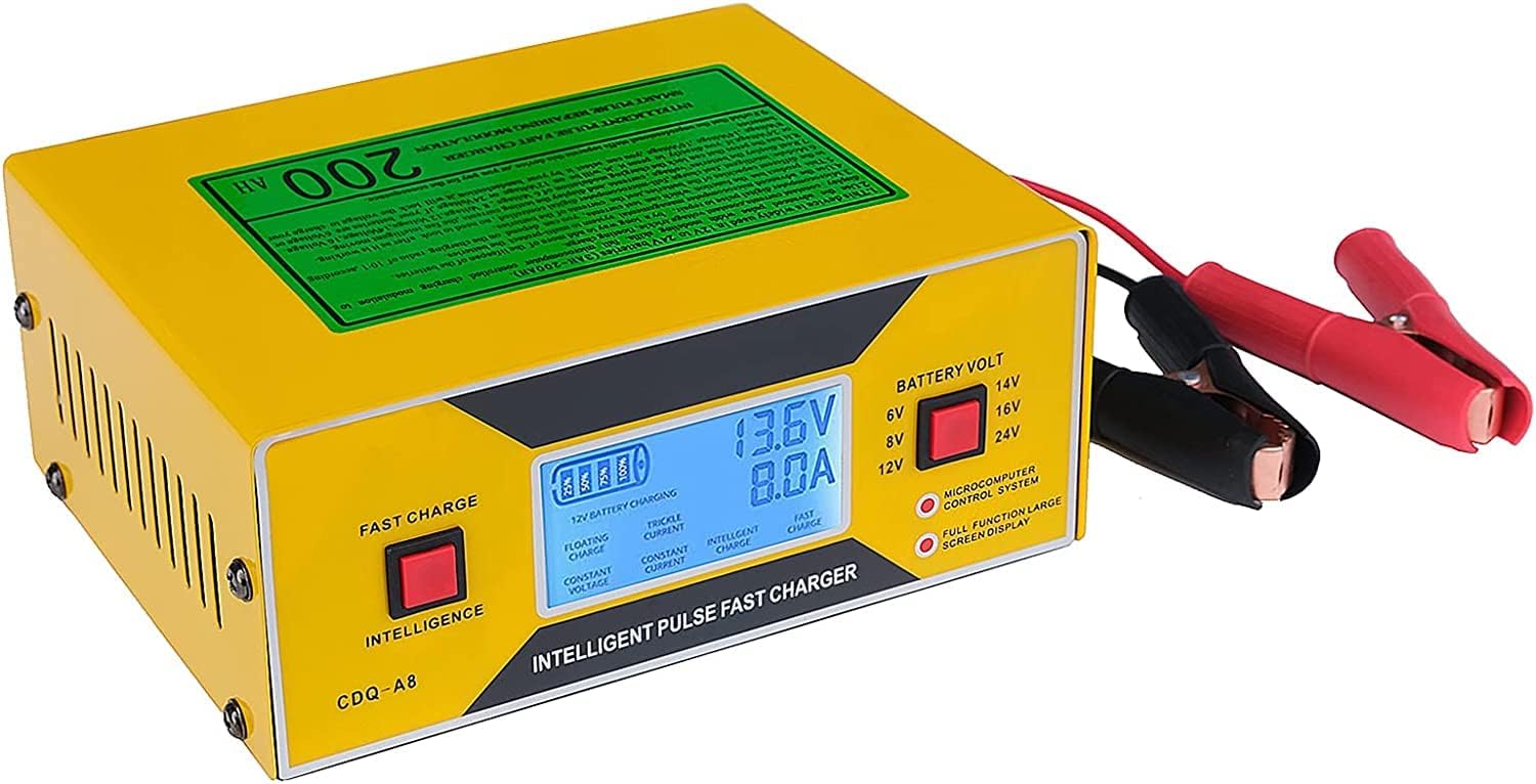

Go to Amazon.
6/8/12/14/24 Volt Battery Charger Automotive, JYEASTZ Smart Car Battery Charger 0-10A, Maintainer and Fully Automatic Charger with Cable Clamps, Suitable...$34View attachment 68923
I have one of these and put it on an 8 volt battery. It works. Problem with this charger is it resets to 12 volts if the power goes off. Be warned bad things will occur if left at 12 volts on an 8 volt battery.
