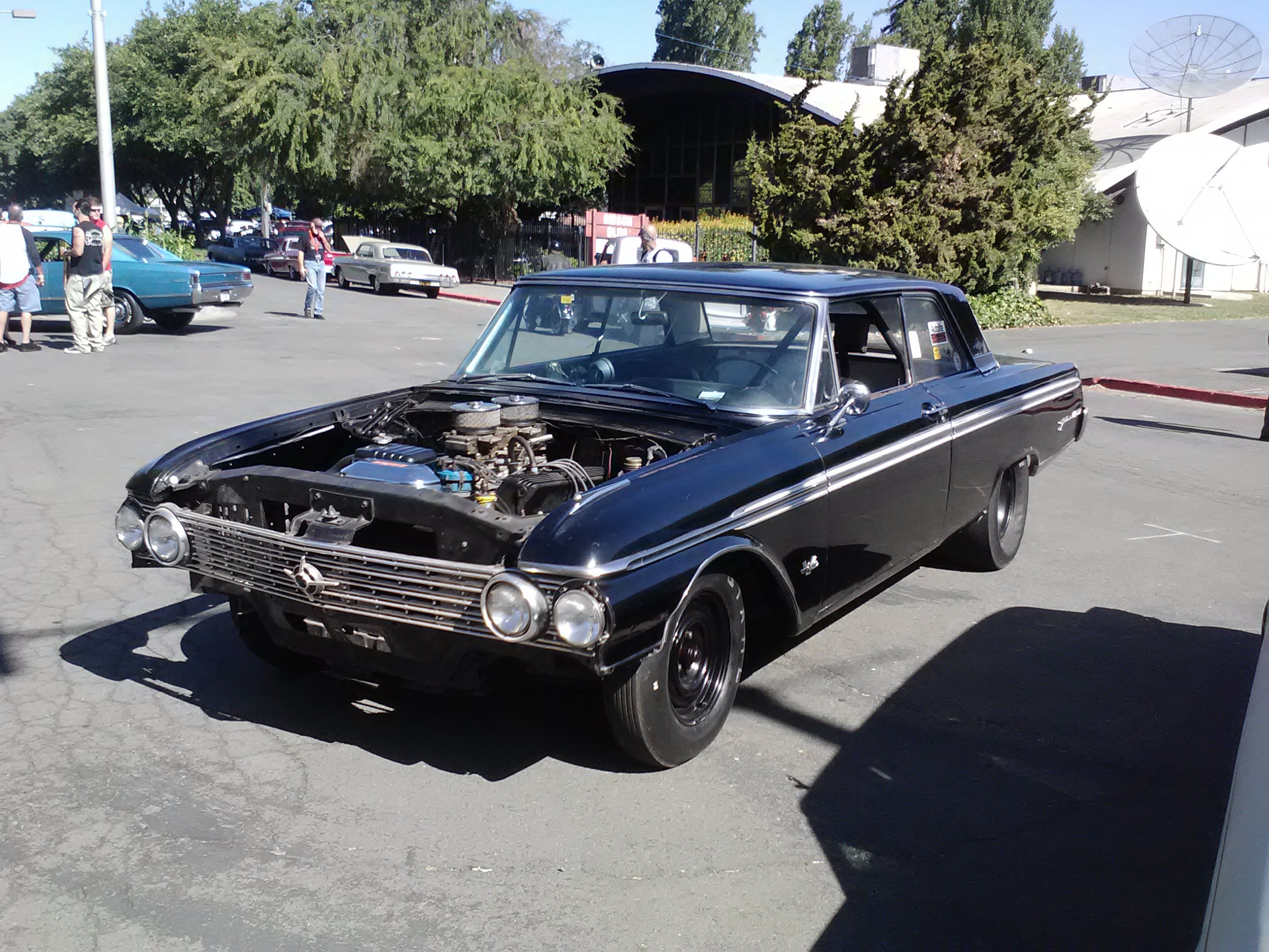

Well, you're off base a bit on a few things lol. I'll be 70 next month, hardly a youngster. And I very rarely do a build with a hydraulic cam- although I'm getting into some large hydraulic rollers. I have 9 427 FE's at present, which are of course light years ahead of most 390's. Just finished a customer's original 428 Cobra Jet with a SCAT stroker crank and rods, .605 lift solid cam, main girdle and partial block fill, and aluminum heads n intake. A half dozen solid rollers up to .785 lift, many solid flats including an original in it's original tube C8AX-D 330/600. I have FE roller rockers from Ford Power Parts, Harland Sharp, a couple sets of Dove HD's, and a set of T&D's that require a cut across the head to install. 4 Milodon gear drives, and a couple sets of Dove-Paquet PIE heads- (you may have to google that one) and a Paquet fabricated tunnel ram intake for twin Dominators. Three adapter plates that adapt a 351C tunnel ram to an FE. Also work at a museum full of original Cobras and GT40s as "The Engine Room Guy", showing a complete GT40MKII setup, a race 427 Cobra engine, race 289 Cobra engine, a couple of Gurney-Weslakes, a 427 SOHC, and a 255 DOHC Ford Indy engine. Spent several years working the engine in a 410 sprint car with a Shaver engine, and played with the World of Outlaws a few times- valve covers came off every week for a look-see at the clearance and checking for broken parts. Putting one of my 427's together right now (454 stroker with a 391 truck crank, welded and offset ground to 3.98, Arias factory lightened pistons, Crower rods) with a nice custom Comp .685 flat solid, ground with maximum taper and nitrided, mated with tool steel lifters. Pretty sure I have your light-speed 390 covered with a large blanket. BTW, one of my '62 Galaxie 500XL's is an original 406-6V car, presently running a 427 with a C6 and 4000 converter, and 5.14 gears with a Summers Brothers spool- kinda froggy. Everyone should try a ride in a big-block car with 5.14s :devilish:

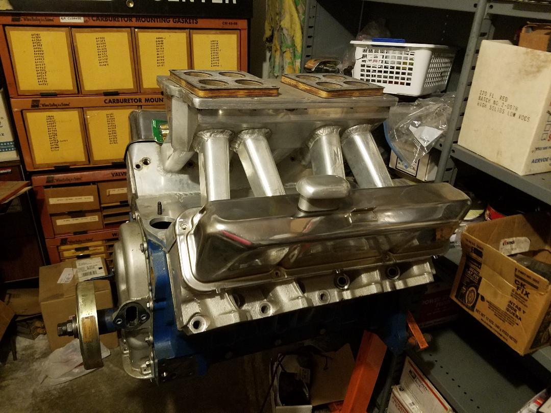

View attachment 146479View attachment 146480
nice . Did ya use a 391 crank??? They just don't drop in it takes a bit of machine work but if you plan on cranking some serious RPM's it's well worth it along with if ya can find them G T 40 rods . while building my 390 we or should i say a friend advised that we have Mc Kay machine X ray the rods even though magnafluxing showed nothing . Four of the 8 new rods had defect's and three more times to get 8 perfect rods. . NOW granted i never thought of a girdle back then , not till i started working on DONOVINS . My 61 Rag top was run hard every weekend from FRIDAY NIGHT THRU SUNDAY till i got drafted . While stationed at Ft. Gordan i supplemented my PFC pay friday and Saturday night . One Good Old BOY asked me while setting up after i cleaned his clock three for three he asked me he said Yankee Do all them thar cars up in Ohio run like this . I told him Nah this is one of the SLOWER ONES God they were fun times . Mine was a tri power . The only thing that was NOT factory was the four speed . No fancy crome valve covers just the brushed aluim factory air cleaner . Best time and speed 118.23 in 11.56 . heads up against a 63 Galix 427 four gear he got me out of the hole and when i hit second it was all over but the shouting got him by two and half cars thru the lights . .a kid in Highschool his daddy bought him a brand new 63 Chevy Impala 409 convertible four speed . out on the Washingtonville road where we had a 1/4 marked off i got him three for three . I ran jahn's 13.5 -1 pistons fly cut for valve clearance 427 med rise heads with bigger intakes a crowler true roller on factory 1.76 adjustable rockers and setting out in the old garage there is a set out there Jardean headers , three holley carbs center was a 500 CFM two bbl with two 450 CFM out boards a holley dual point . intake was port matched exhaust ports were polished and matched heads were C Ced to 72 C C's . Rear end ratios on a 9 inch varied as i had several set up for when i was not playen and traveling i ran a 3.25 when at the strip depending on it maybe what strip it maybe 4.11 . 4.30 or 4.56 and just messing around 3.91 all detroit lockers . It did not take long to swap out a pig . Back then we DOVE to the strips and let things cool down and make changes in the grass / BIG truck ya could put everything in the trunk . supen/ was from a 61 wagon with two extra rear shocks added . traction bars were made from 1 inch cold roll bar and did NOT follow the norm as they were tucked up under going back to the rear frame not ahead you could not see them . I built them in highschool metal shop . the 61 was not just a go straight car as it would handle any road race on any road . I was wild and crazy back then and vary few would ride with me . at that time i was dating a girl two countys away and we set a FEW land speed records between her place and mine over the back roads late at night cutting cross country .
