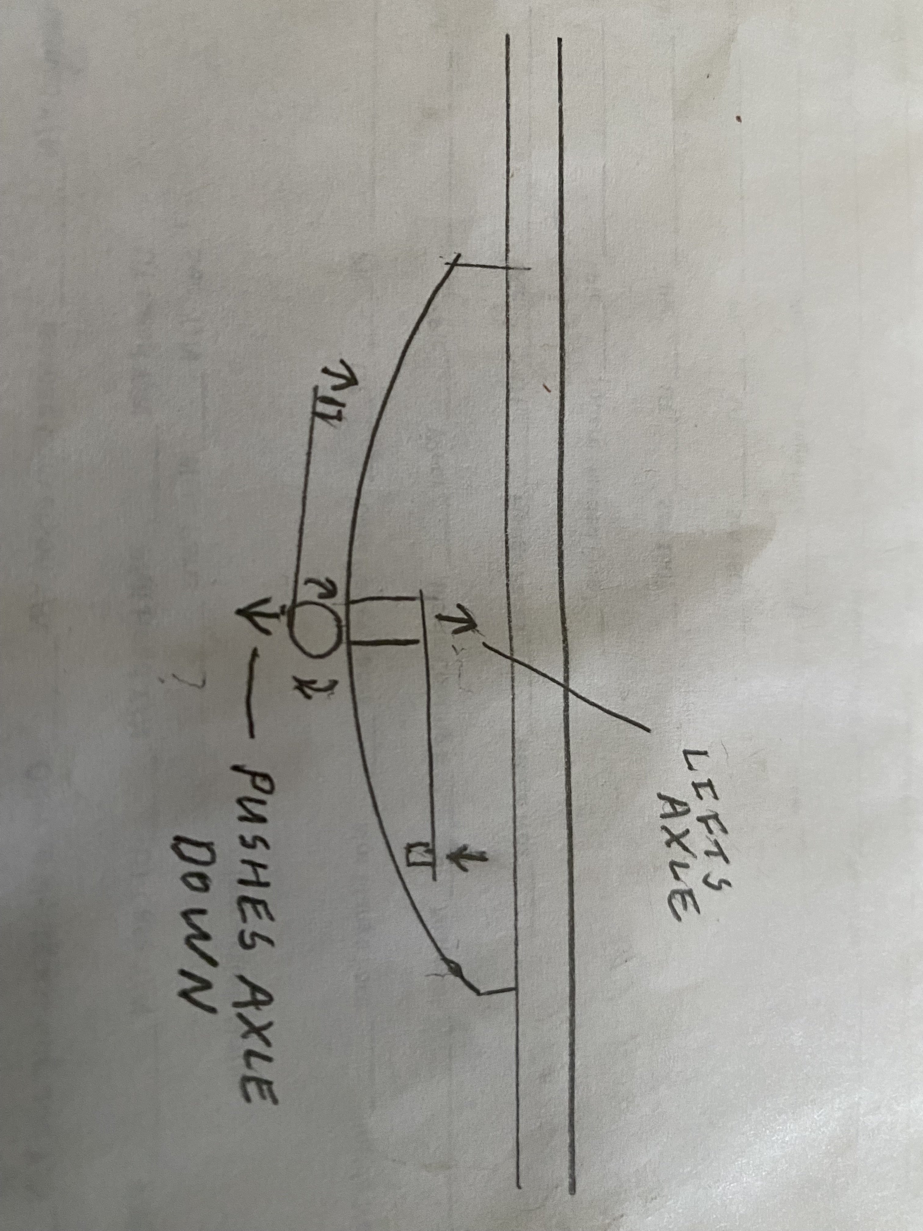

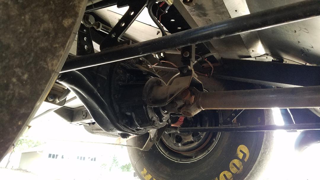

You’re going to have to give me a diagram that shows how that works. When you launch the rear end is twisting the snout of the “pig” as the vet calls it wants to twist up through the floor board. So traction bars mounted under let’s say leaf springs pointing forward also want there forward point to go up. That front end reacts against its anchor point pushing up, which in turn on its reward connection puts downward force or pull on the axle, which transfers to the tires equaling greater down pressure for traction. If you have the bars out the back the rearward point wants to go down and acts on its rear most anchor point pulling down. The reaction on the other forward end attached to the axle wants to pull up, lifting the axle lessening the pressure the tires have for traction. Again, diagrams that disprove these physics are welcome.

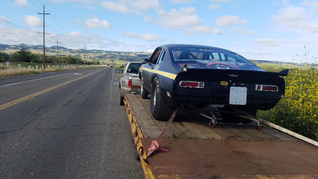

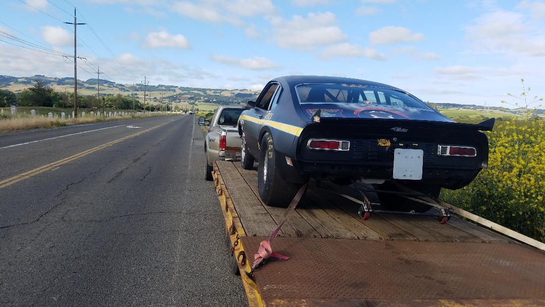

All that long-winded "physics" stuff, and you still missed that I put the bars behind the axle, but ON TOP of the springs, so the rotational force PUSHES DOWN, no pulling down, creating the same effect as the bars in front pushing up. I don't have to draw you any pictures, you just need to think about it with an open mind. BTW, this one has an Alston chassis that will certify to 7.50, with a 4-link suspension that provides a large amount of adjustment. I have two of those setups, as well as a ladder bar setup (first picture) that is a little simpler but still works pretty well

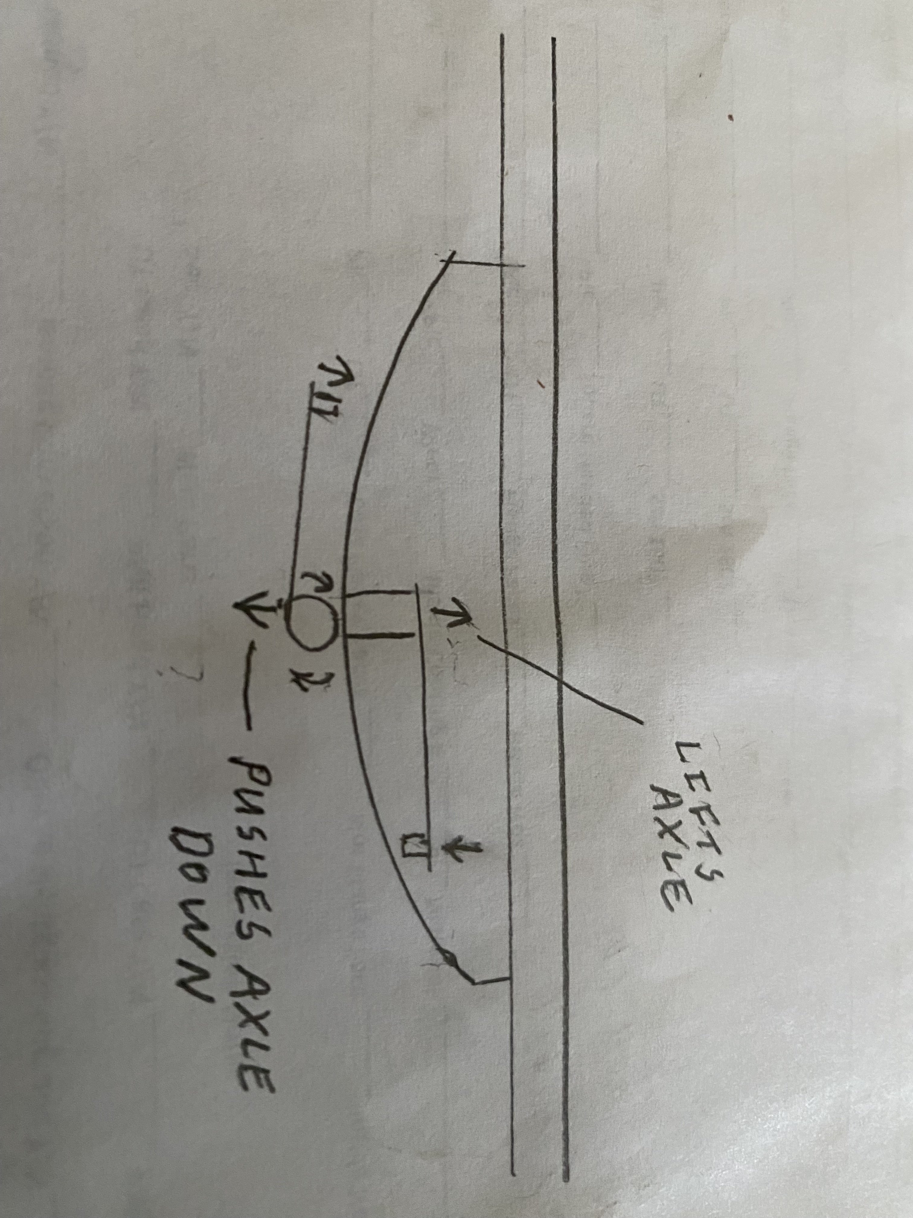

I missed “zero” what I said still applies, point being physics can’t be changed. In your case the 4 link suspension setup changes a LOT of how the rear axle reacts in its connection to the chassis. In the case of the vet’s “hidden” traction bars on his leaf spring suspended rear axle everything I said applies. Instead of the traction bars adding traction from the initial twist and launch of the car off the line relying on weight transfer off the front wheel onto the rear wheels his idea was shooting him in the foot. I ended up being the one supplying the drawing.(edit oriented to read the wording the front or forward side of the chassis is to the left) Take a look physics don’t lie. So as unbelievable as it may be the vet was just a high school kid trying things he thought were correct, but in the end learning from his mistakes like we all did. Luckily he didn’t mount them properly or he likely would have beat Neil to the moon! (for some reason the emoji’s aren’t working for me and boy does this reply need some!) sorry the drawing is sideways.

Actually, it works, if you put the bars on top instead of underneath- think about it. I did that with an old set of slapper bars on my old F250 Highboy when I was pulling it with a 427 that would twist the frame up pretty good. Class I was running wasn't supposed to have suspension mods, and they were on top of the springs out of sight. Vet, we could have some fun swapping stories- can you guess what this road's fictional name was in a pretty famous movie? There used to be Start/ Finish lines painted on it. Had to stop and honor it with the Maverick

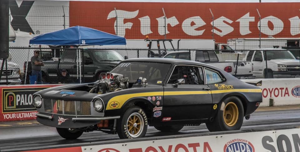

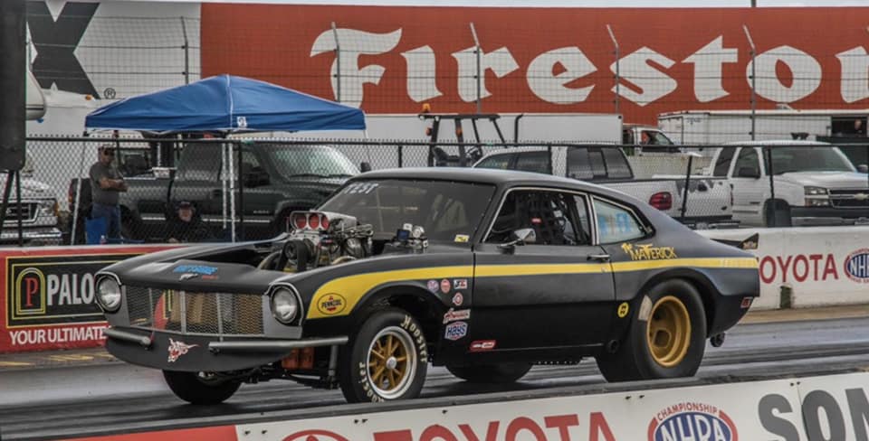

. That's the Maverick I had for a while, very stout build with ladder bars, had a blown alcohol Keith Black engine in it, Car was built by an old Top Fuel builder

I would draw ya BLUE PRINT of how i did if i knew how to post . And yea i am suffering from cabin Fever and super bad night of flash back from 68.
Well in all honesty you owe me nothing. When I come across things that “poke my button” I often make to much out of it. That was 60 plus years ago and probably doesn’t mean beans today. I might question in my mind their effectiveness but if you say “they worked for you” that is good enough.
If you really want to post a “blue print” the “Attach files” button at the lower left lets you upload (post) a file or document from any storage folder in your computer. Or what I did was drew the diagram on paper, took a photo of it with my phone. Accessed YT on my phone and using the Attach files button posted the photo of the diagram. On a phone you can even choose to take a photo when you click the Attach files button, so it could be done that way.
