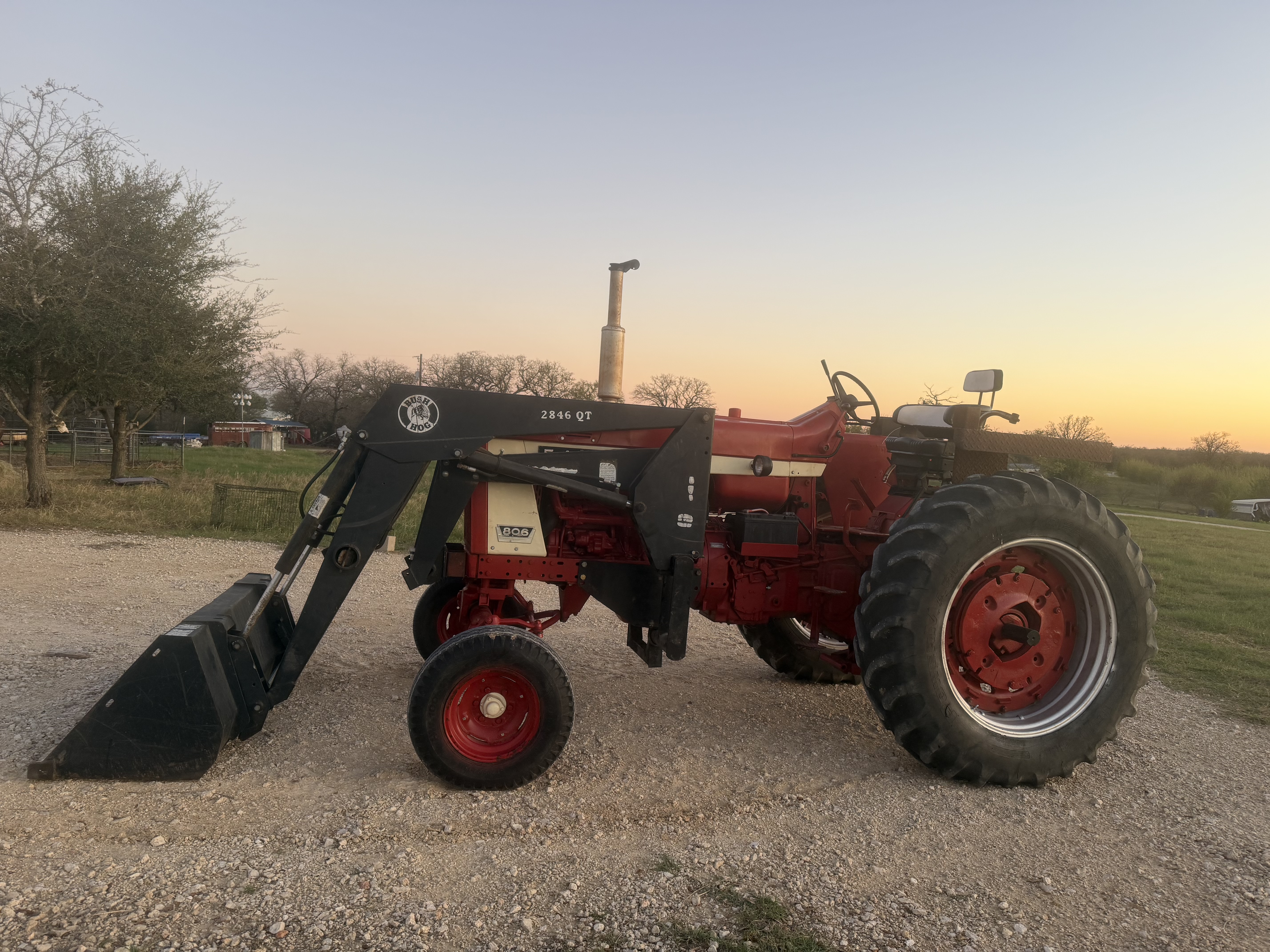

all right, so just had more time to go through this Tractor and there is a pretty good size puddle of hydraulic fluid underneath what looks like a valve maybe for the steering it’s behind the battery if you look from one side or kind of under the starter if you look from the other seller says it’s just a gasket. Is there an expensive problem hiding here?

You might have a leaky line to the priority vale for the steering or one of the seals. Possible to get oil down from the hand pump too. Do you have the loader valves under the tank? Also another place to check.

Another thing on the Tractor surprise me, but I’m not familiar with old international. The lift arms go up and down well but if you let go of the control lever, the lever drops down immediately. You can move a limiting knob to stop it not sure if this is how it’s supposed to work or if there’s an issue with this tractors lift arm control lever. I’m used to that limiting knob being what controls how high up you could go like on an Oliver..
Just tighten up the friction disc on the offending lever.
And what about the other lover that says light on one side and heavy on the other? It was stiff, but since I had no idea what it did I didn’t really wanna mess with it.
That's your draft control lever. It's mainly used when plowing with a semi-mount plow to control your depth. You won't hurt it by messing with it.

Thanks all for the good advice. Got the tractor home last week but it took a few days to get the loader bracket adapted and just started using yesterday. Runs great, but After using all day had a few things turn up.
First, Hydraulic levers that control the remotes work but get stuck. You can feel them kind of snap forward or back feels like throw needs to be adjusted.
Second
It sometimes wouldn’t go into reverse or low.
Pushed in clutch, shift into R or L on Shifter. Let clutch out. Tractor Doesn’t move. I can move up to high or neutral and then come back and it wil work after a couple tries. See some adjustments on linkage behind plate at bottom of console. any advice on how to fix this?

The hydraulic valves can be adjusted at the rear of the tractor. On the back of the valves under the seat there is small pop out plug. With the plug removed spray you favorite lube in there and you will see a screw driver slot on the end of the valve. Righty, tighty. Lefty, loosey. This adjusts how tight you want your valve to work. Shifting sounds like you need adjusting. Also remove the tin cover at the bottom of the steering column and you will see your adjusting link. At the front off this link where it connects with the vertical shaft there is a roll pin that wears and gets really sloppy. Have to drill the hole larger for a roll pin to fit tight
