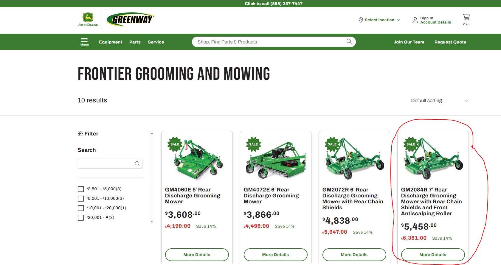

According to the interwebz, Befco mowers are sold at John Deere dealerships under the "Frontier" brand name.
Looks like the Frontier model number would be GM2084R

The research I saw was that Woods makes the Frontier mowers for John Deere. I found a used Frontier 84" about 3 hours from my house.
Could be different OEM (Original Equiment Manufacturers) for different models. You'll have to look at whatever model you're thinking about and judge for yourself as to whether it's heavy enough for your standards. Unfortunately, we can't just rely on a brand or a name anymore. There is variability of quality even within the same brand name. I just know that the model circled in the picture that I attached is a dead ringer for our Befco 5' mower... just different width... and green paint.
Definitely looks like a stout unit.
My only knock with the Befco is... pneumatic tires. If you get one, or another one with similar sized pneumatic tires... just put tubes in them and fill them with enough slime to plug a culvert... wipe your hands and walk away.
