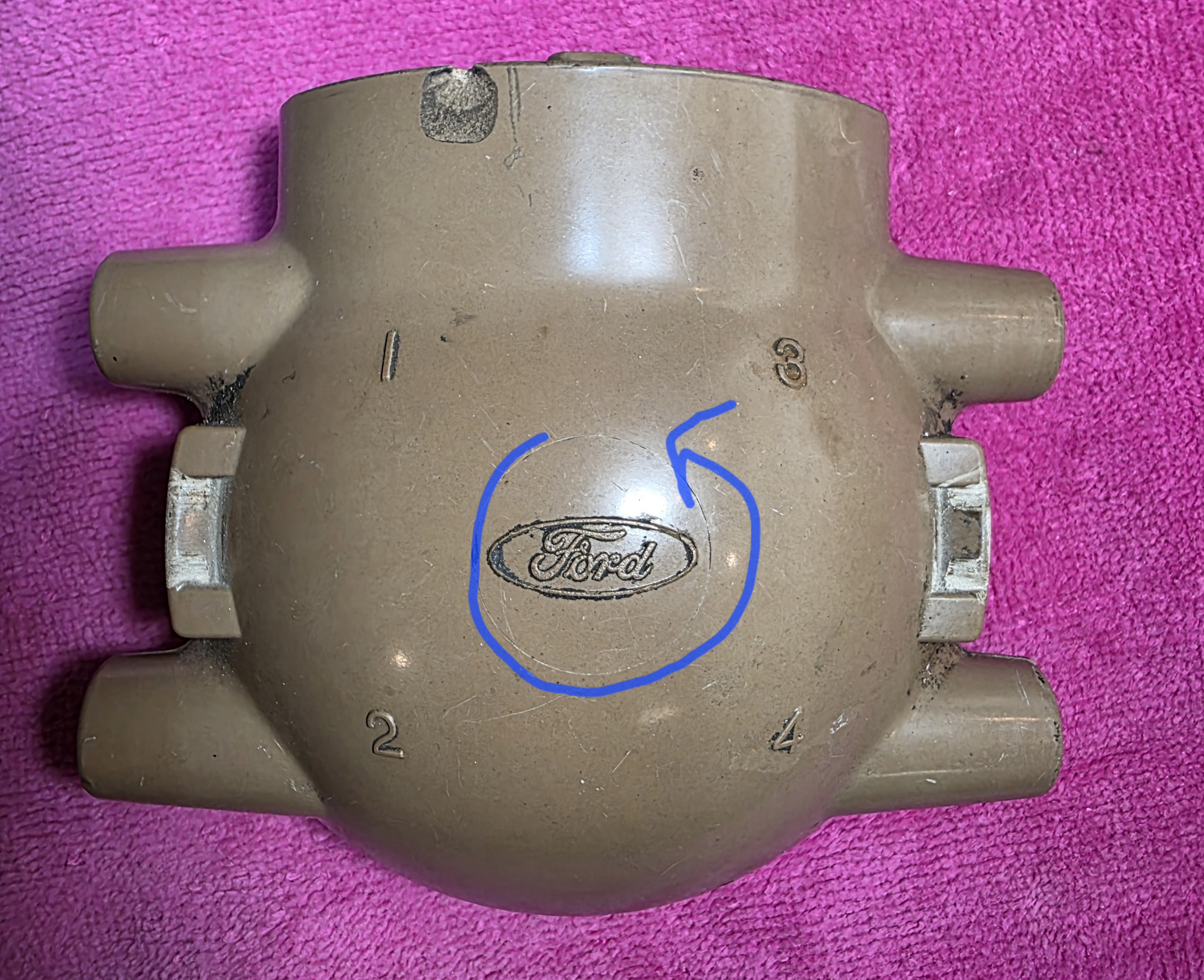

I swapped 3 and 4 and it seemed to make a difference until the engine got hot, then back to the same nonsense!
plugs look a bit wet, so not firing well. Maybe the battery is getting a bit low???
I've removed the distributer and re-adjusted the points, the gap was WAY too big! The new points that I bought didn't close up enough so I had to file the slots to get the 0015 gap.

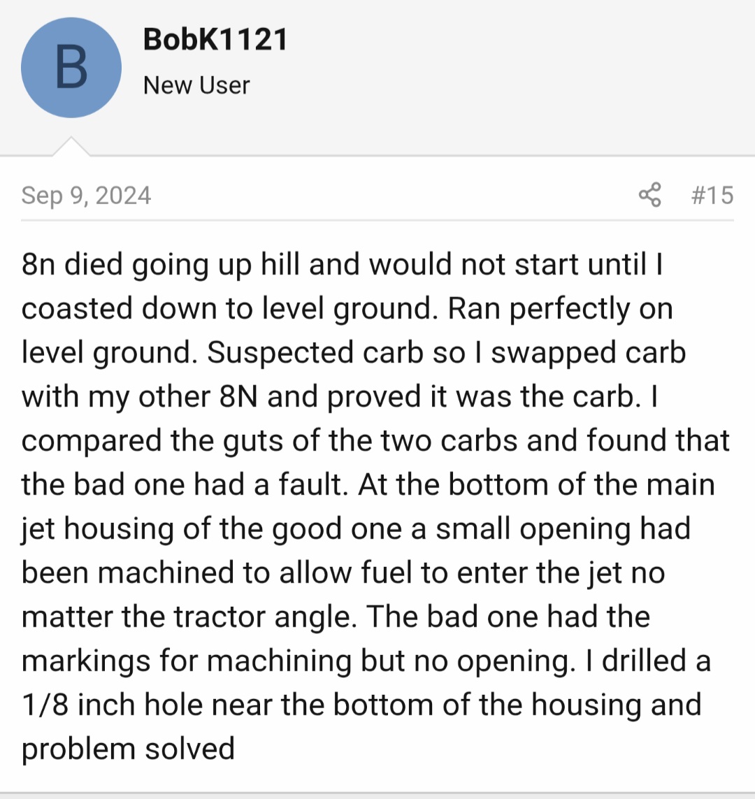

You say you replaced the carb. That would be my primary concern. There are oodles of aftermarket carbs available for N's, and very (very, very) few are any good. Especially the Amazon type ones that are less than $100. There are loads of threads on the N sub-forum below about the problems with these aftermarket carbs. Often they're ported wrong, very often they're missing some of the idle circuit passages, and almoat always the main needle is machined at a ridiculously blunt angle that's impossible to set to meter properly. They cause the tractors to run terribly.
As a general rule, you're far better off to rebuild the original carb. It will be far better quality and better and metering the fuel. And those single barrel M/S carbs are ridiculously simple and easy to rebuild. Great starter carbs for someone new to rebuilding them.
When you first posted this I attempted to search out the threads that reported on the problems with aftermarket carbs particularly not operating on an incline. Essentially a passage is not drilled through to allow the main needle to pull fuel out of the bottom on the bowl. The fuel has to come into the main jet from about half way up on the bowl sidewall on the front of the carb. When you head up an incline the fuel level in the front of the carb drops down below the inlet that is to high an and it goes kerput. If I have time later I try to find the threads. Pull the carb bowl off and post some pictures of the inside of it.
Hi Red, this post may have been the first
And this post has more details
