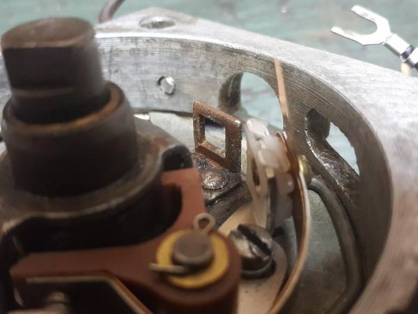

First Post: I have an 8N with a front mount distributor. After replacing the coil, points, and condenser I still did not have spark. Upon testing I can see that the brass screw is grounding out intermittently. Another post from "Bruce (VA)" suggests the following: "If you need to replace the insulator, use a
.250 x 3/8 nylon square nylon anchor nut available at most big box home stores." My question is How do you do this? Do I drill our the old threads and place the new nut behind the original?

Welcome to TY. I have found small plastic/fiber washers that fit the stud and the hole in the side, centering the stud in the hole. then use a different fiber washer that holds the smaller one where it belongs. A good hardware store will have them. Nylon or fiber will work. Jim

In regard to your insulator problem, you might find a good used breaker plate, or take a chance on the fitment of a new one, (likely from The Land of Almost Right).
https://www.yesterdaystractors.com/Ford-2N_Distributor-Breaker-Plate_9N12150.html
If you repair yours, it must be done so the flexible copper strip and the condenser lead are held tight, making good electrical contact while being insulated from the steel "tab" the insulator fits in. (But you already knew that, LOL!
Thank you both! I drilled out the previous threads and found the square hole through the tab. I also sanded down a nylon nut to fit that hole so with a nylon washer on the other side I should be good. As for the amperage going to the coil I should be able to check that with my son's tester. Thanks!!
