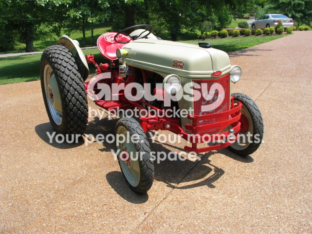

Just put two new ones on this 8N. The rims are 16x4.50 from Just 8n's - about $120 delivered. The tires are tri-rib 5.50 x 16's - $99 with tubes delivered from Tucker Tire. I'm quite pleased - wouldn't want anything wider even if they would fit without problems. FWIW I still have the two OEM rims in pretty good shape if that interests you - the tires are shot.

Sounds like you made up your mind to go with the 16s. I use mine around the yard and also had issues with the tri ribs digging in so I with with turf tires on the original rims. Worked out nice.
Looks nice! Unfortunately, my original rims are shot due to rust, so that's not an option. Having trouble finding 'economical' turf-type tires for the 16" rims. Best so far has been a 5-rib implement tire and only found a 16x600 in it, not a 16x550. (Was trying to stay with a 550.) Did find a 3-rib 16x550 but am trying to get away from the 3-rib. Looks like you went with motorcycle tires. I'm familiar with M/C tires because I've got a couple of bikes and they're usually in the $120+ range, which is a bit more than I wanted to spend on these things. So, I may add some green slime to my leaking tubes and keep looking for the 'perfect' deal!
