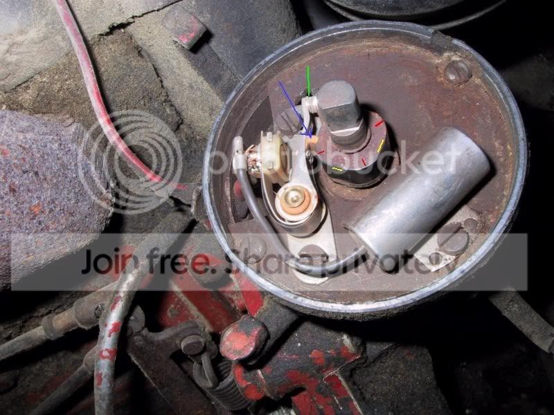

Okay. I have replaced the condenser as suggested by JMOR but there is still no spark! So the only thing left has to be the insulator and the copper strip shorting out, right? We have established that the coil is good, the battery is charged, the cap is new, the points are gaped correctly and there is no burning or pitting present. At this point, it has to be the insulator and copper strip or the wires. I guess either is possible.....
I am attaching some pics of the insulator and cooper wire, rotor button, and cap.
do you have a meter or test light to check the system for shorts or breaks? You can use a light or continuity or volts or ohms to check if it's grounding out with the points open.
Watch for it grounding out on that lug going through the distributor body, there's also a fiber (insulating) washer between the points rocker and the distributor plate IIRC

Hmmmm I am not seeing this washer. And yes I have a light I have been testing with. Something in the distributor is grounding out
(quoted from post at 14:55:18 03/23/14) Hmmmm I am not seeing this washer. And yes I have a light I have been testing with. Something in the distributor is grounding out
t is the white plastic part in my picture.
Did you just run the wire from the coil to the distributor, straight through the existing insulator and connected to where the copper strip normally connects?

The washer is part # 44713-S.
That's on page 159 of the Master Parts catalog.

Okay thanks! I just tried JMORS temporary fix and I am still not getting fire to the plugs or out of the secondary wire from the coil. About the only other thing at this point is plug wires????

BS aside. CODI, no new wires or anything just yet, OK. Your test light has a wire with a clip and a pointed awl like end on the body, right? With my "temporary" fix wire running between coil and points (same connection point as condenser) and no feed-thru terminal, connect the test light clip to the distributor base, bare metal. Next, be sure points are open. Turn on ign key. Touch probe point to the coil terminal opposite the wire going to the coil. It should light. If it doesn't light, stop & do nothing further without telling me. If it does light, then move probe to the coil terminal going to distributor (my temporary wire) and with key still on, engage starter & see if light blinks on/off/on/etc. Let me know.

Okay..... I the light came on for both terminals and is coming on across points like it should. I tried sticking the probe in one of the cap terminals for the spark plug wires and got nothing. The cap and the rotor are brand new. What next?
" I tried sticking the probe in one of the cap terminals for the spark plug wires and got nothing. "
Why are you doing that? JMOR told you:
" Don't use a light on the secondary......"

"The secondary wire carries spark voltage to the plugs when the points open. It goes from the center of the coil to the center of the distributor cap. There is nothing you can measure there. "
We are still having a failure to communicate.
Put it all back together, charge the battery & check for spark with a spark plug or plug checker at the plugs with the key on while the engine is cranking over.
You will never see the light come on at the distributor cap because there is no continuity between the rotor & cap.

Okay. That makes sense. I did try putting it all back together and I got no spark at the plugs.

Ahhh yes..... No blink just solid.

ell, that is a darned critical piece of the puzzle. Omission is bad! Leads in wrong directions. What this means is that even though the points may be physically closing, that are not making electrical contact. Thus no coil current & no spark. Clean point contacts, be sure gap is 0.025 inch and repeat. Actually, first, repeat the probing where this time you short across the open points with a screwdriver while observing for blinking test lamp.
These are new points that I just put in too! I checked the gap over and over but I guess I still got it wrong. What do you usually use to clean your points?

he way I do it might get you electrocuted, so I do not recommend it for others.
Let the points close firmly on a piece of rough paper such as old brown grocery bag & pull it thru. Repeat a few times.

Jmor, good writeup for how to test for the points opening or closing. I don't think he's getting the point that the light should go off if he opens the points.
CODI, if the test light doesn't turn off if you open the points it means it's grounding out on something other than the closed points. If it's not the stud sticking through the side of the distributor then it might be how you stacked the washers & insulators on that piece of spring steel that pulls the points closed. Also, if you've added or doctored any of the washers in there to where they come in contact with the moving arm of the points or that spring steel you could be grounding out there.
It is running! I ran a piece of brown paper bag through the points this morning. When I tested for spark there was a bright blue spark at the plugs and boom she fired right up!

ell, it took awhile & a lot of baby steps to get there, but I am happy for you that you got it up & running! :D
