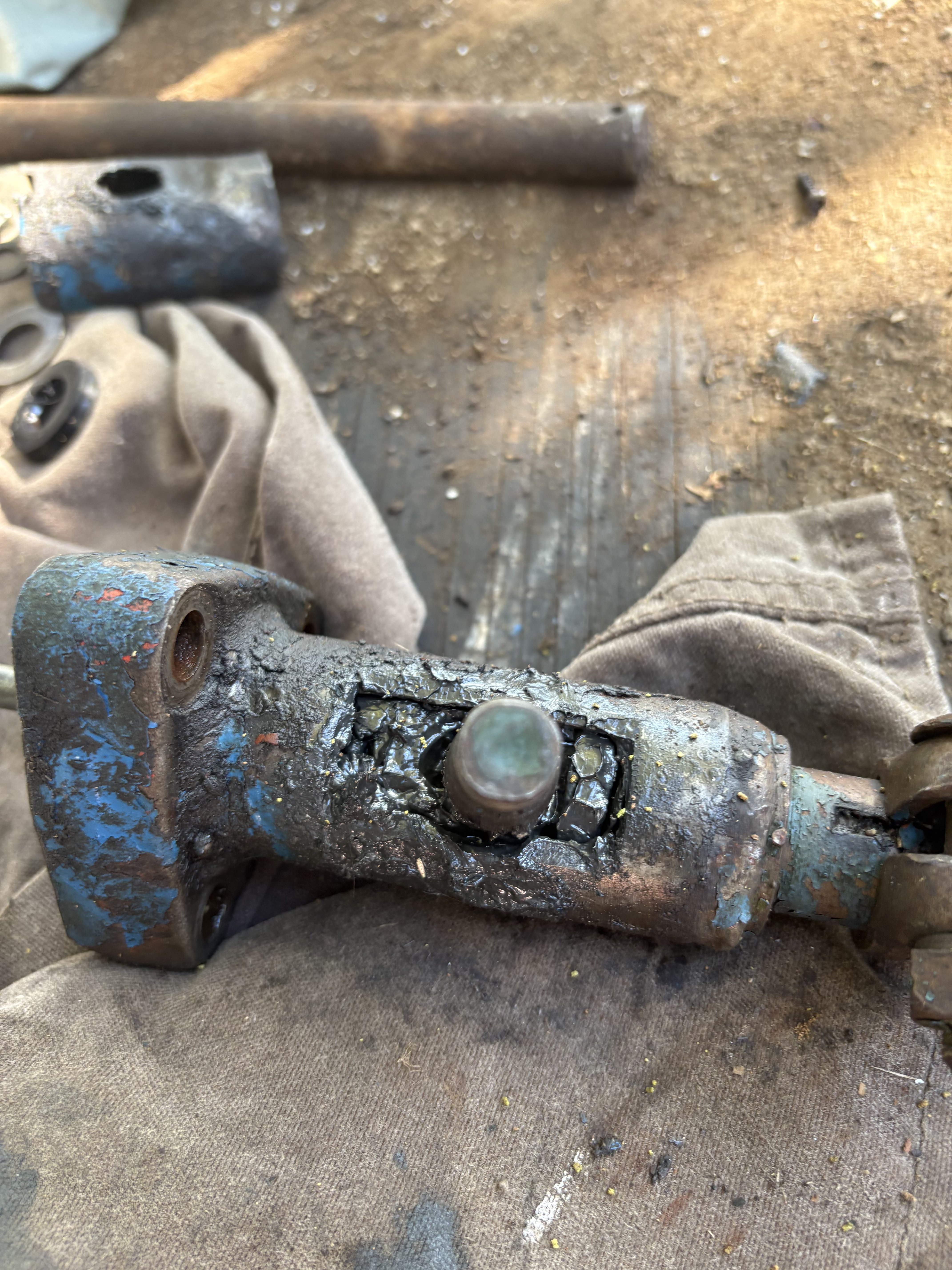

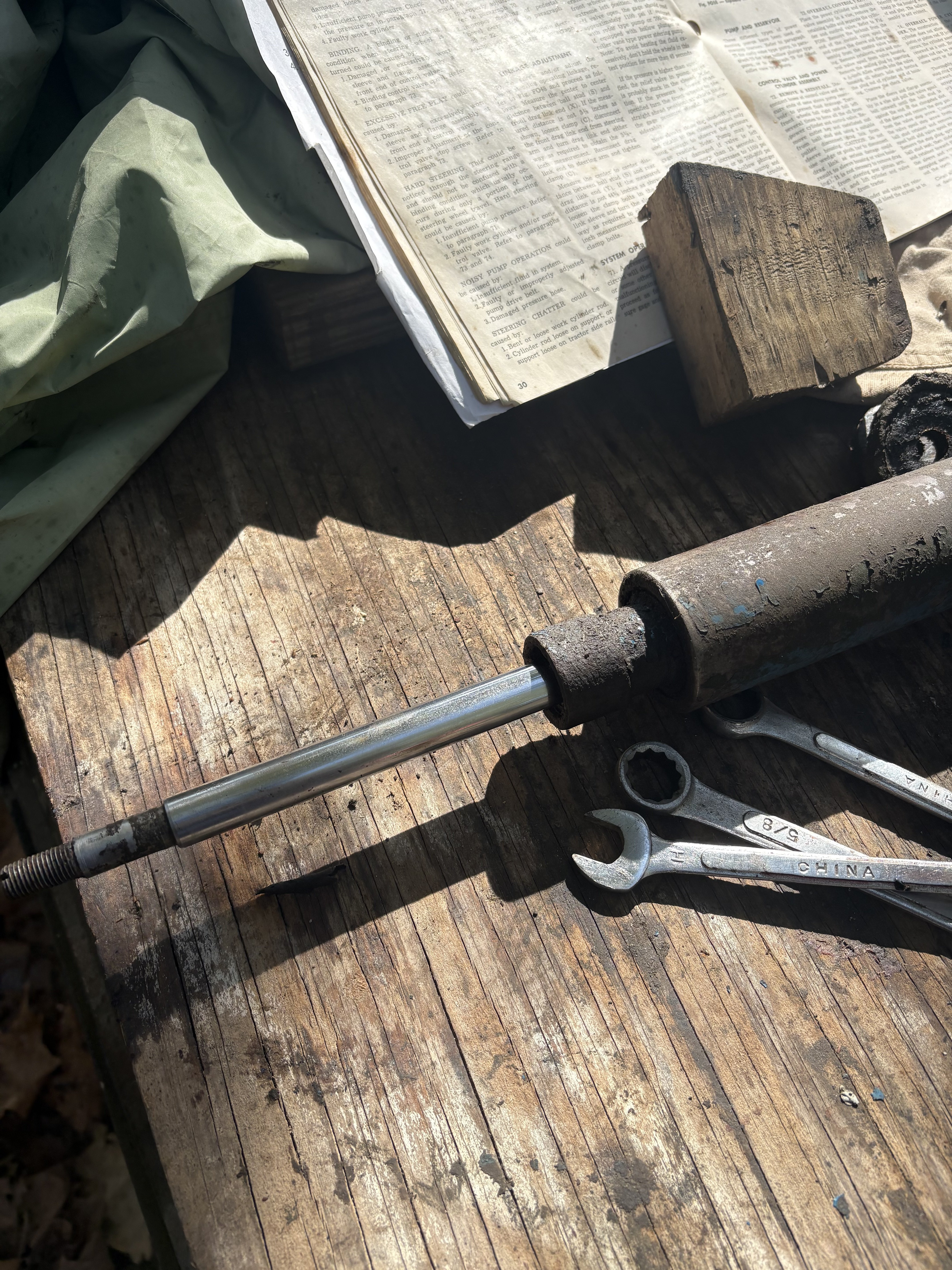

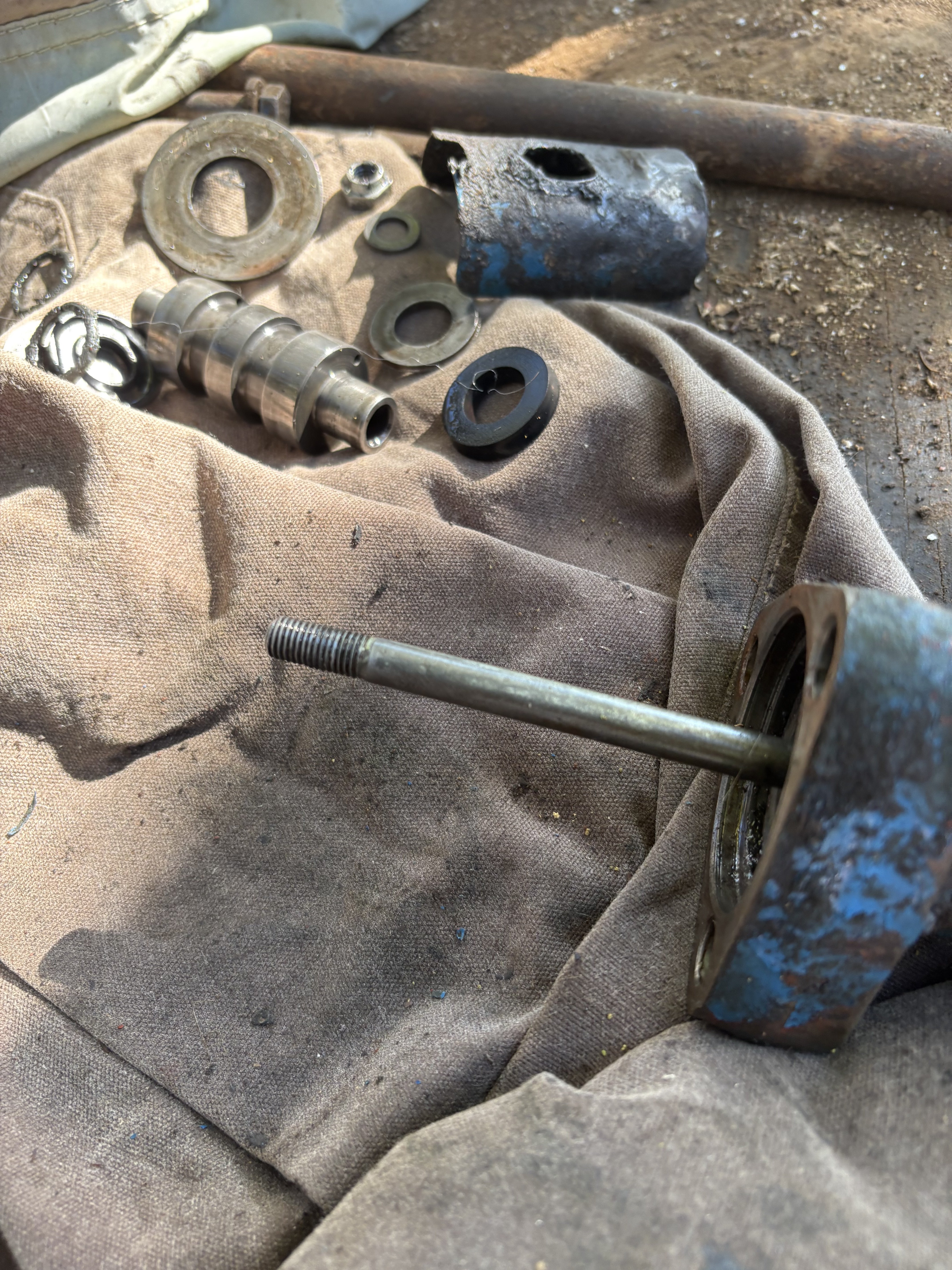

I took some more pictures. I don’t know if this will tell you anything though.
You can jack the front up and it will turn fine but when wheels are on ground one way is easy and one is hard.Is it the steering wheel that turns hard or the wheels?

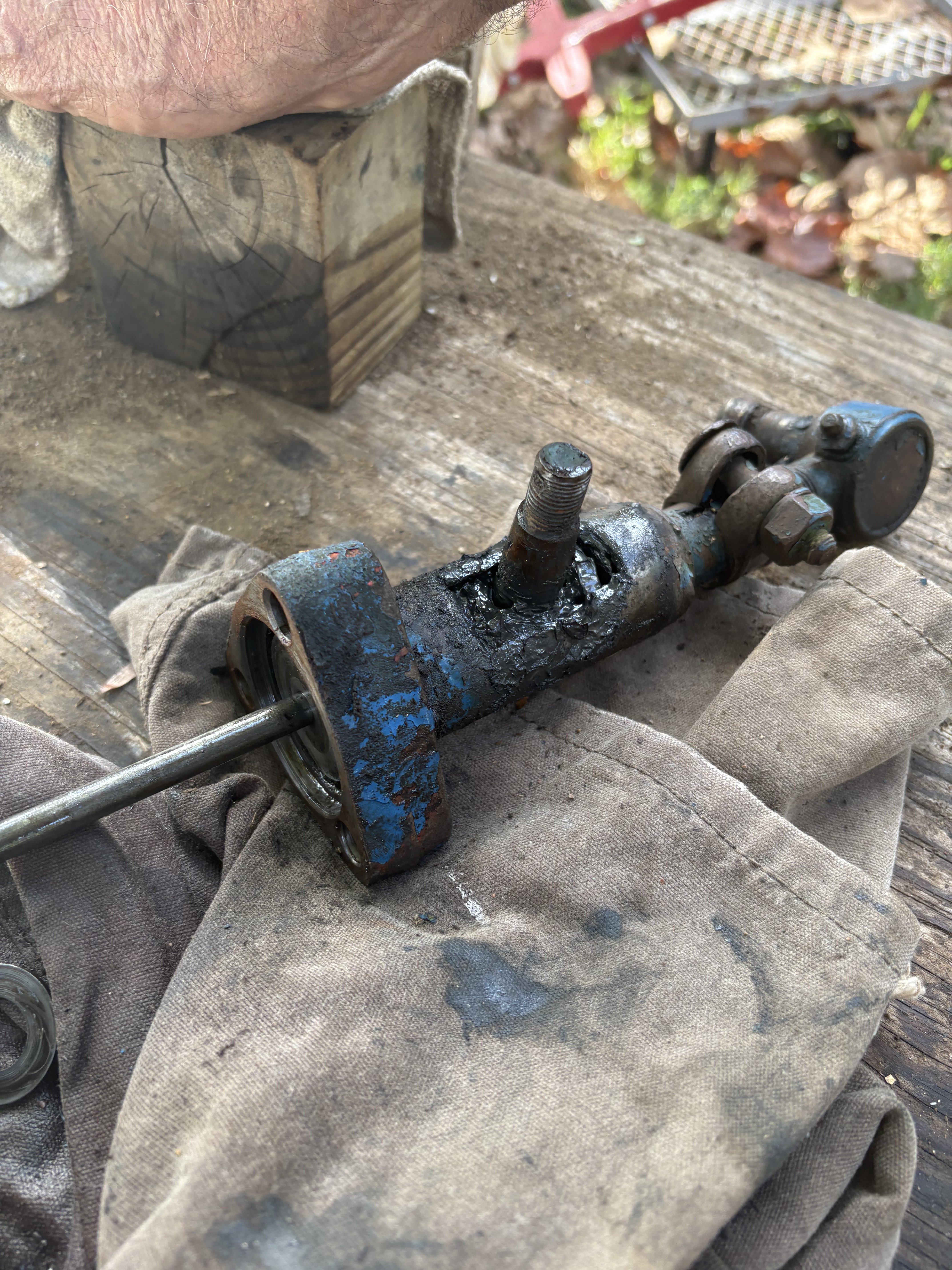

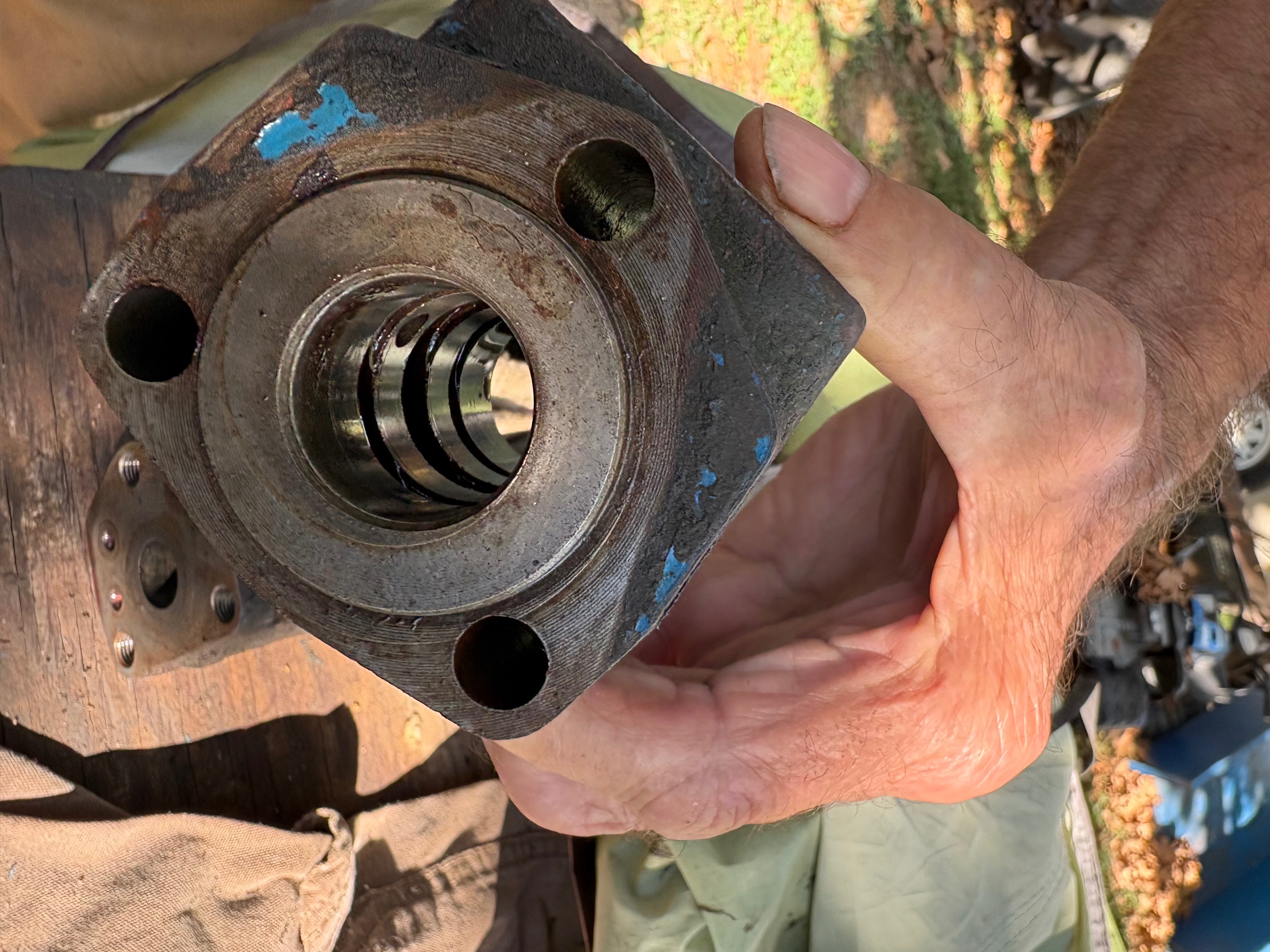

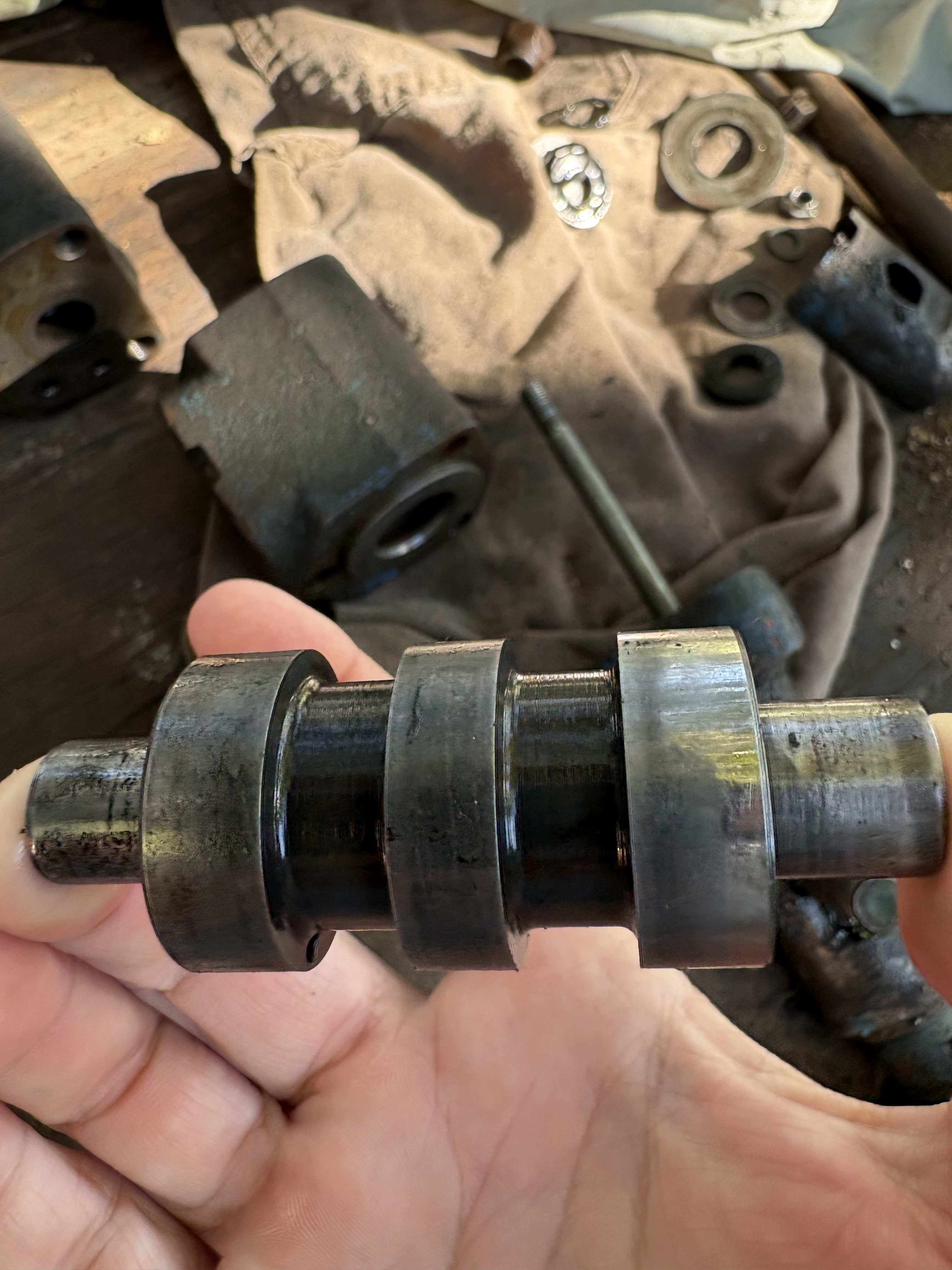

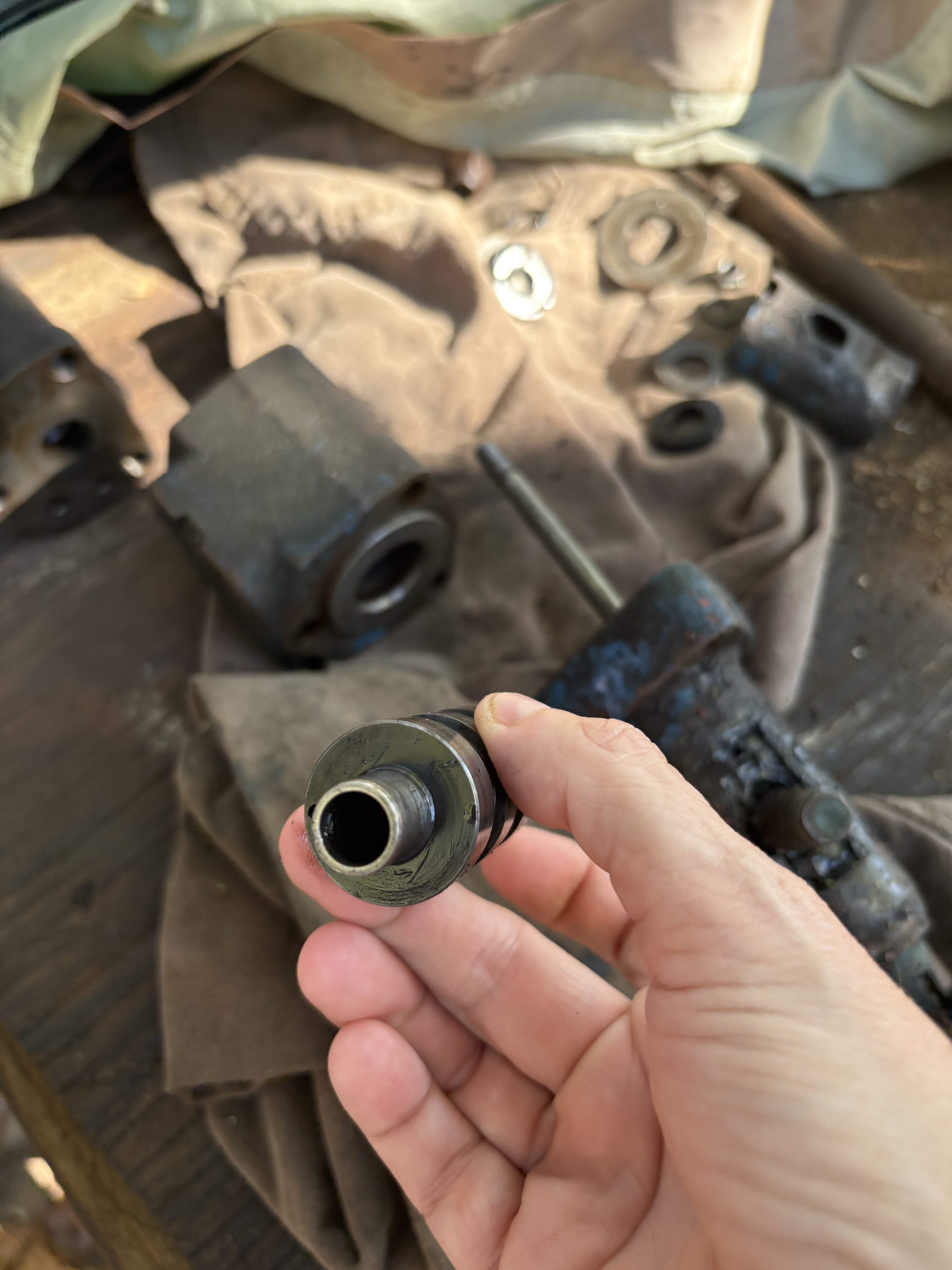

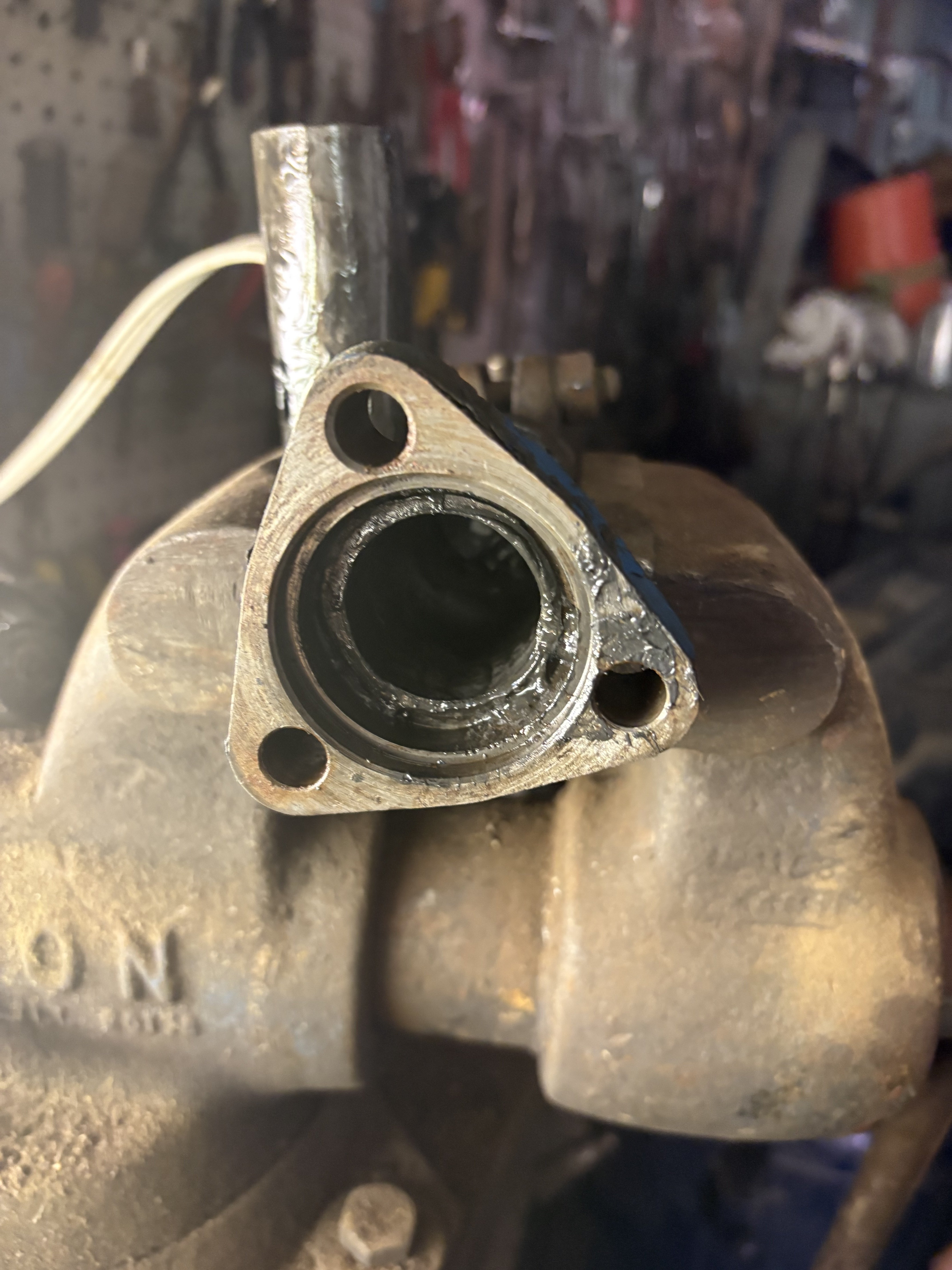

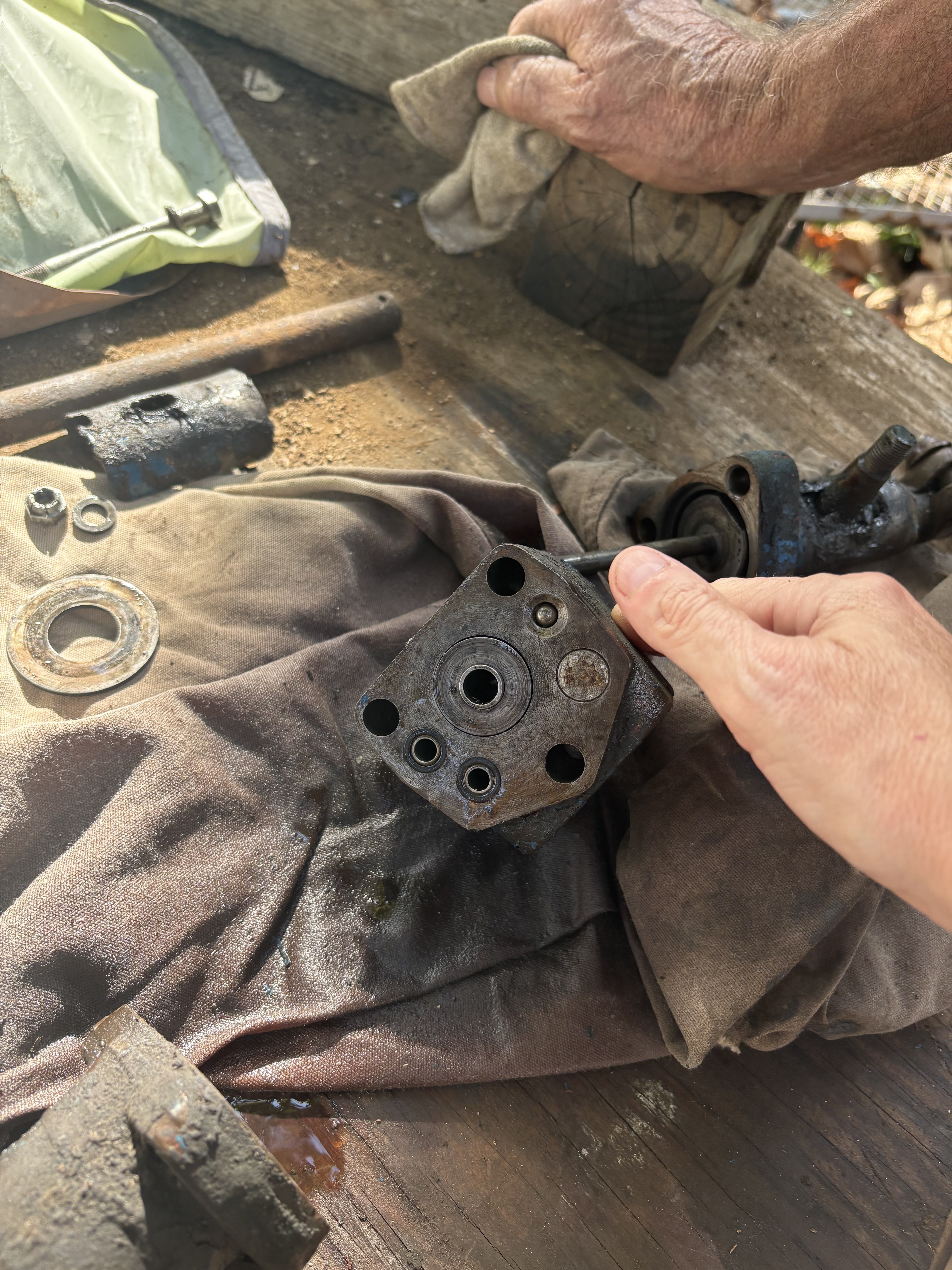

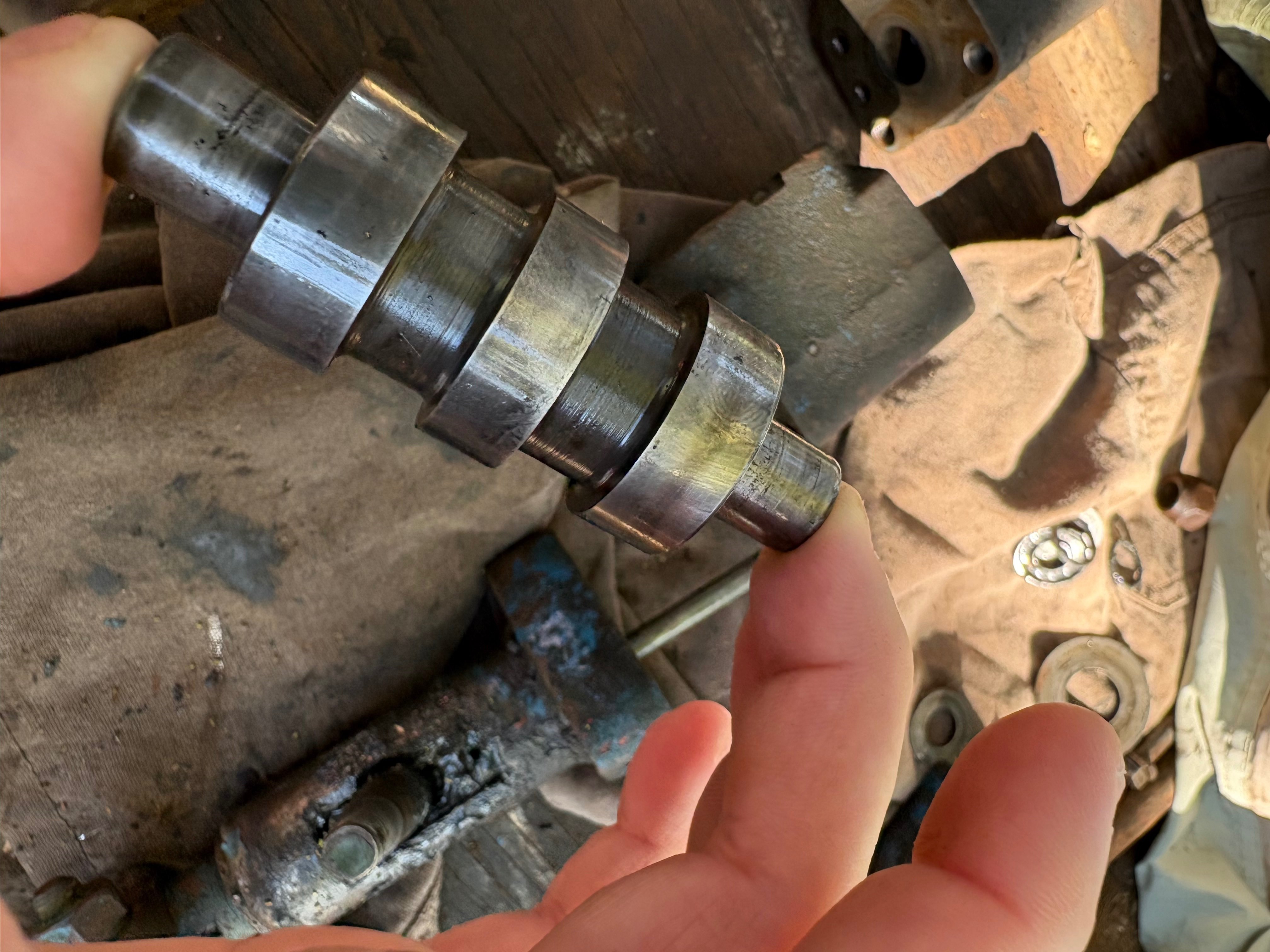

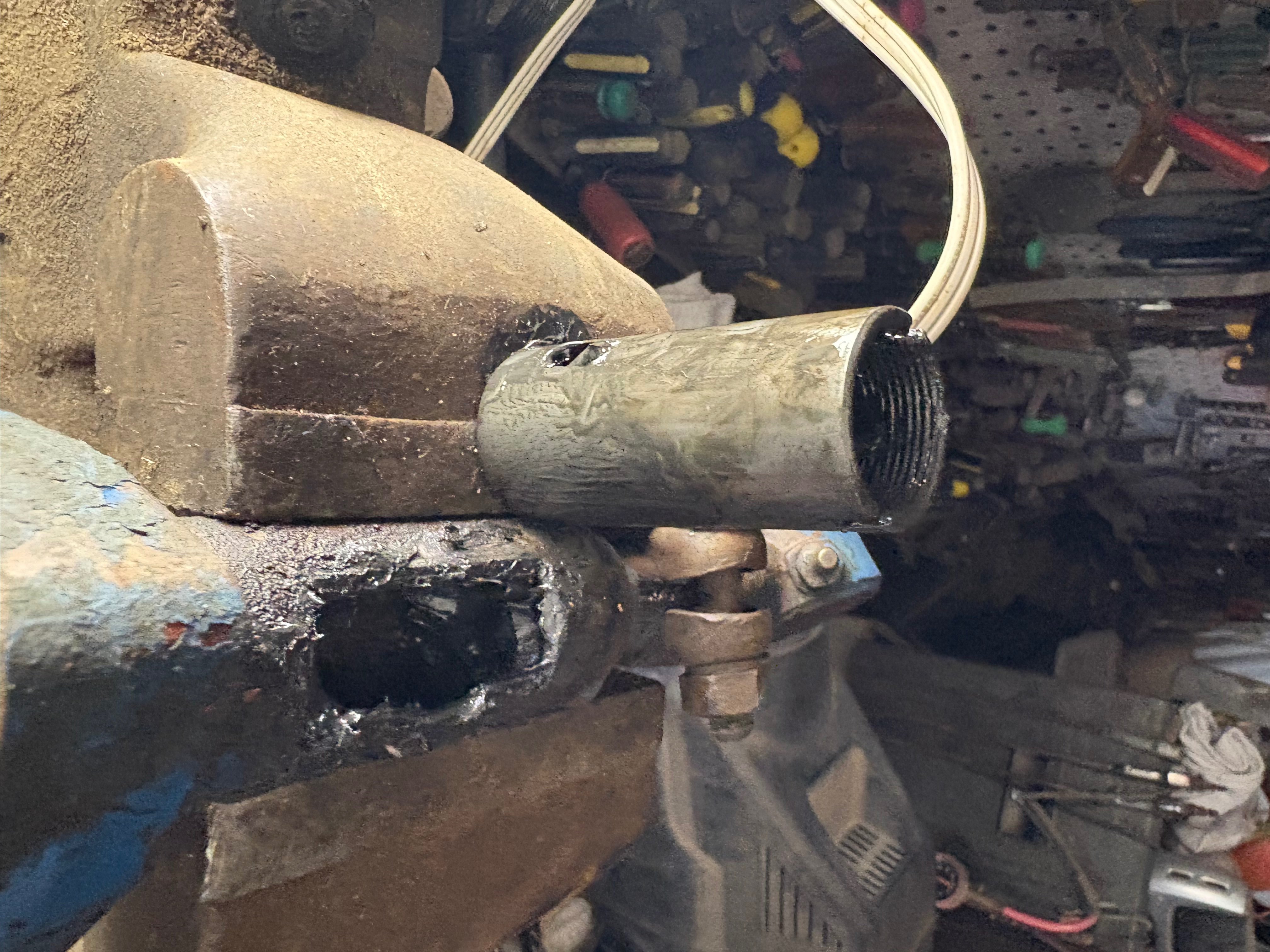

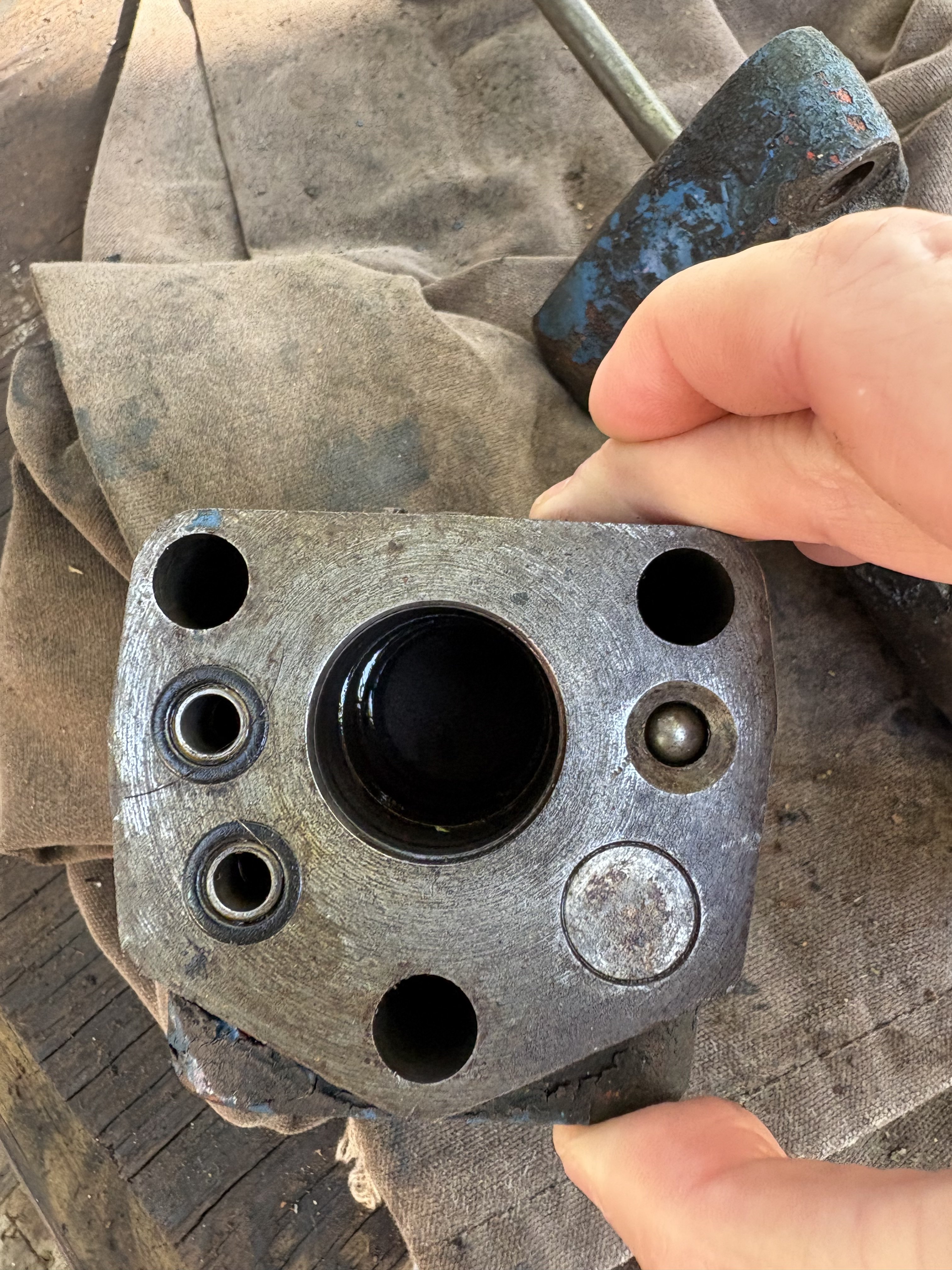

Thank you so much. We got it broke down. Do you have a suggestion on a replacement kit? I’ll add some pics too

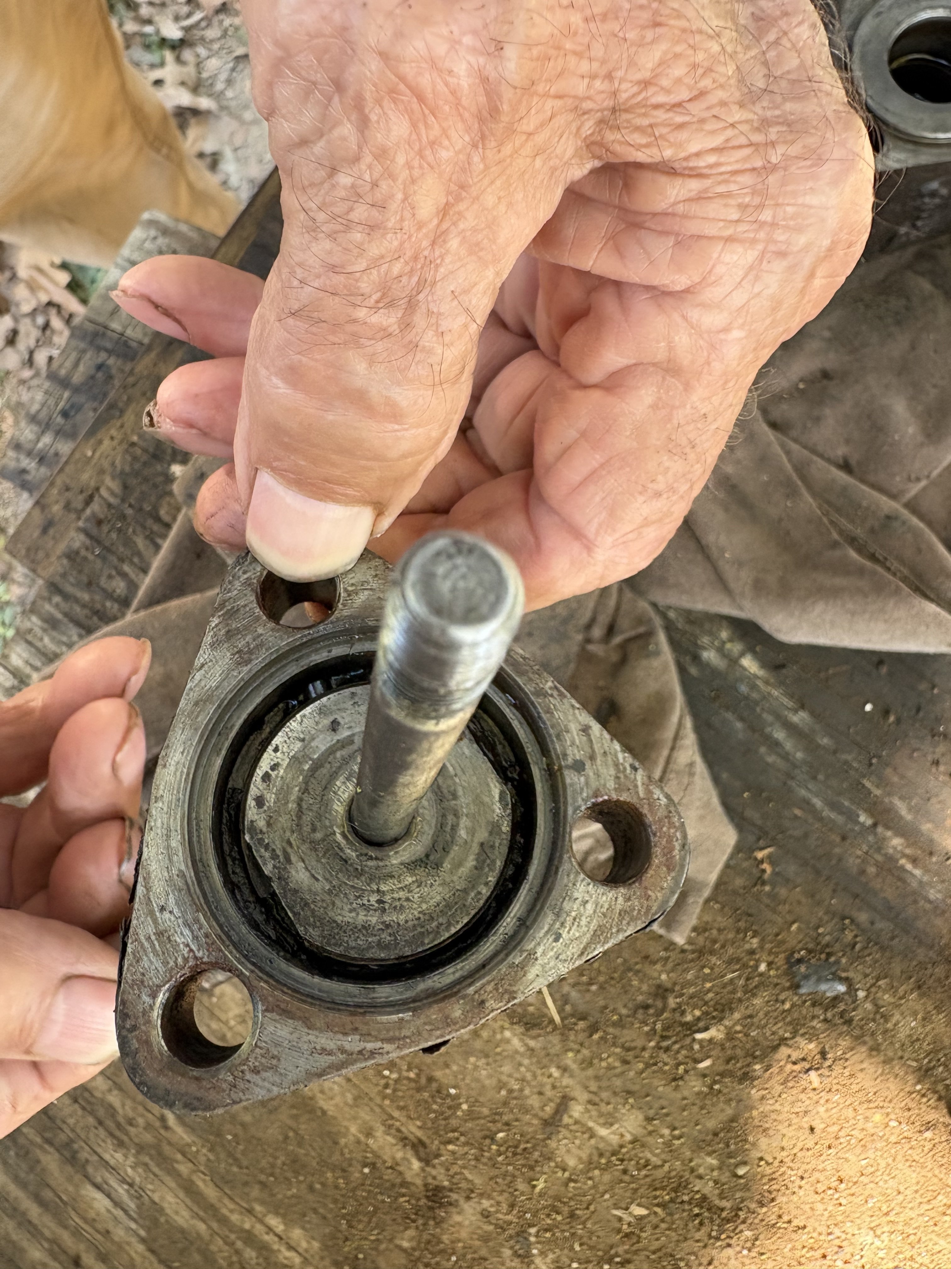

Thank you! This will help us put it all back together. Do you have any place I can order the rebuild kit? I’m sure the spring is bad and whatever comes in a kit. ThanksHere is a link to a good video on repairing that row crop power steering cylinder:
I ordered my parts and kits from Messick's:Thank you! This will help us put it all back together. Do you have any place I can order the rebuild kit? I’m sure the spring is bad and whatever comes in a kit. Thanks
Any other ideas it says it’s discontinuedI ordered my parts and kits from Messick's:

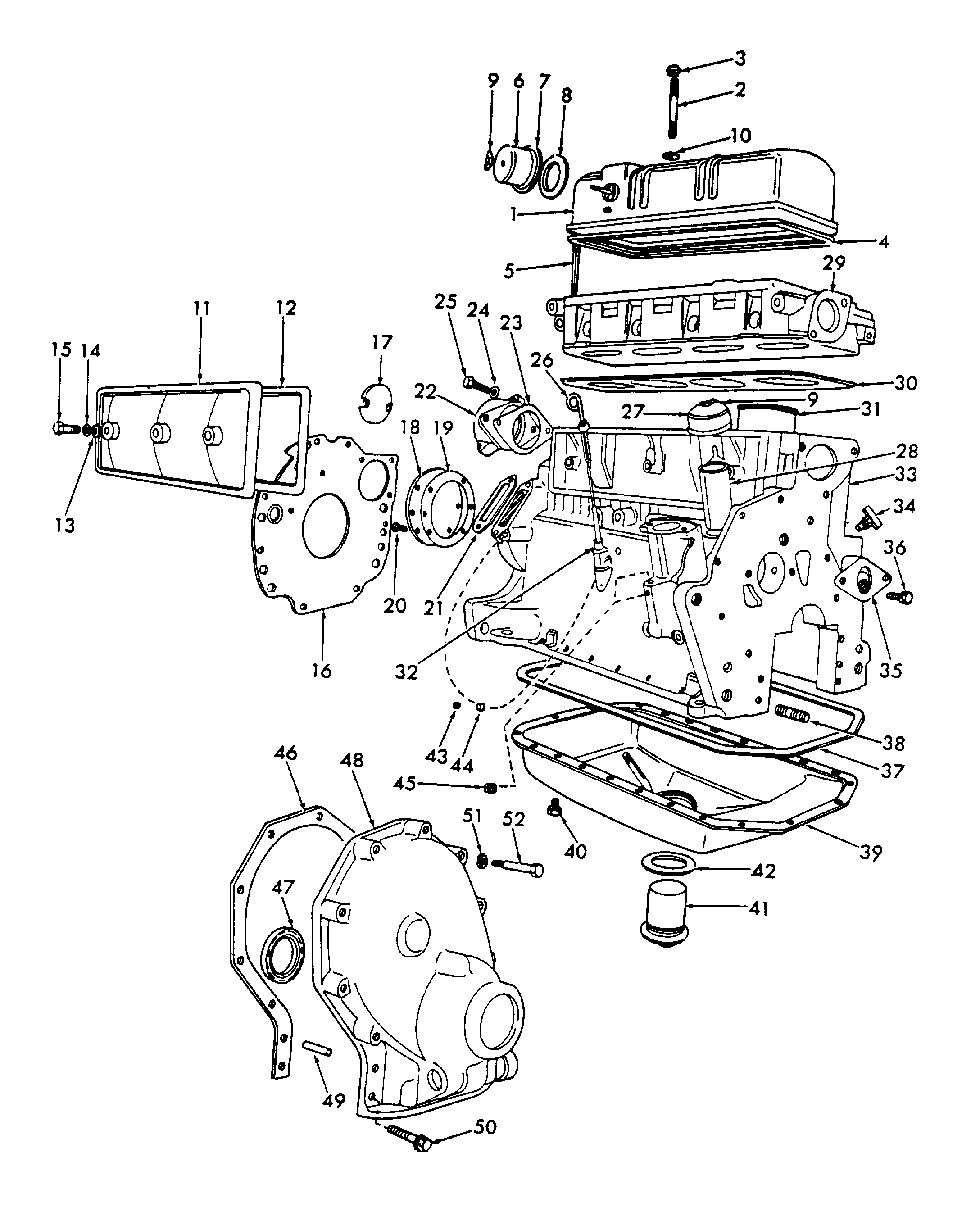

New Holland 901 - 4 CYL AG TRACTOR ROW CROP(01/57 - 12/62) Parts Diagrams
New Holland Parts Catalog Lookup. Buy New Holland Parts Online & Save!www.messicks.com

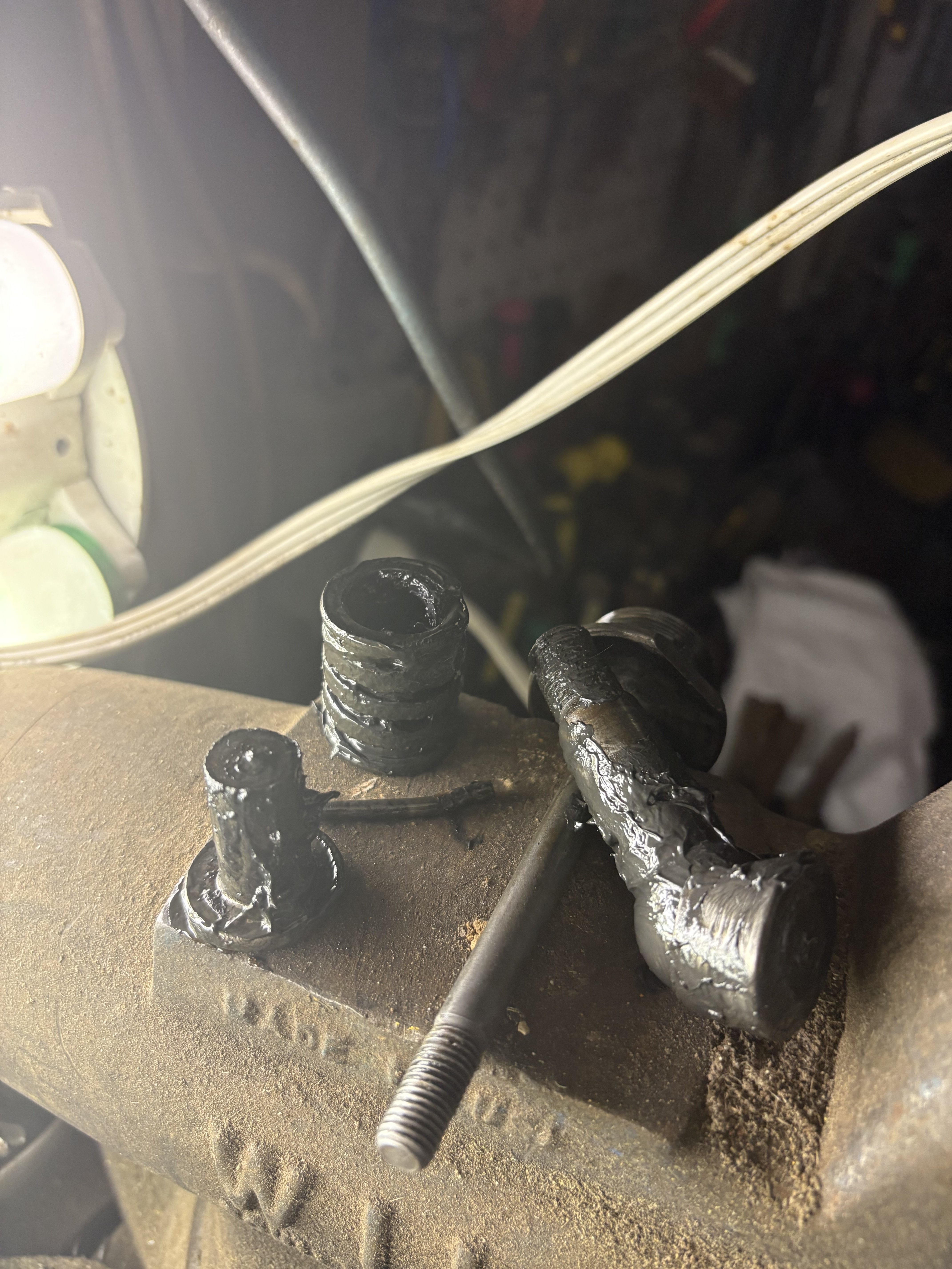

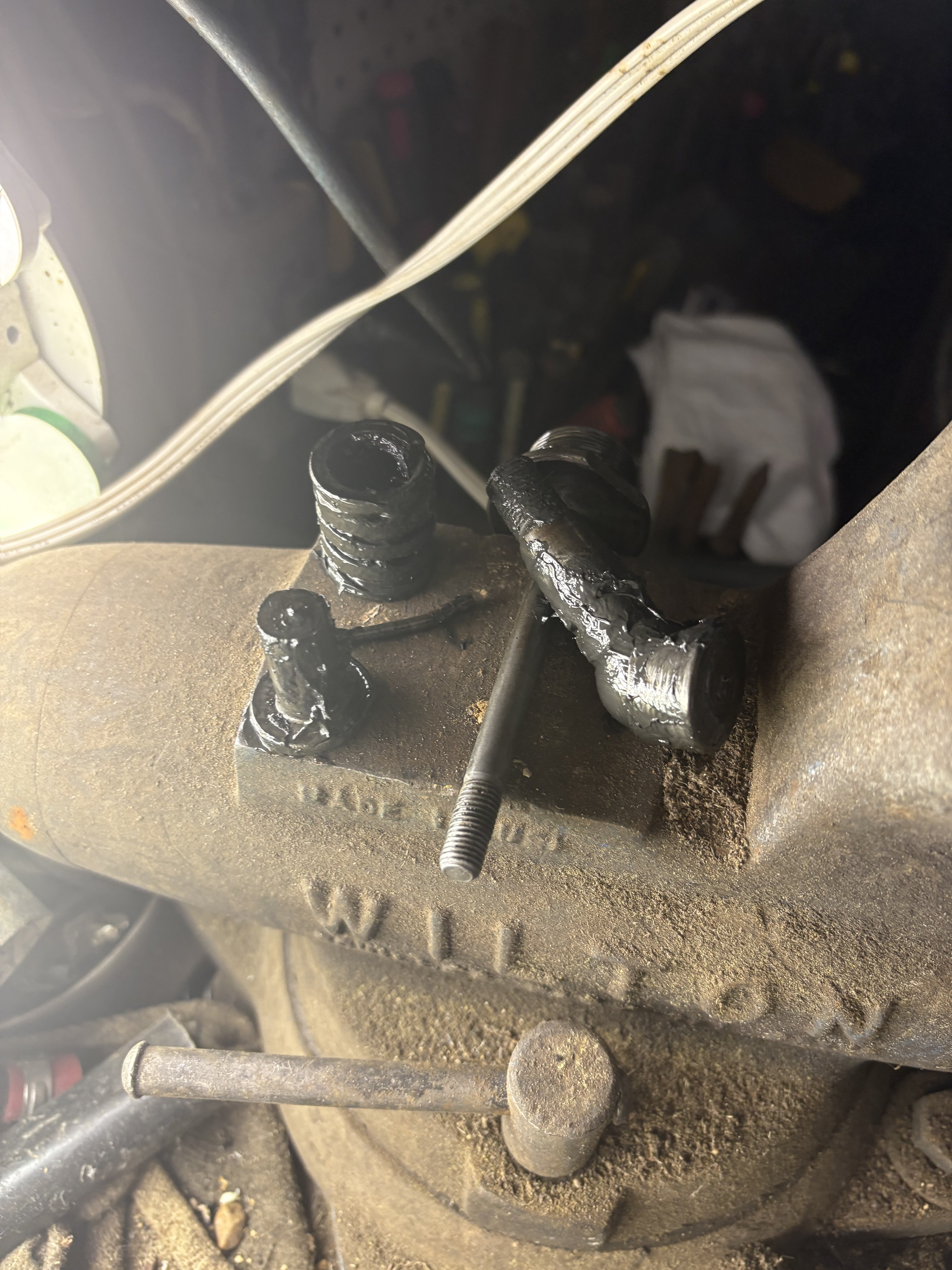

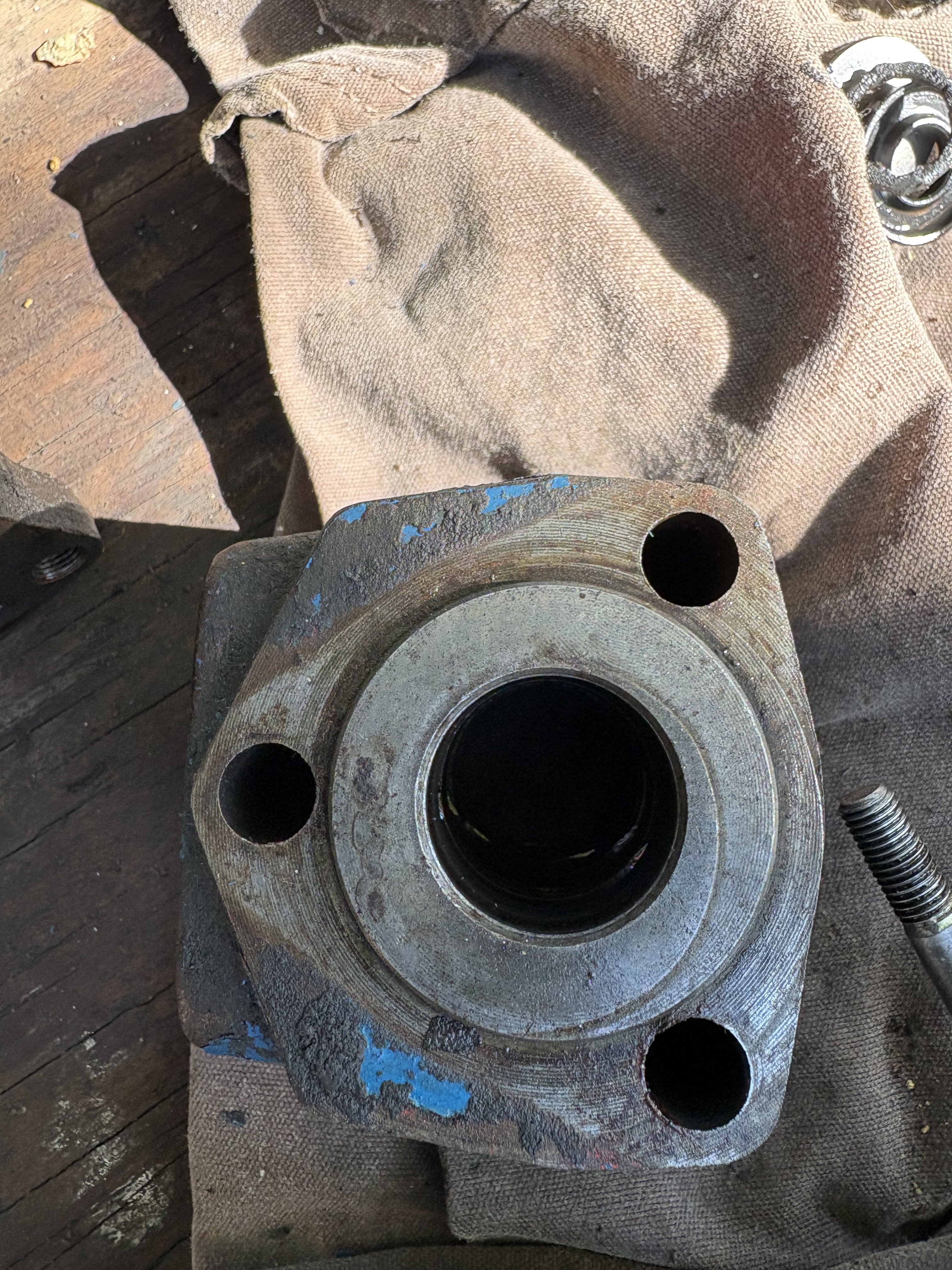

The cylinder kit is part number 87029510 and the control valve kit is part number 231128.Any other ideas it says it’s discontinued
Those you most likely will have to track down as used items. Try contacting Unger Tractor in Missouri.I ordered the seals but would like to get the ball stud and the spring. Do you see it anywhere?
