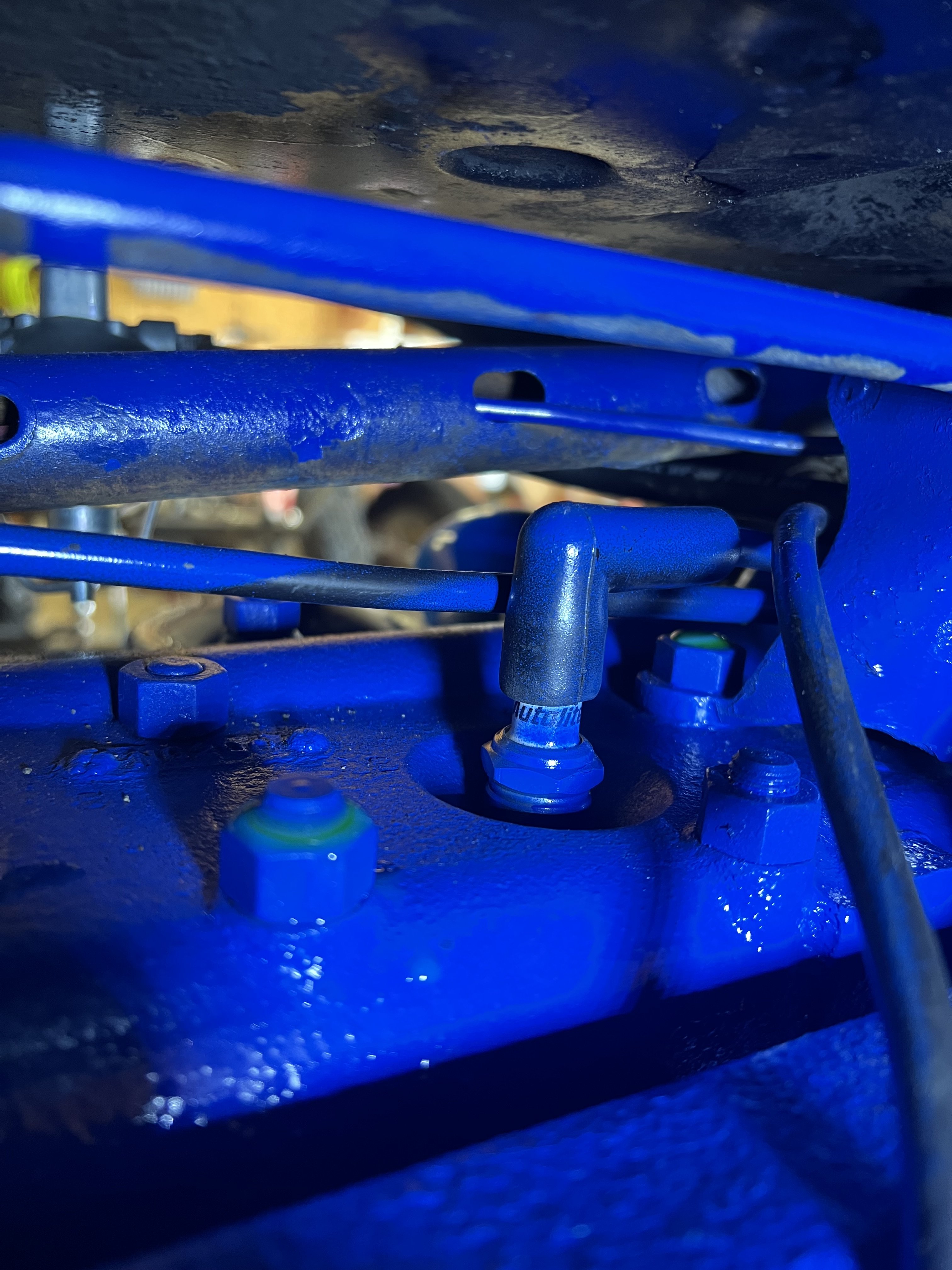

Hey fellas I am back again. 1941 Ford 9n that hadn’t run in 10+ years that I took in just for something to do. Did a rebuild on the top end based on why it was parked and other observations. Put it back together and it won’t start due to no spark initially (troubleshooting that now) but while I traced the no spark issue I am seeing coolant coming up through 3 of the head nuts (see photo and little green pool around 2 of the blue nuts). Never seen that before. Any options to fix that without taking the head back off by any chance?

I didn't know it was recommended, and no one told me to goop the studs. I got lucky and none of mine have leaked. Not sure how I got away with it, but I'm not complaining.
Goop up the studs with Permatex Aviation Forma-gasket.
If you are ever not sure if a stud/bolt goes into a water jacket, clean the hole/threads and goop it up. If you have tap/dies finish cleanup with those.
My Neighbor has a 9N.......Teflon pipe dope on any studs that are open ended into the coolant / engine block passage....
No more leaks...........

Ok this one we can see the link name. The link didn’t work to click on it but I just googled the sealing tabs. I have never heard of these but love the premise. Do you believe dropping them in will seal the leaks on my head studs/nuts without me having to tear it apart? You will quickly become my favorite person if that were the case.

I would give it a try, it will take awhile maybe weeks it will depend on how much you run it. Run the engine then Crush them up first then add. GM is not the only one that has a tab I use to use Ballkamp (napa) they do work. This was the factor repair for leaking Cadillac NorthStar engines from the factor. I have used it on leaking head bolts on a N : ).
Next time use Mad farmers recommendation it has never let me down. Why did I have leaking head bolts I used Teflon pipe dope : ( never again.

In addition to sealer on the head studs: Most of the head-gaskets you find for N's these days are the one-piece, aluminized (flexy-metal-feeling) ones. Which work just fine. But one common problem with them is that the stud holes aren't always cut perfectly in them. Sometimes one or two will be just a smidge off, and will bind slightly as you slide the gasket down on the studs. That may seem like nothing to worry about, but it'll cause a leaking head gasket. Even if it's only binding/rubbing a tiny bit and you can make it go down, when you tighten the head up, the gasket will 'bunch up' around the stud it was binding against and not seal around that stud.
You need the gasket to drop on easily and fully with no intervention. If a stud seems to bind or rub on one of it's holes, file that hole in the head gasket a bit until it drops all the way onto the block cleanly and easily.
