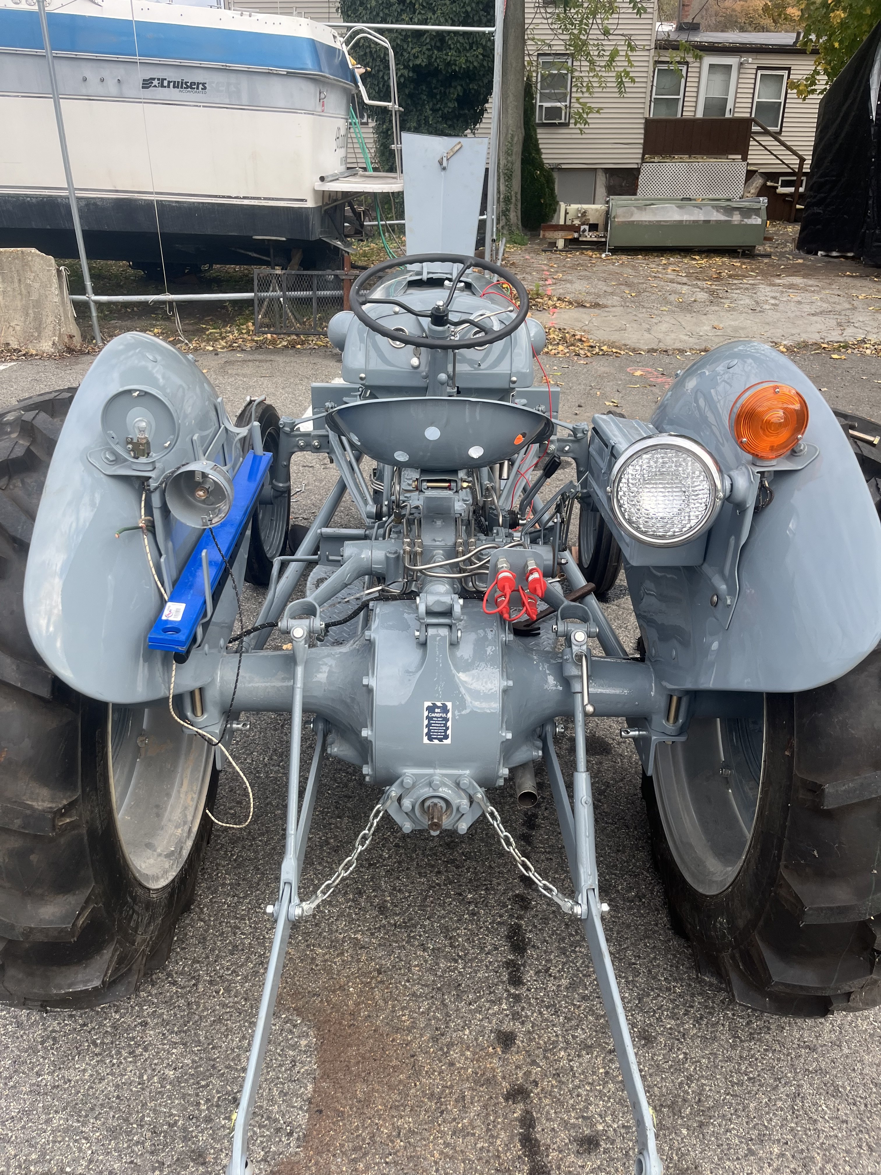

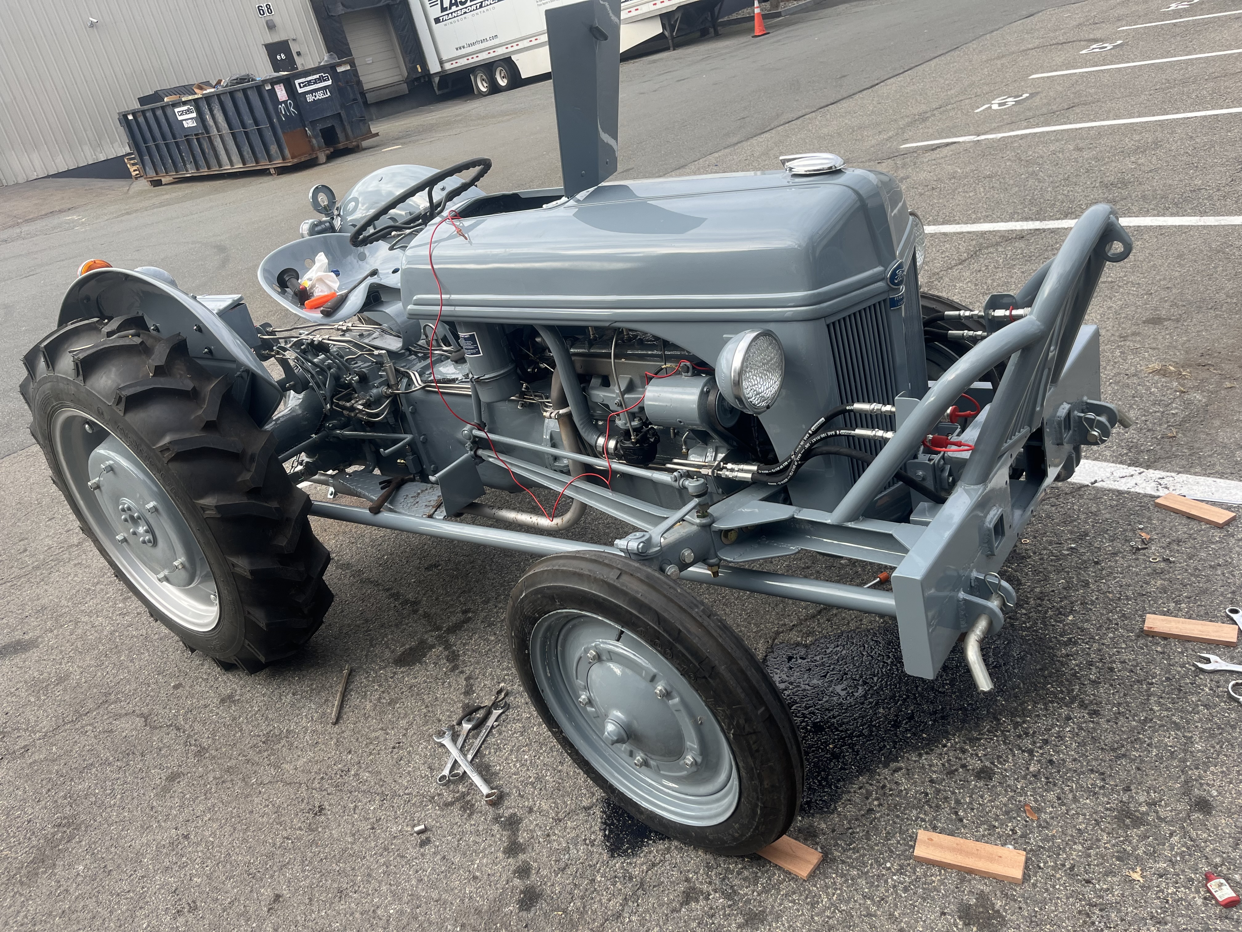

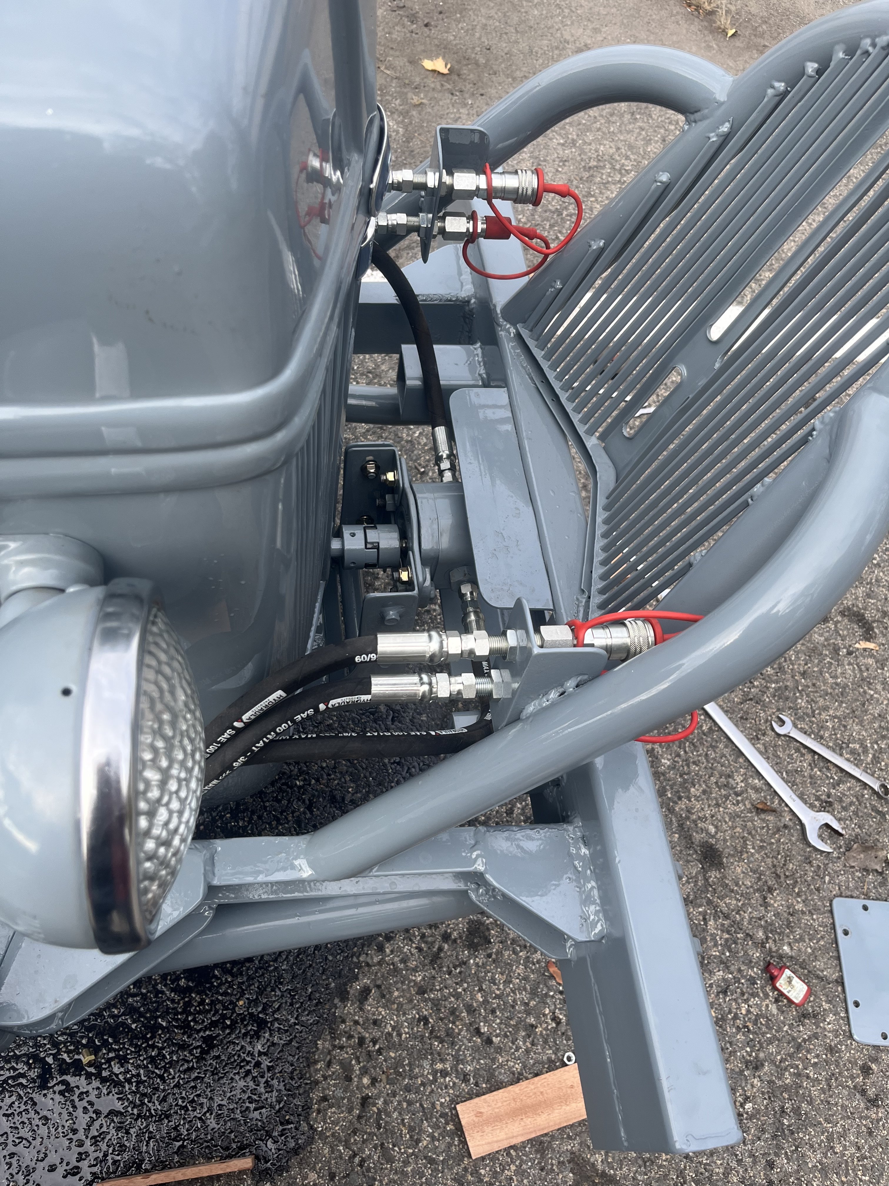

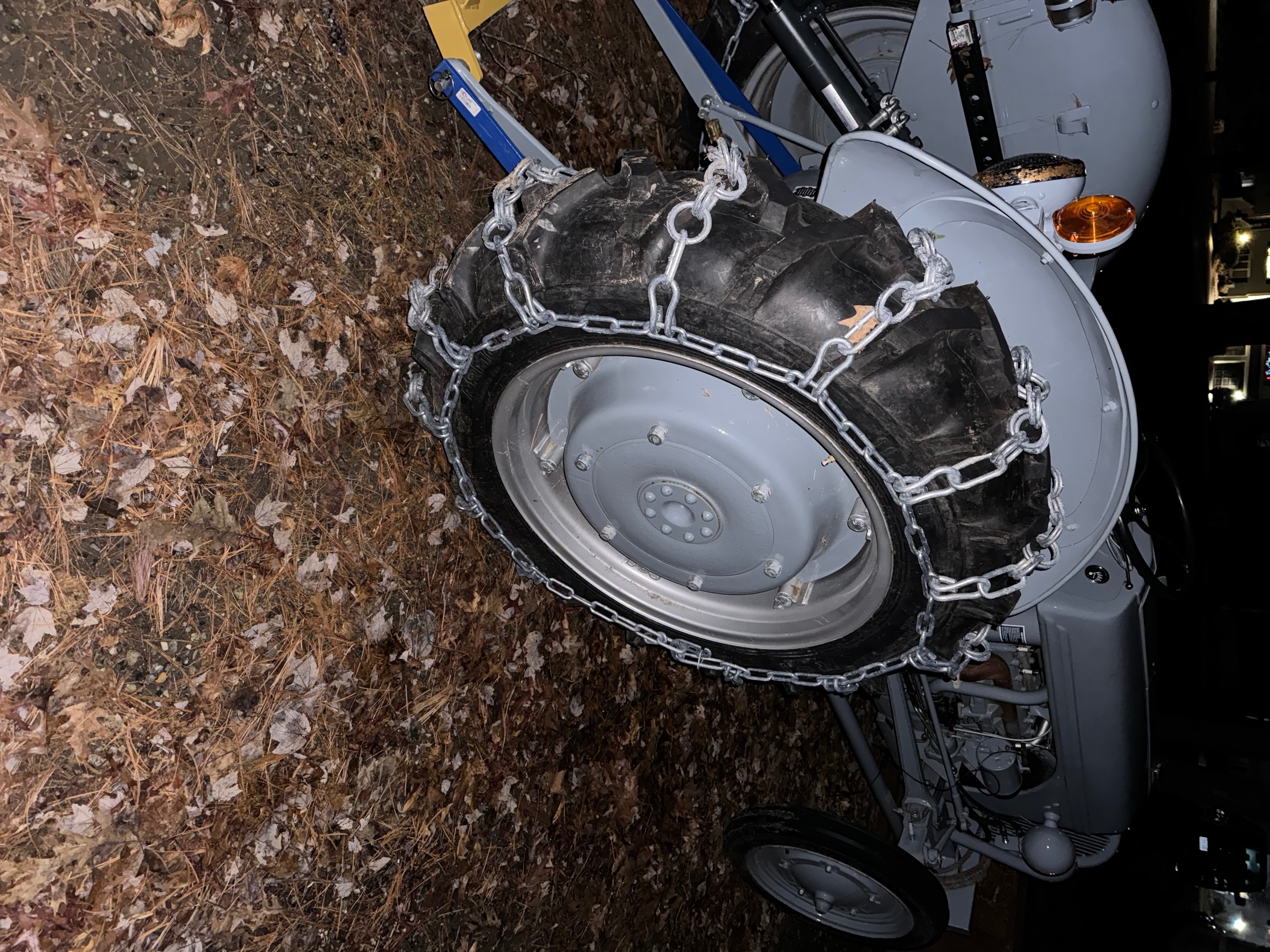

When i was restoring my 1941 91 tractor i went threw the effort of getting all the color greys suggested on older posts getting samples of all and then finding grey parts on mine that had been protected and never repainted like on the inside of the lift arm caps and found the best gray that i found matched all and was affordable. What i came up with was
(DelFlet Essential ESSS) HS Polyurethane Single Stage PPG industries
Its A MACK COLOR
Brand Code 36120
OEM Code: 36120
sprayed nice looked great you can go to a few of my past posts were iv posted pictures of the tractor and see what it looks like.
