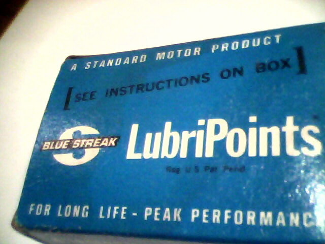

Hi Just saw your picture there, looks like that distributor has not seen any distributor cam lube in a while. That rust is abrasive and will wear down the rubbing block on the points very soon. That cam needs to be clean and smooth. Used to be new points came with a capsule with distributor cam lubricant in it. Not any more apparently.
I like to use Blue Streak brand points. They have a pre-lubed wick. Some say you can get them at O'Reilly auto parts if you have the part number.
I usually get them N.O.S. from eBay.
For distributor cam lube, there is N.A.P.A. ECH ML1, and Standard Motor Products SL2. May be others, that is all I know about. In a pinch it is possible to use Silicon dielectric compound as a lubricant, better than nothing. Whatever you use, it only takes a very small amount, wipe it on , wipe it off.
