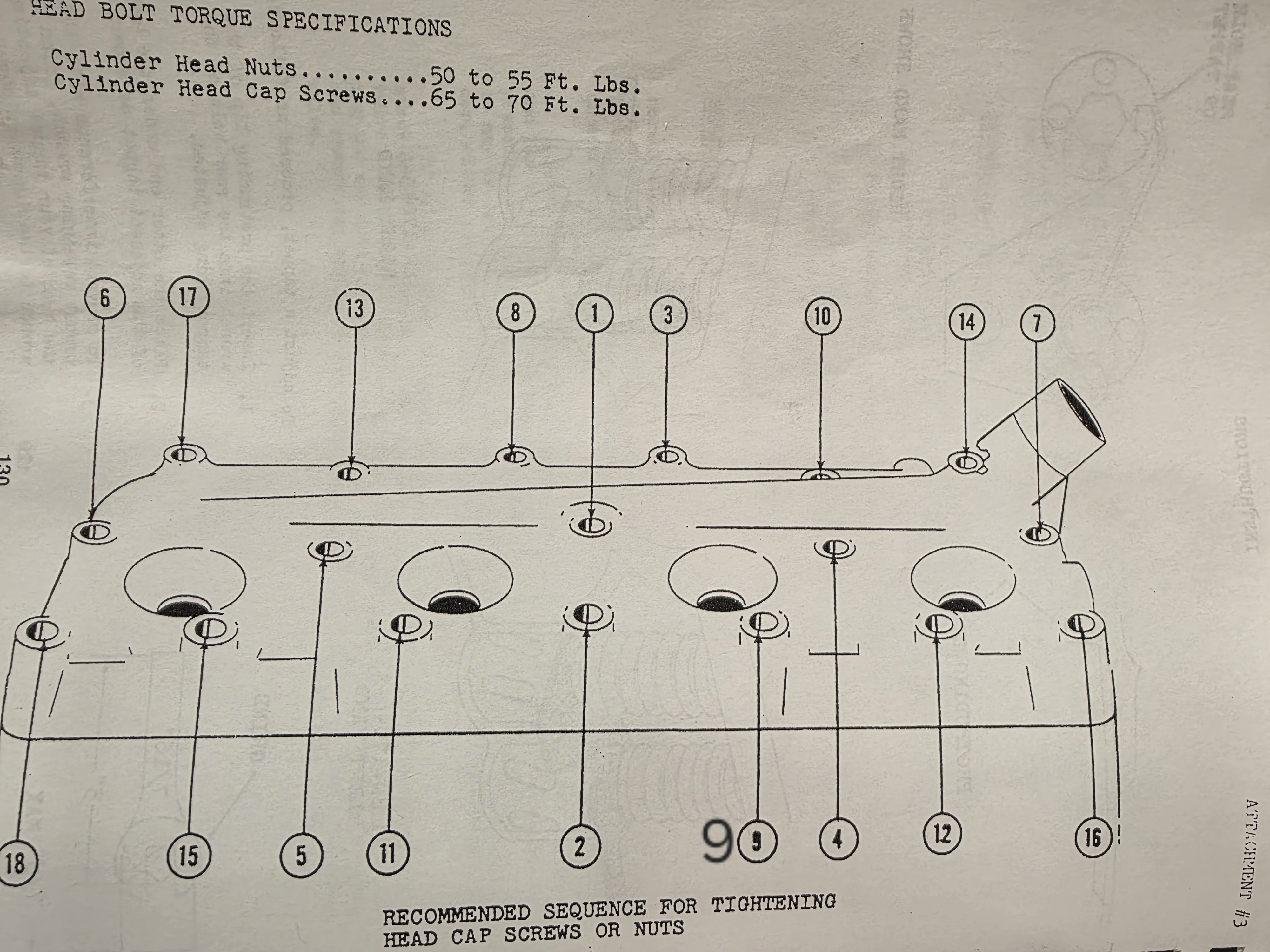

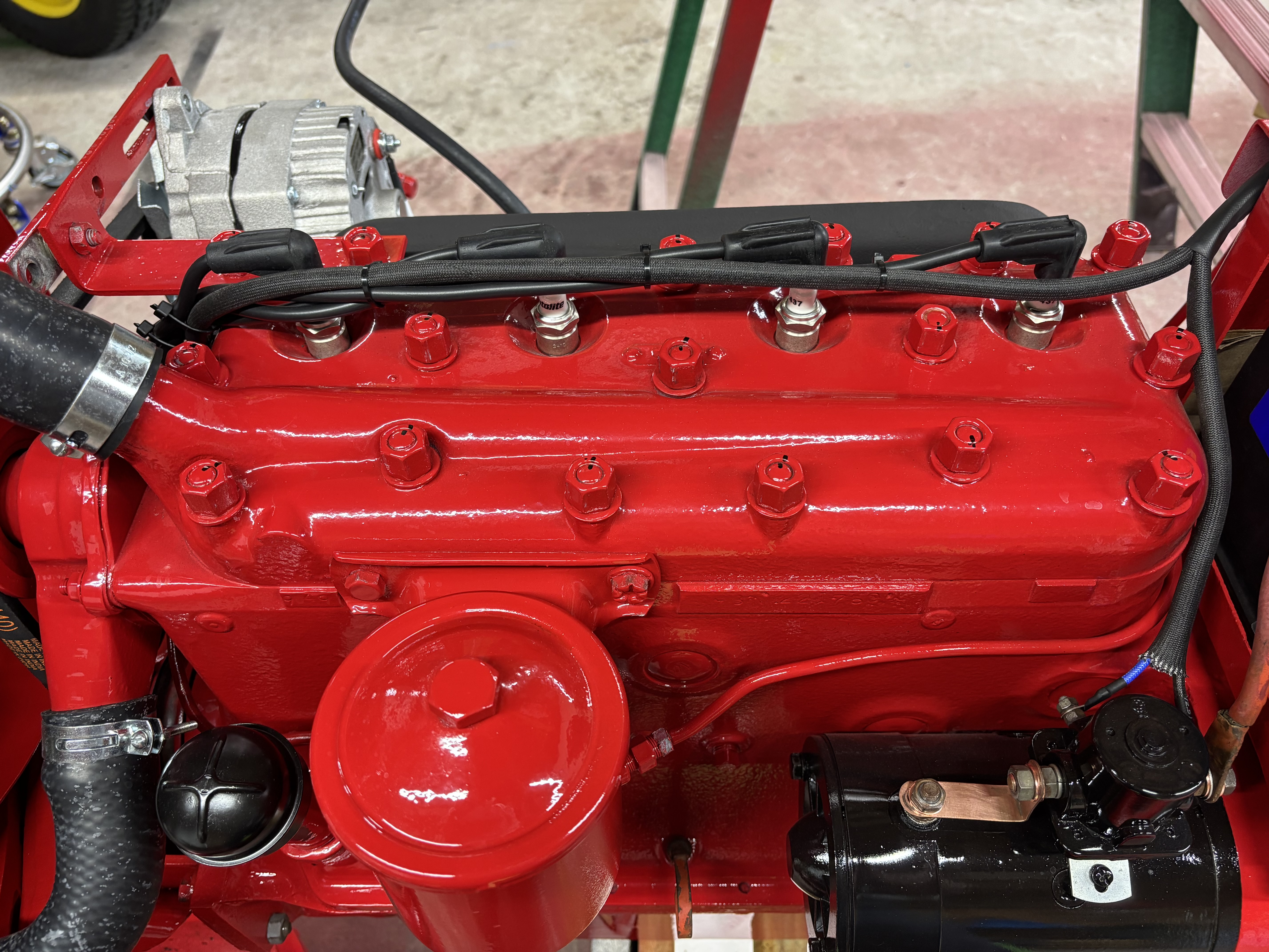

Well I ran the tractor last week for an hour let it cool and retorque the head. Everything appeared fine. So today I decided to let it in run for a while just for motivation. However, one of the head studs had a little moisture around the nut. So I shut the engine off and dried the stud. Problems is even with the engine off it leaks with just the water head pressure from radiator. So now what do I do? I used Felpro head gasket, new studs, washers, and nuts..used Permatex Aviation on stud threads…torqued with three step sequence…ran tractor for an hour…cooled and retorque the head. Tractor runs great and no water in the oil. So should I torque the head again…I doubt it?? Put some stop leak in it? Will it fix itself? Thanks.

Hi 65Camp, haven't had a early 8n with studs for a long time. I have had bolts weep a few times recently. Lifted just the weeper, and put some RTV around the top of the shank, then put it back in. Trying to seal the top off.
If you tried to wipe RTV around the stud, trying to push some down, it may succeed.
Are you using the "newer" torque chart?
Not sure it makes a big difference, but its what I go to.

Hello Sir,
Might give that a try. It had bolts and when I changed the head gasket I went with studs in hopes of not having any leaks. Especially after the retorque. Yes I used the torque chart you show. Thanks Paul
Stop leak should take care of it. GM has some brown tabs as does parts stores. Crush'em up and put in the system in time it should seal up. I like GM's.

My experience with using cooling system stop-leak is not good with older tractors. IMO, don't use a band-aid on a fresh rebuild, do it right and it will last. Somewhere there is a leak in the new head gasket that shouldn't be.
65Camp, did you put the head gasket on dry? An old trick from many years ago, that I still use today, is to just spray both sides of the head gasket with paint. Put the gasket and head on and torque it down before the paint has time to completely dry.
