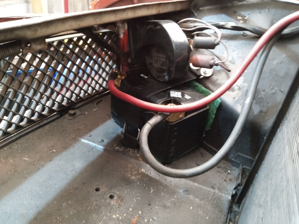

I have a 1974 MGB. I went to a 400cca Lithium Iron Phosphate battery. it is very small and light. Spins the 1800cc four cylinder engine very fast. I'm sure it would work in a tractor also. I might give it a try.
I have a 1974 MGB. I went to a 400cca Lithium Iron Phosphate battery. it is very small and light. Spins the 1800cc four cylinder engine very fast. I'm sure it would work in a tractor also. I might give it a try.View attachment 7550
I have LiFeP04 aka Lithium Iron Phosphate in the RV but of course can NOT let my standard automotive engine alternator charge them as they could draw excess current and possibly damage an un properly protected alternator. I had to use a DC to DC charger to allow the alternator to charge my lithiums at the correct 14.6 volts while limiting and protecting the alternators output to the charger, works perfect. When dry camped my solar panels recharge the lithiums. I trust you’re set up so your alternator and its voltage and current regulation scheme allows that battery to properly charge yet not over tax the alternator. I still run agm for starting batteries in my vehicles etc Thanks for the report glad it’s working out fir your needs congratulations. John T
This battery is made for large displacement motorcycles as a direct drop in. The built in battery management system takes care of the charging scenario. Been in the car almost 4 years.
