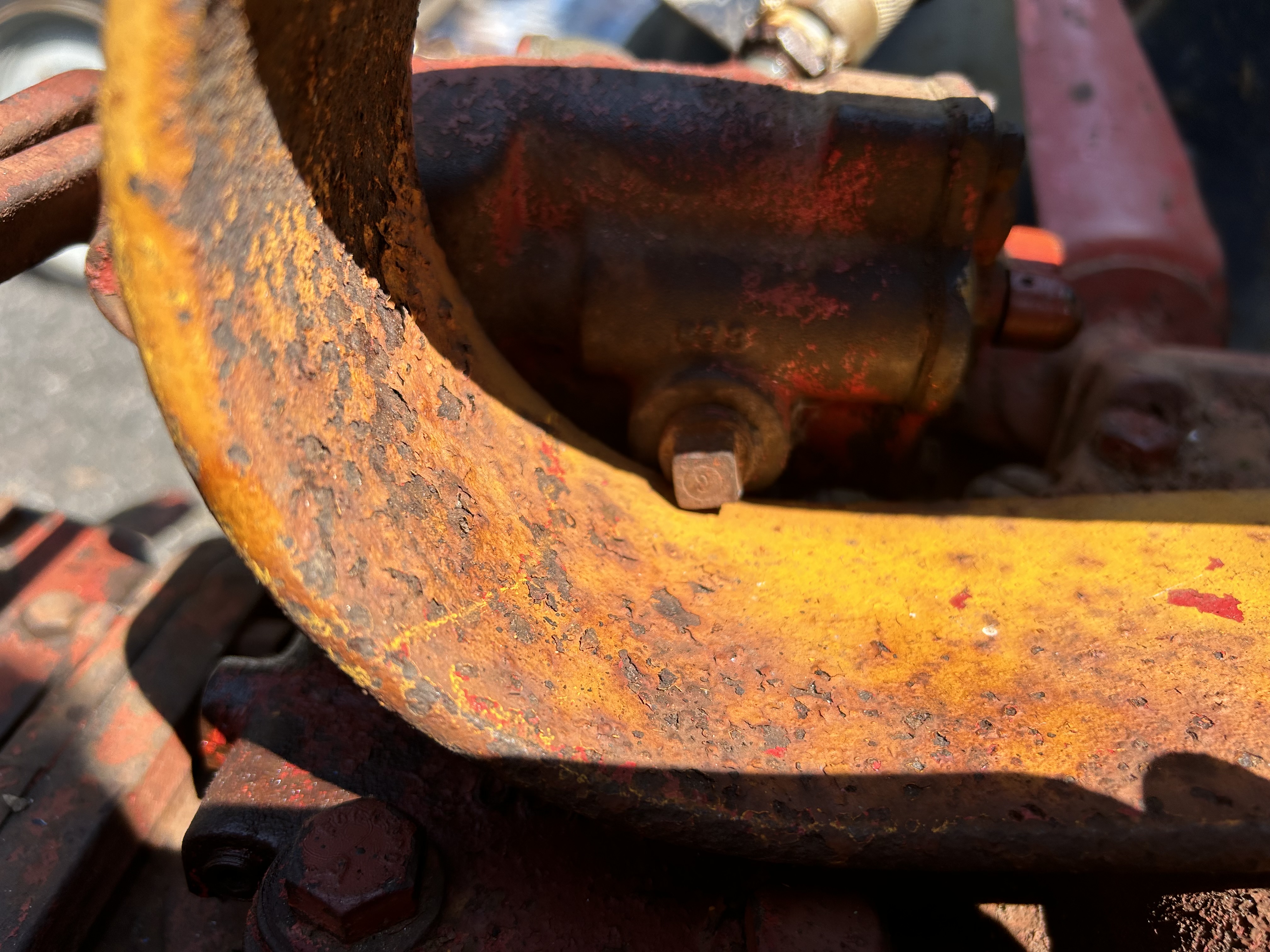

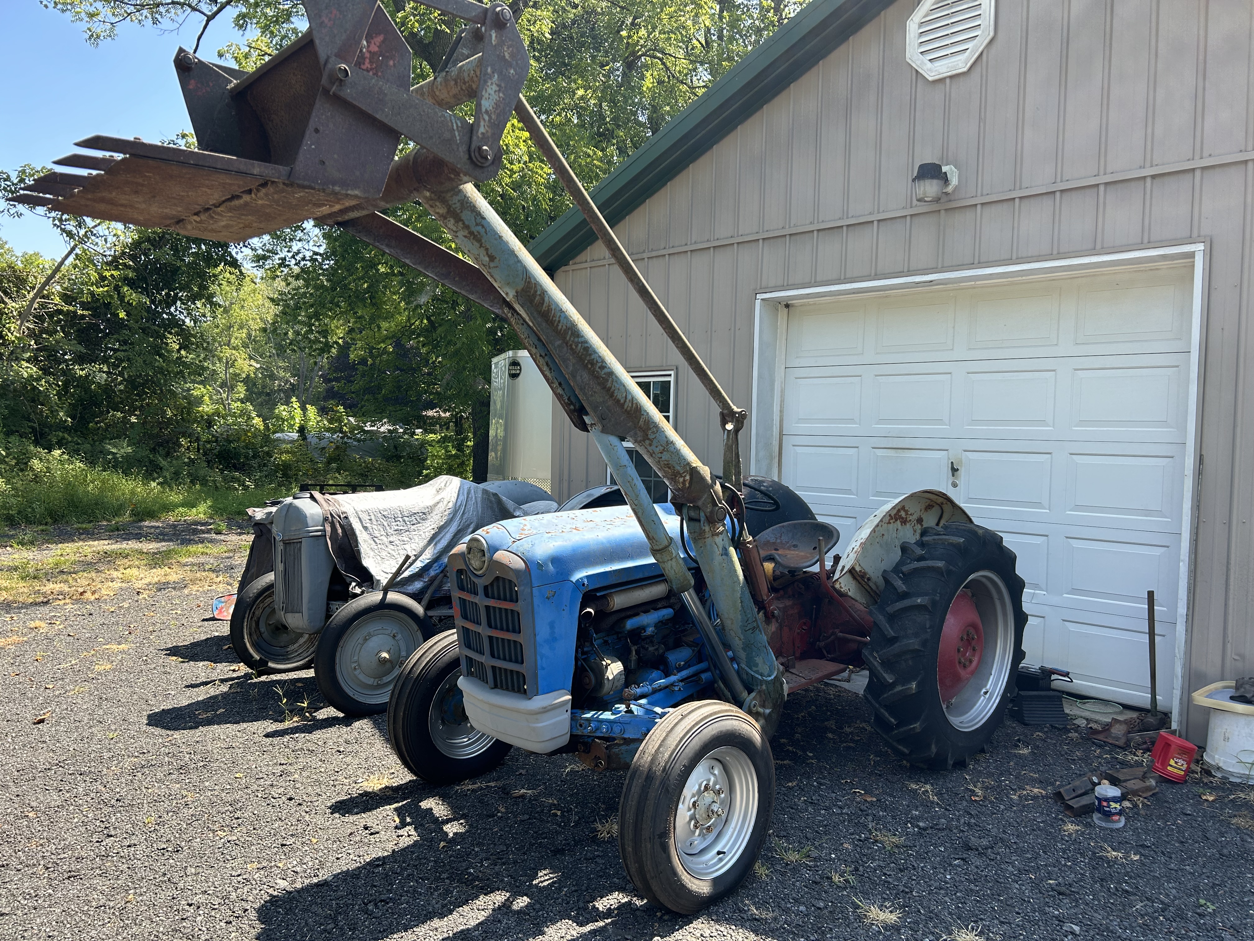

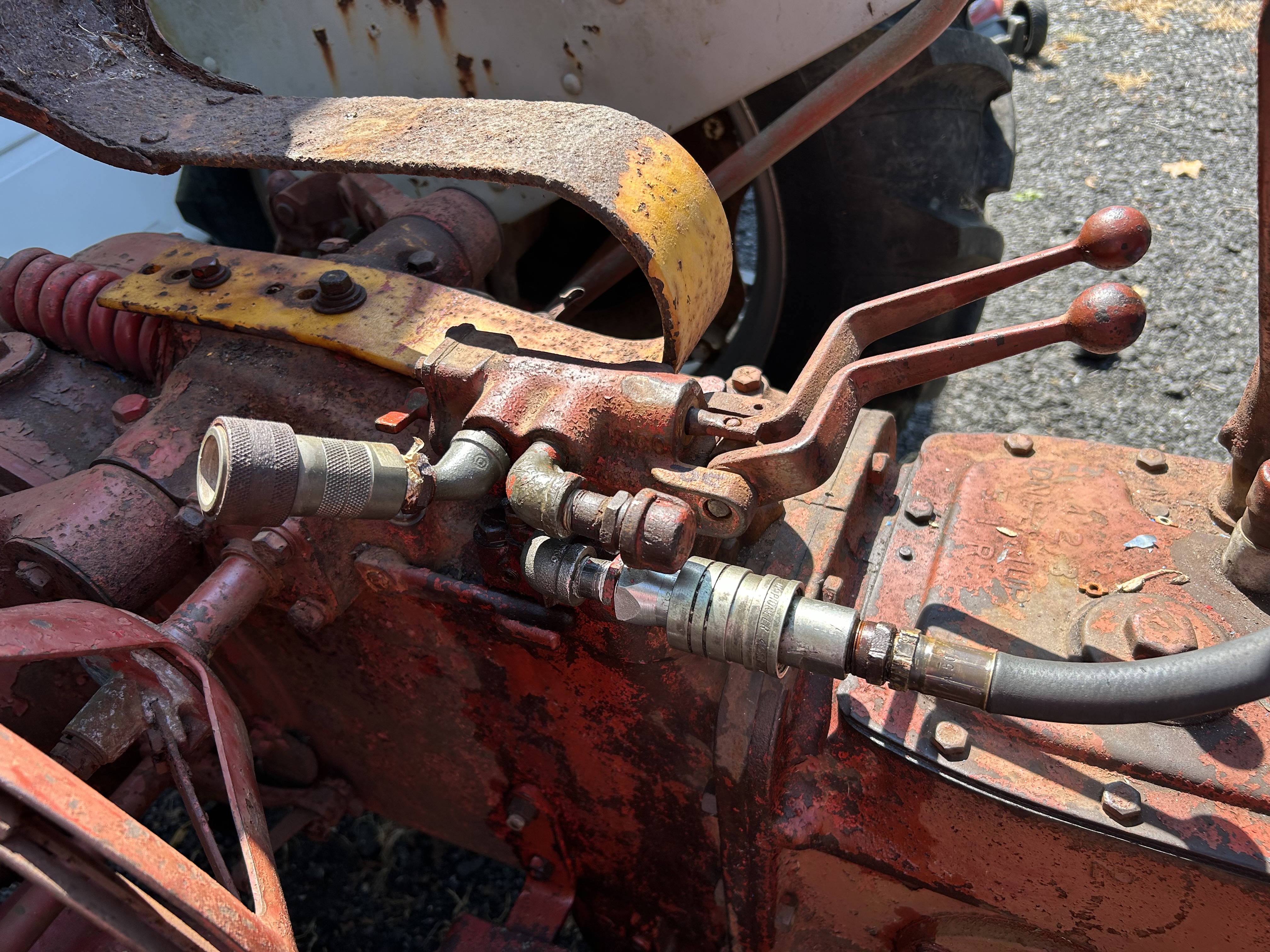

AICO double handle remote. Bottom one with quick disconnect is hook up to lift piston pressure up and gravity down. Have hydraulic bucket which port is pressure and which port is return?

I believe the two top ports are controlled by the second handle. You will have to connect them to opposite sides of the bucket curl cylinder and test to see if the handle movement satisfies your expectations on which way the bucket moves. If not, reverse them.
