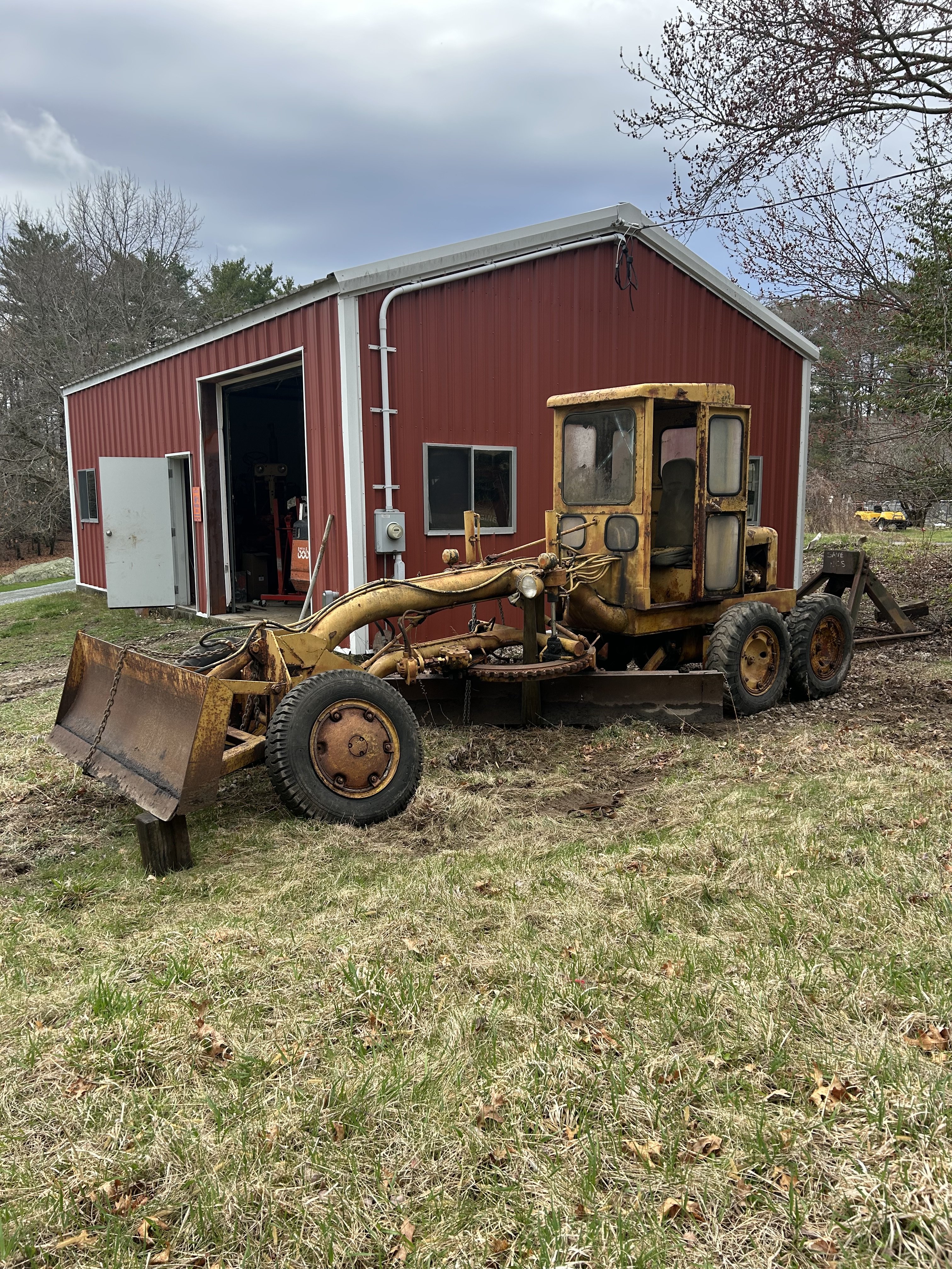

Funny you posted this, I bought one too Saturday! I haven’t even got serial number yet, but my motor is stuck. Still in the cleaning phase
Now that is a nice grader, especially with that dozer blade on the front. That is the first one I have seen. It doesn't happen to have the dual range transmission does it?
Your looks like it may be a bit later than mine (D-3789) due to the front wheel style. It's nice to see that there is another D grader with lugs twisted off. Mine has about one on each wheel.
It's difficult to determine if it have power steering? I hope it does or else the added weight of the blade will make turning even more of an effort.
I think mine was owned by a county so it has lights all over the place front and rear, not that any of them actually work!! That will be a project all by itself.
Mine is D 3099, so earlier!
John,
When you sit on the seat, is there one lever there for the throttle, or are there two levers? The second would be for the dual range transmission.

I have three model D graders. Best to look carefully in front of the cab where the big tube is welded to the cab. A common area for cracks. You may see some massive welds in the area too. 1954 seems right, it will have the WD45 if original engine. Early machines had a WC, and later had a ser 1 D17 engine. Each of mine has a different engine in it. You have some nice options. Closed cab, hyd turntable and both power steering and leaning front wheel.
