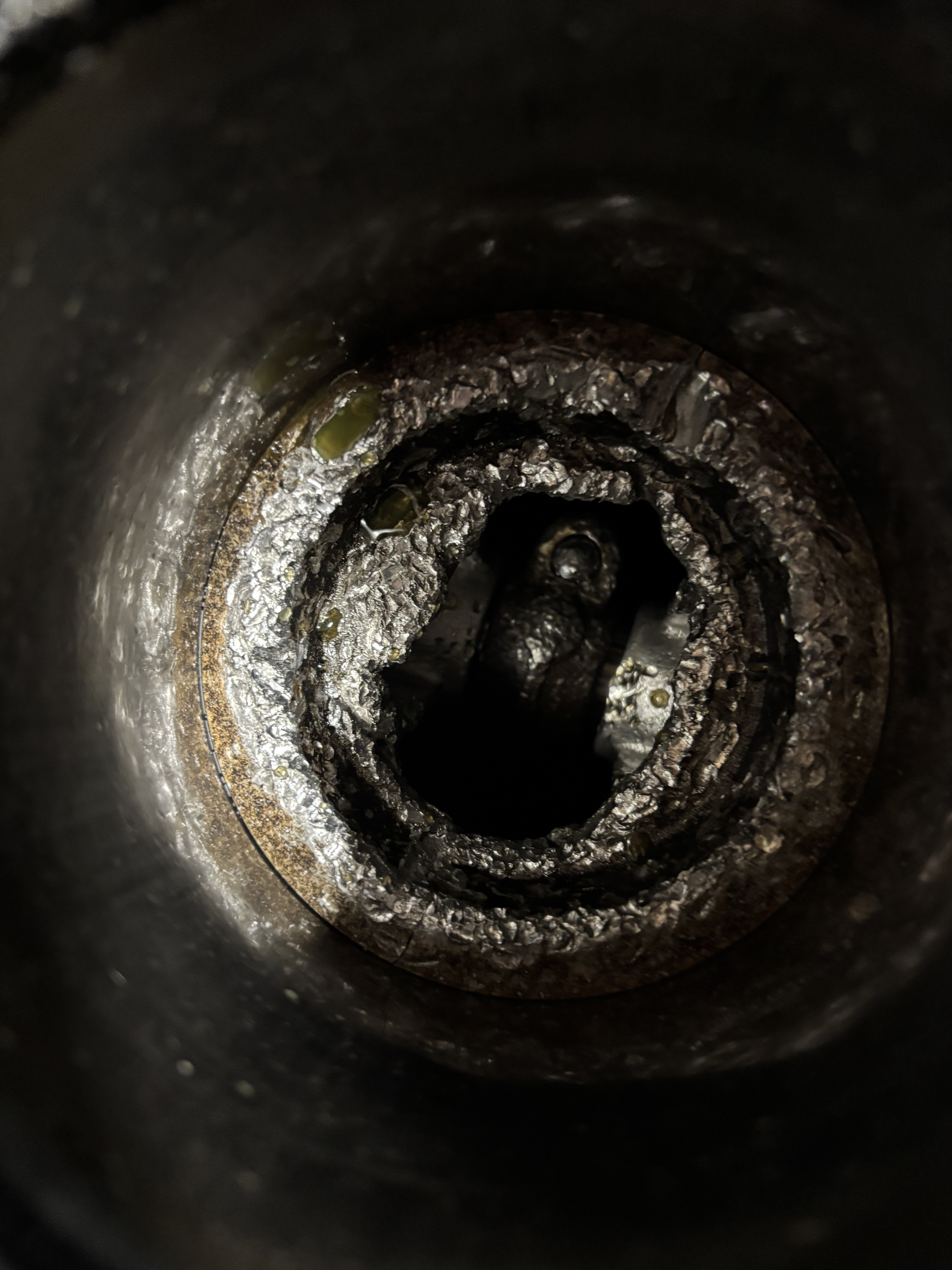

Dropped an exhaust valve on my Allis Chalmers D 14 how much damage before I need to remove the block from the frame?

Probably pull the head will tell you. If sleeved (i can't remember) a new sleeve could fix it. Will need head work and new valves.
