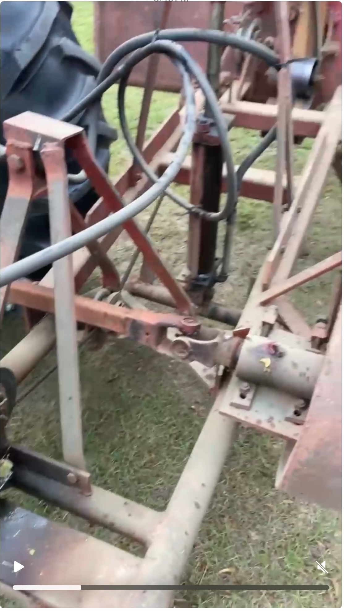

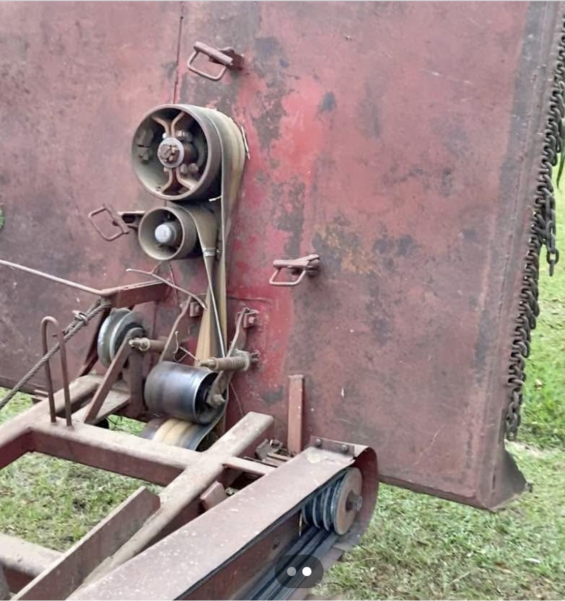

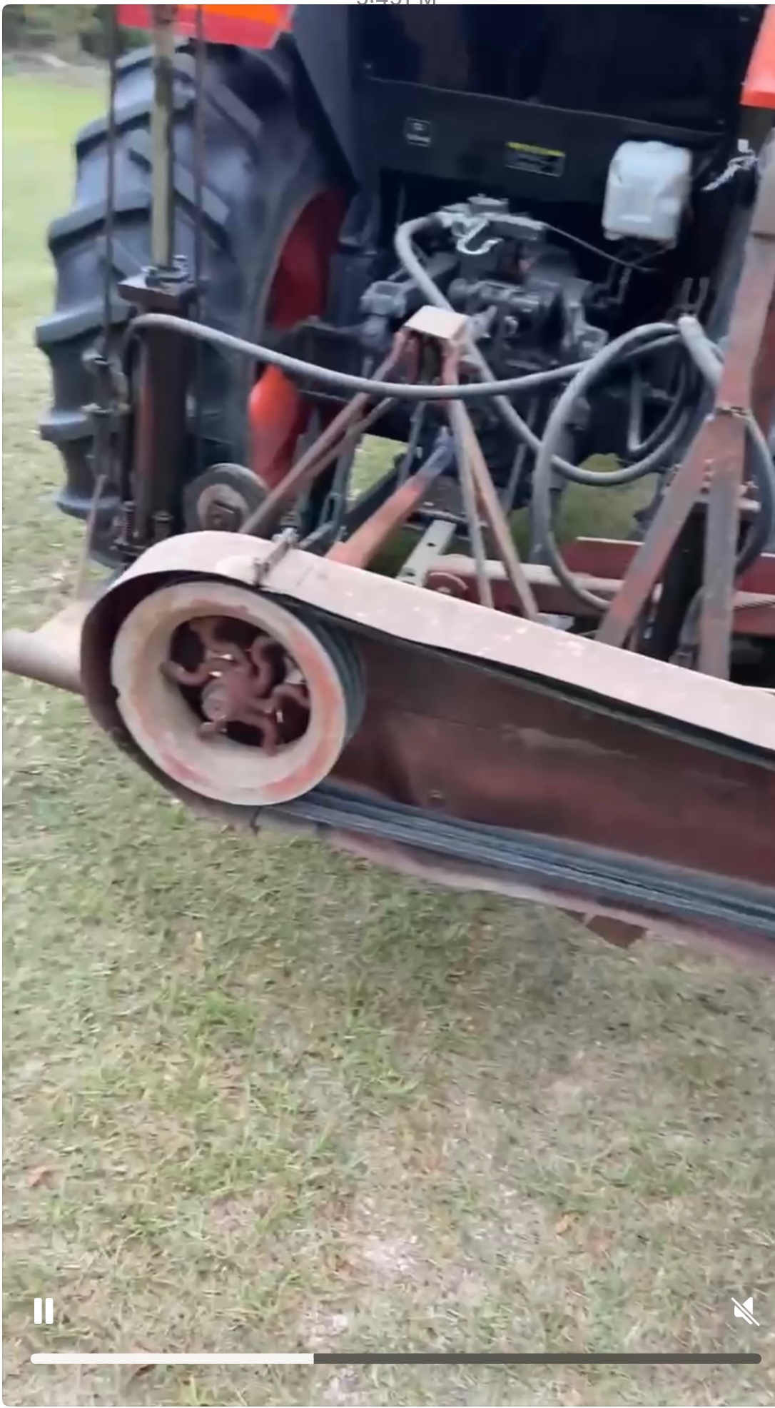

I’m still trying to find information on this brush cutter. It’s old and odd, kinda like a rotary cutter married to a sickle bar setup. I’m currently having the hydraulic cylinders rebuilt and hope to have it ready for spring. The entire setup lifts vertically about 3’ and it tilts from 90* up to about 50* down. Any ideas?
Thanks, Perdido
I have a video, but it’s too large to post. These are a couple of screen shots from that video. I’m in Forkland, AL and I bought this rig from a person near Tupelo, MS
It does look a lot like the one someone was using on the roads here. I knew the fellow but I can't recall now who it was.
I’m about an hour away or I’d post more pictures and the full video I have won’t post. The cutter is a 5’, but no gearbox, stump jumper, etc and it’s lighter than it looks. The rest of it is heavy, very heavy and I would think that it acts as a counterweight…it’s also very tight to the 3 pt hitch. I’ll be running it on a Kubota M7060 4wd cab tractor with loader and the video shows it on a Kubota 6 series which had no problem handling it. My main use will be around ponds, roads and pastures. As I posted earlier it has 2 single acting hydraulic cylinders, 1 controls the tilt and the other controls vertical movement. The guy I bought it from used it to mow along roads and around pastures and coupled with the 3’ lift on the cutter and the 3 pt lift it gets up pretty high.

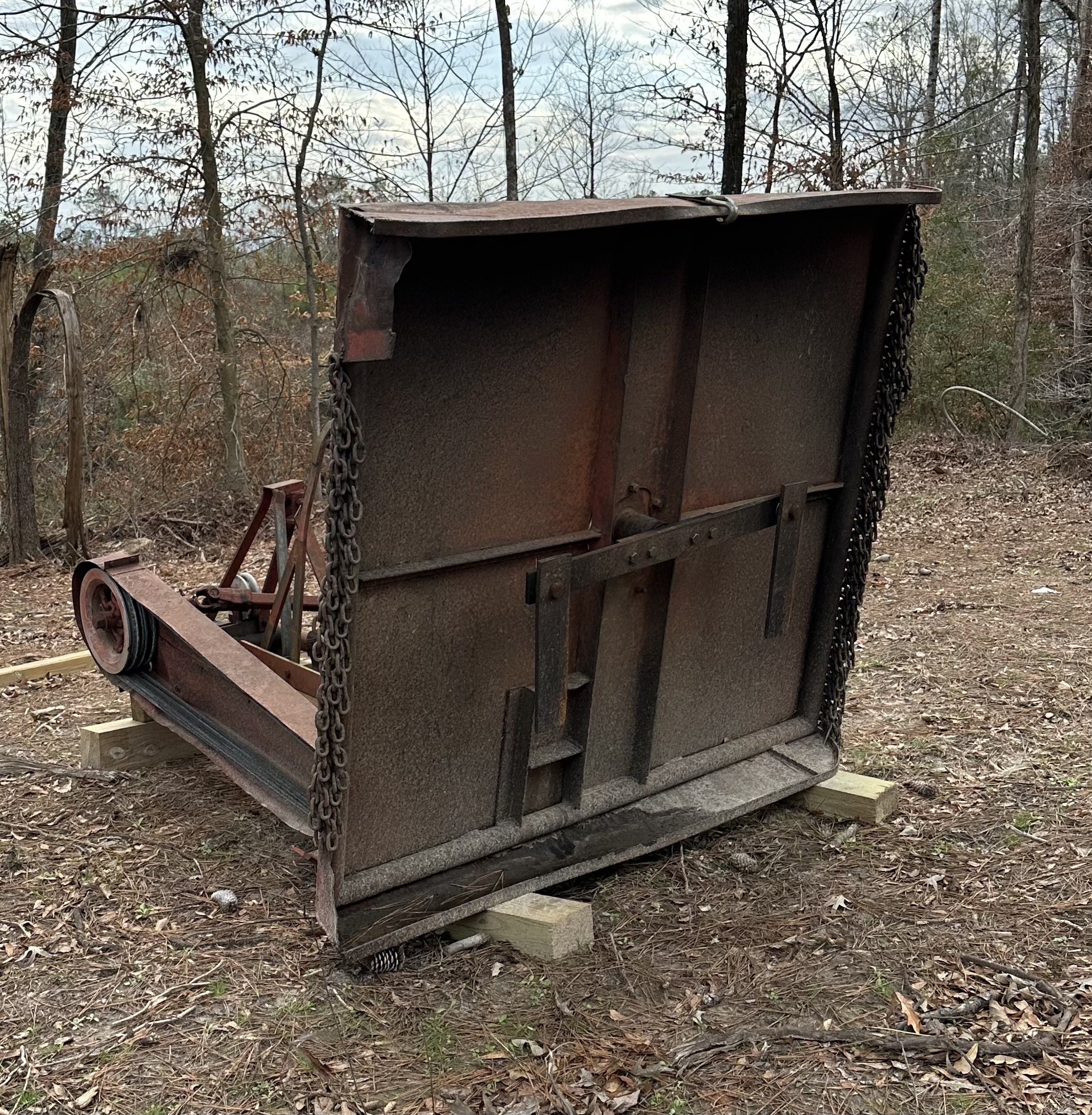

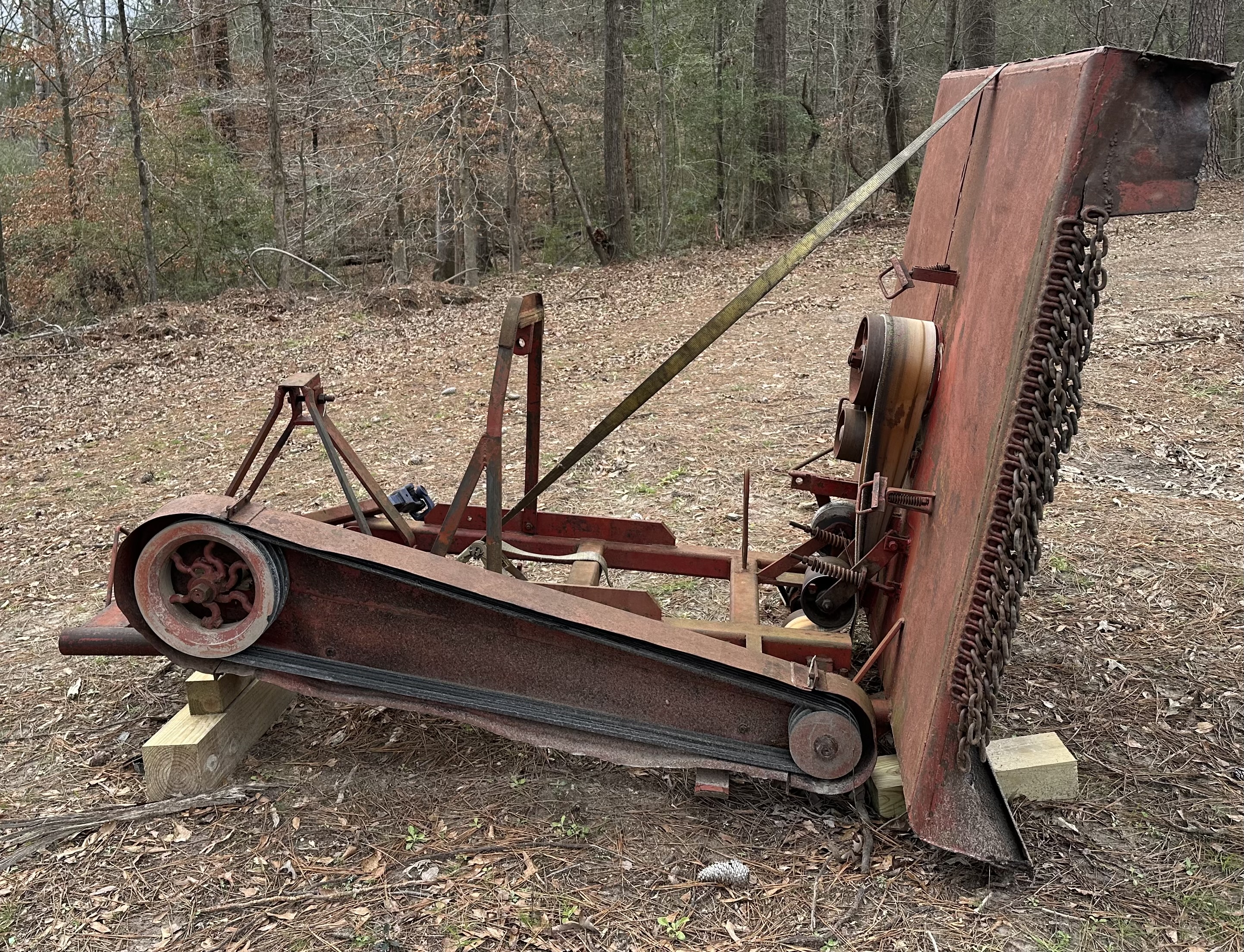

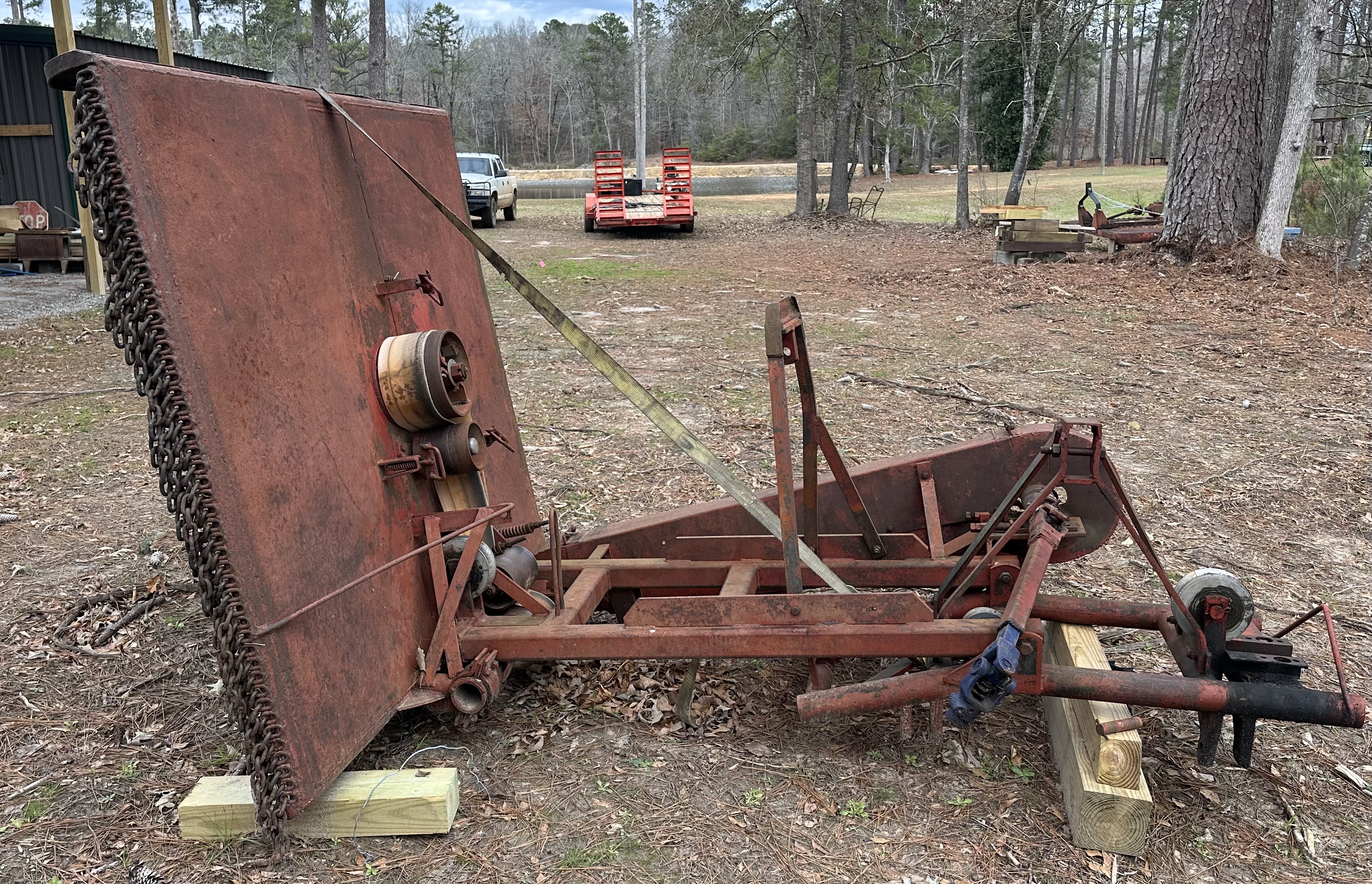

I took a few pictures while I was at the farm this weekend. The hydraulic cylinders are at the shop being rebuilt and the cable has been removed.
Went over the photos ,does seem to be taken care over most brush cutters ,few sheet metal dings . Drive pulley has an interesting design ,caught my eye.

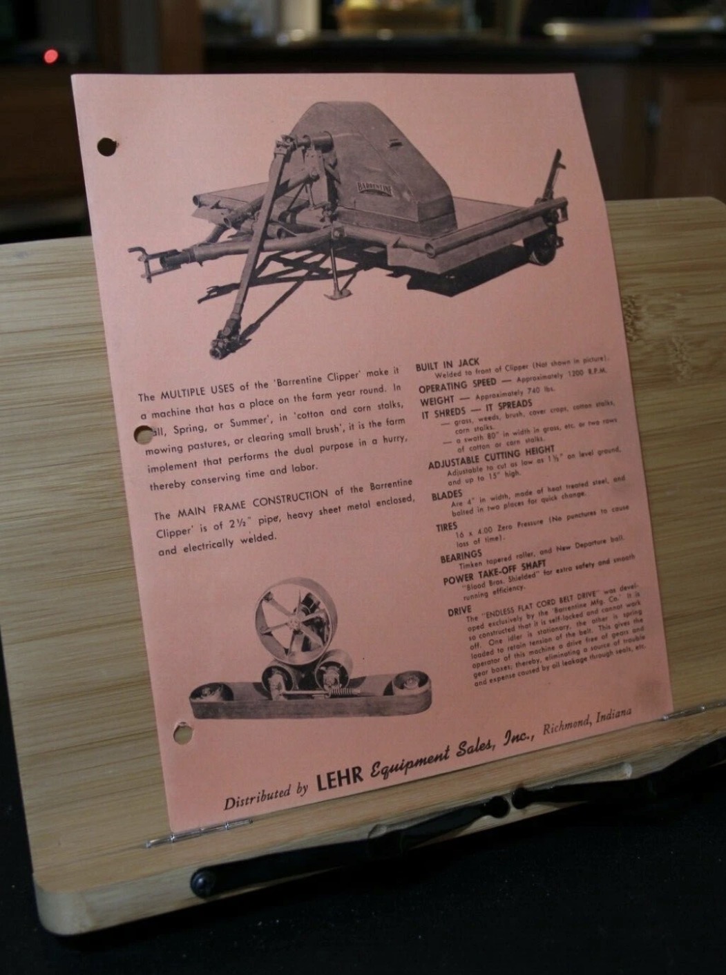

Having a pipe frame looks similar to the Barrentine Clipper, but I can’t find any info on this one. I’ll take out the dents and weld up any cracks or weak spots before I clean it up for paint. I don’t know if I’ll blast it or chemicaly kill the rust before epoxy primer, but I will come back with an IH red paint. The pulley belt was replaced by the previous owner and he showed me how to adjust it…it acts like a slip clutch when adjusted correctly. The MDOT employee I spoke to had no recollection of these cutters.
