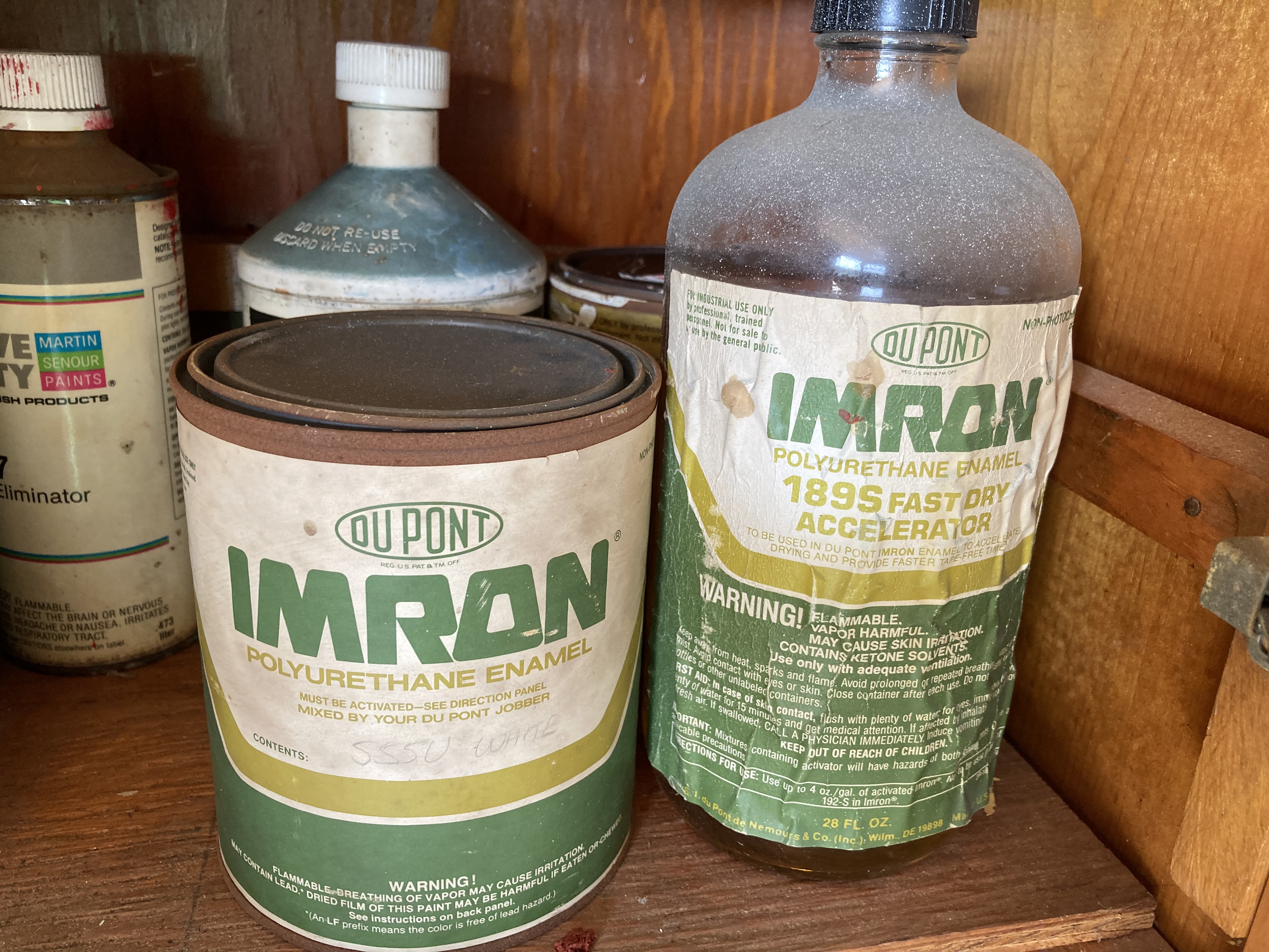

i dont have any activator left, but here is the acceleratori havent shot Imron in a long time. it is a polyurethane paint. durable but not UV resistant. also chemically pretty nasty stuff. you need a tyvec paint suit, nitrile gloves and a supplied fresh air breathing system. it is easily absorbed thru skin. there was an activator and an accelerator used with it.

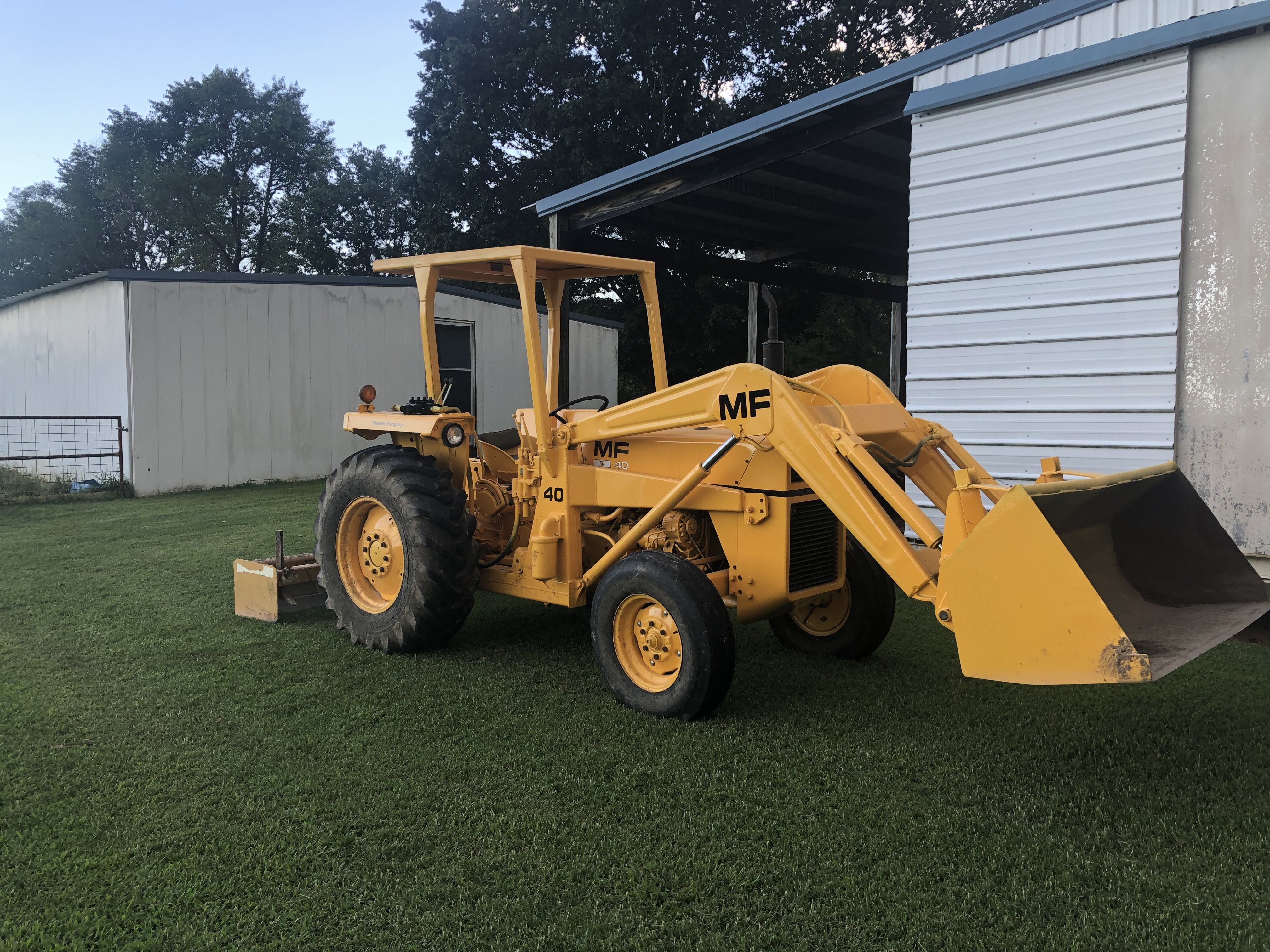

That turned out real nice!I used some of the new Imron awhile back. No issues at all spraying it and it’s held up well. Stuff is so tough it took forever for it to wear of the drawbar from pulling implements.
