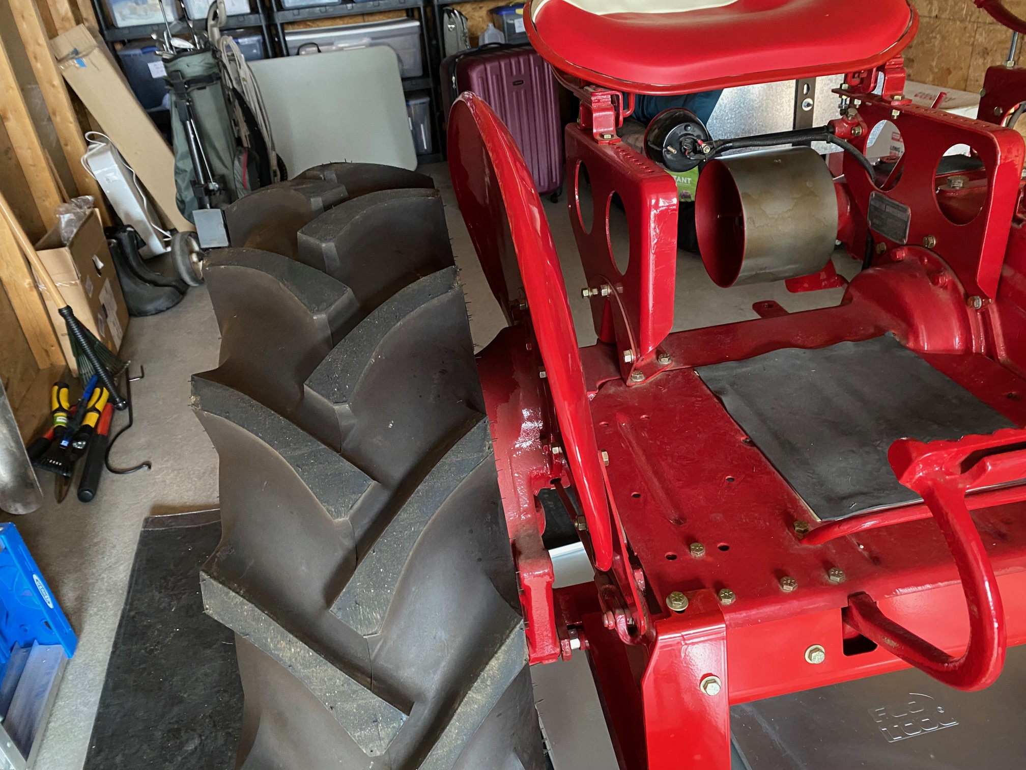

I'll admit I still don't know a lot about my B. I plan to pick up a trailer in the Spring for hauling my B to events that are too far to drive it to. I was hoping to find a car hauler with a distance between the fenders that will accommodate the B rear tire spread. I do have 11.2-24 tires so I'm a little wider just because of the tires. It looks like my rear tire spread is 81 inches but that might not be 100% accurate. I think my B is already at the narrowest possible rear wheel setting. I'm saying this because of the distance from the tires to the fenders. I don't see how the tires could get any closer to the fenders and the fenders are in a fixed position. Looking at the attached photos, am I correct is saying the rear wheels are at the narrowest setting?

Probably so.....every B (6 different ones) we have owned was right at 7ft wide ...they would wedge in between the fenders of most trailers 🧐
take a side shot of the wheel showing clearly the current position of the center disc and the rim lugs, and someone will tell you whether you can make it any narrower or not.

My B is 78 inches from the outside of tire to outside of tire. A standard car trailer is 75 inches between the fenders, 96 inches total width, my B won't go on one. My trailer is 83 inches between the fenders, and is 102 inches total width.
Measure your tractor width, outside to outside of the rear tires. Measure any trailers you might want to buy, make sure you have enough clearance between fenders, or get a deck over trailer. Otherwise, you are making your life harder.

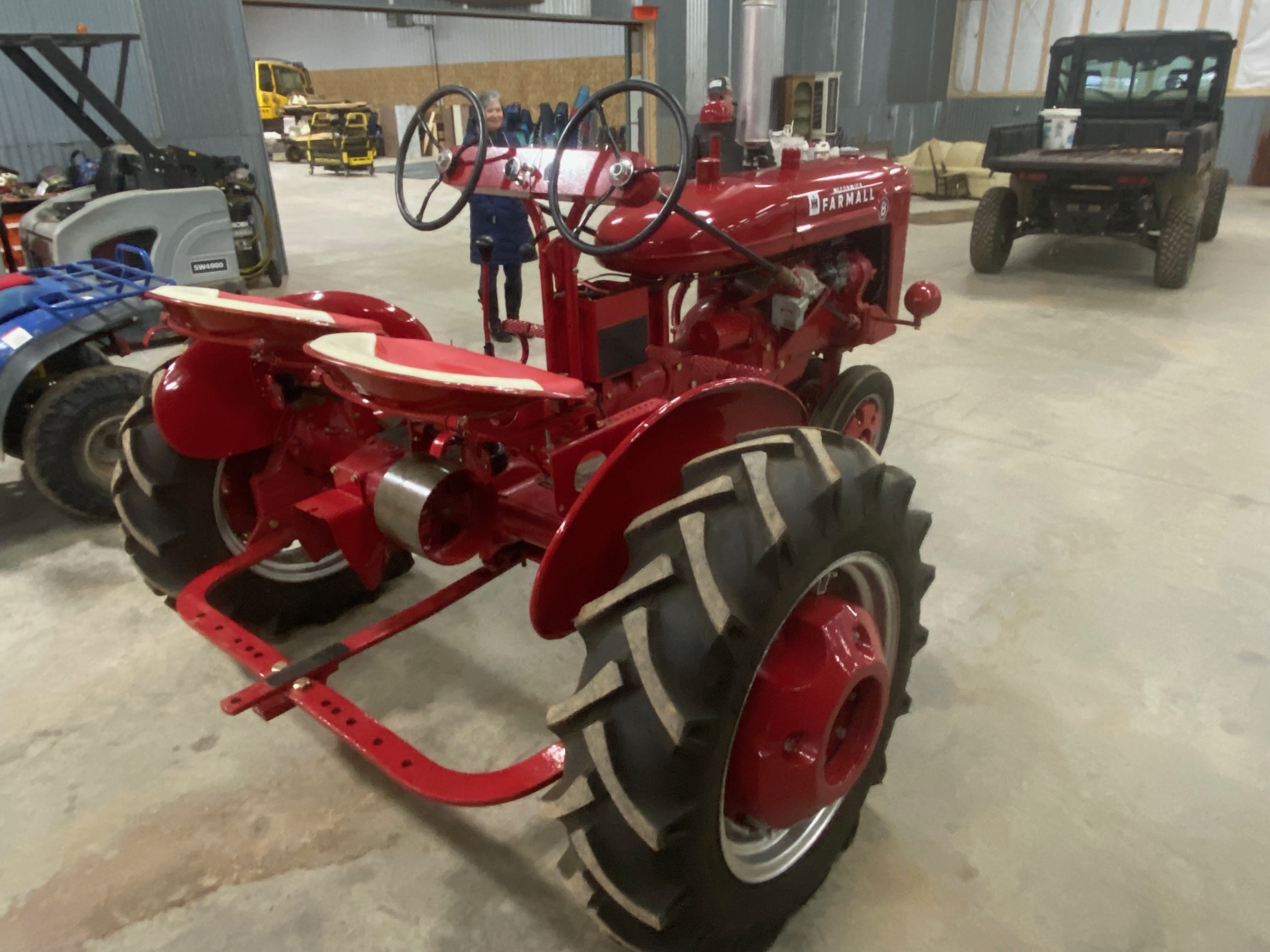

I'm not in the same location as my tractor right now to take a side shot. But will having wheel weights prevent a side shot from telling me what I need to know? Here is one of my file photos. I'll be able to get a side shot in the next couple of days.

Whether your tractor is set as narrow as it can be, is based on how the rims are bolted to the wheel centers. Your pictures do not show that so we can't say. Refer to Grandpa Love's post for the diagram.
You say it "looks like" it's 81". Did you measure it? If not, measure it and be sure. Have someone hold one end of the tape to the outside of the tire, and you take the measurement.
If you can verify the tractor is 81", then look for a trailer with 83" between the fenders. They are common, and easy to find. Take your tape measure with you when trailer shopping, and verify before you buy.

If you can get a straight-on shot of the lug bolts, it should tell the story.
This comment largely ignores the previously mentioned wheel weight problem with overall width. That picture is good enough to see your wheels are currently set for 68". I'm not sure your tire size. If you have 9.5 tires, your overall width (nominally to outside of tires) is 68+9.5 = 77.5. If they are 11.2, you have 68+11.2 = 79.2. Likewise, 12.4 tires get you to 80.4. Resetting your track to 64" would reduce the width to the outside of the tires by 4 inches. This should be possible with 9.5 tires, but probably not with the larger sizes. My best guess is that you have one of the larger sizes. Check for at least 2 inches clearance from your tires to the fenders etc. If the clearance is there, move them in.
Back to the wheel weights. As is obvious from your picture, the overall width is actually to the outside of the wheel weights. If you are just going to drag the tractor to tractor shows, the obvious fix is to take the weights off and quit dragging the extra 300 pounds around. Otherwise, you need a trailer wide enough or with fenders low enough to clear the weights.

My tires are 11.2. It appears I have 4 inches between the edge of the tire and the fender.

What does this tell us Fritz?
From that picture, it looks like you have the heavy wheel option. You already have 300 pounds of added weight before the wheel weights. Your 11.2 tire size in your original post hadn't registered with me. Had I paid attention to that, I could have skipped over my extra comments about other sizes. If you have 4 inches from the tire to the fender, you can reset from 68 to 64 and be under 76 inches over-all. Then you at most will need a pair of 2x12s to handle any clearance issue with the weights.
