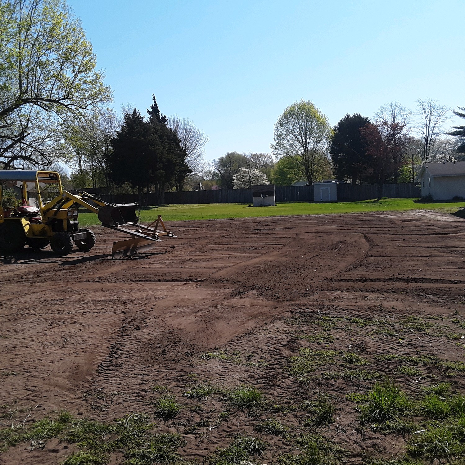

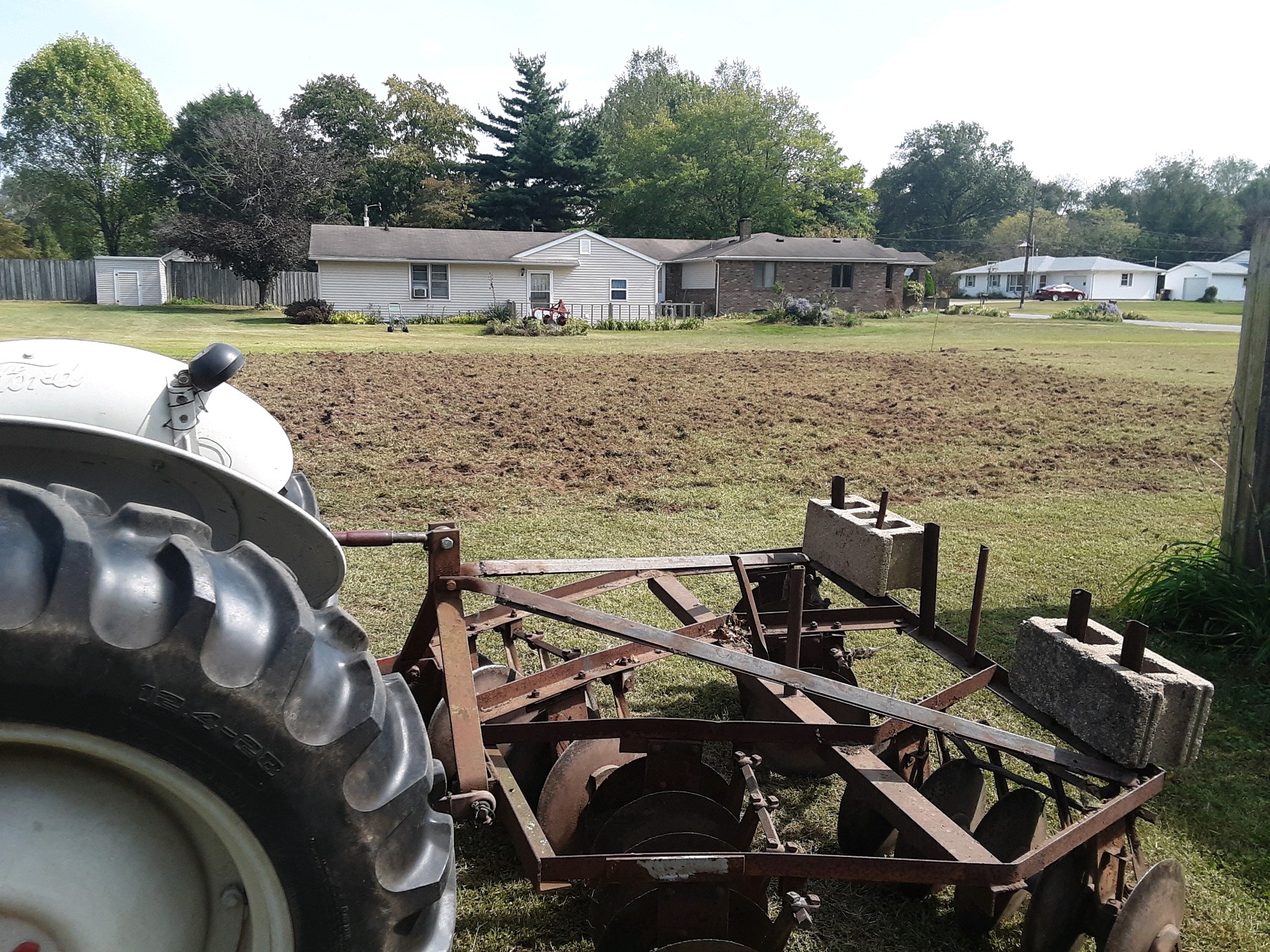

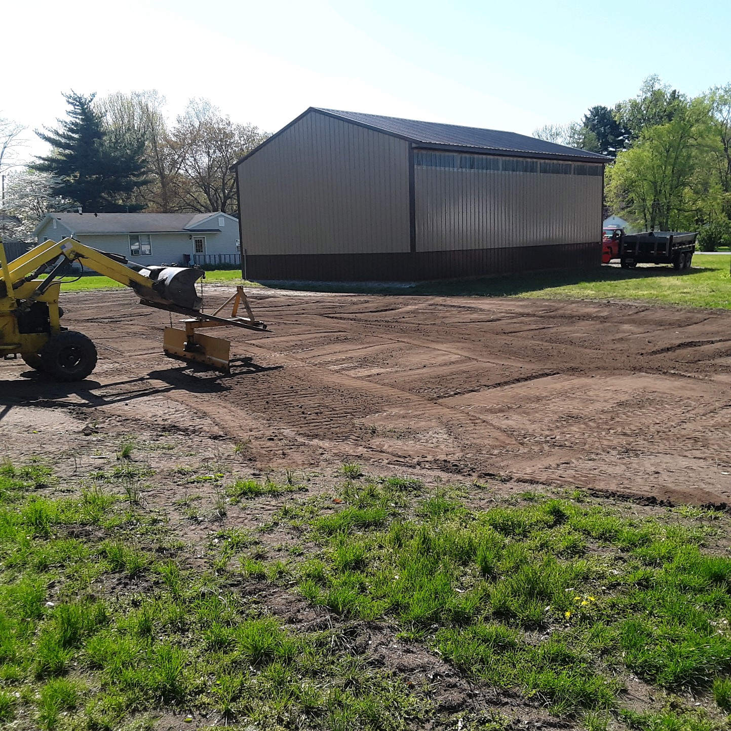

No easy fix. Many times I've had to remove a lot of dirt to make rain water run away from buildings. I had to remove a hill on the north side of my new pole barn. I used a disk to break up the sod. Then
a front loader, Pushed the dirt to a low spot.

No easy fix. Many times I've had to remove a lot of dirt to make rain water run away from buildings. I had to remove a hill on the north side of my new pole barn. I used a disk to break up the sod. ThenView attachment 5825View attachment 5826View attachment 5827View attachment 5827 a front loader, Pushed the dirt to a low spot.
I am pretty sure that the way it is usually done is to bring the ground to a good level with respect to the surrounding terrain before starting construction rather than moving a lot of dirt afterwards. I have hauled hundreds of loads of material to construction projects and that is how it has always been done.
