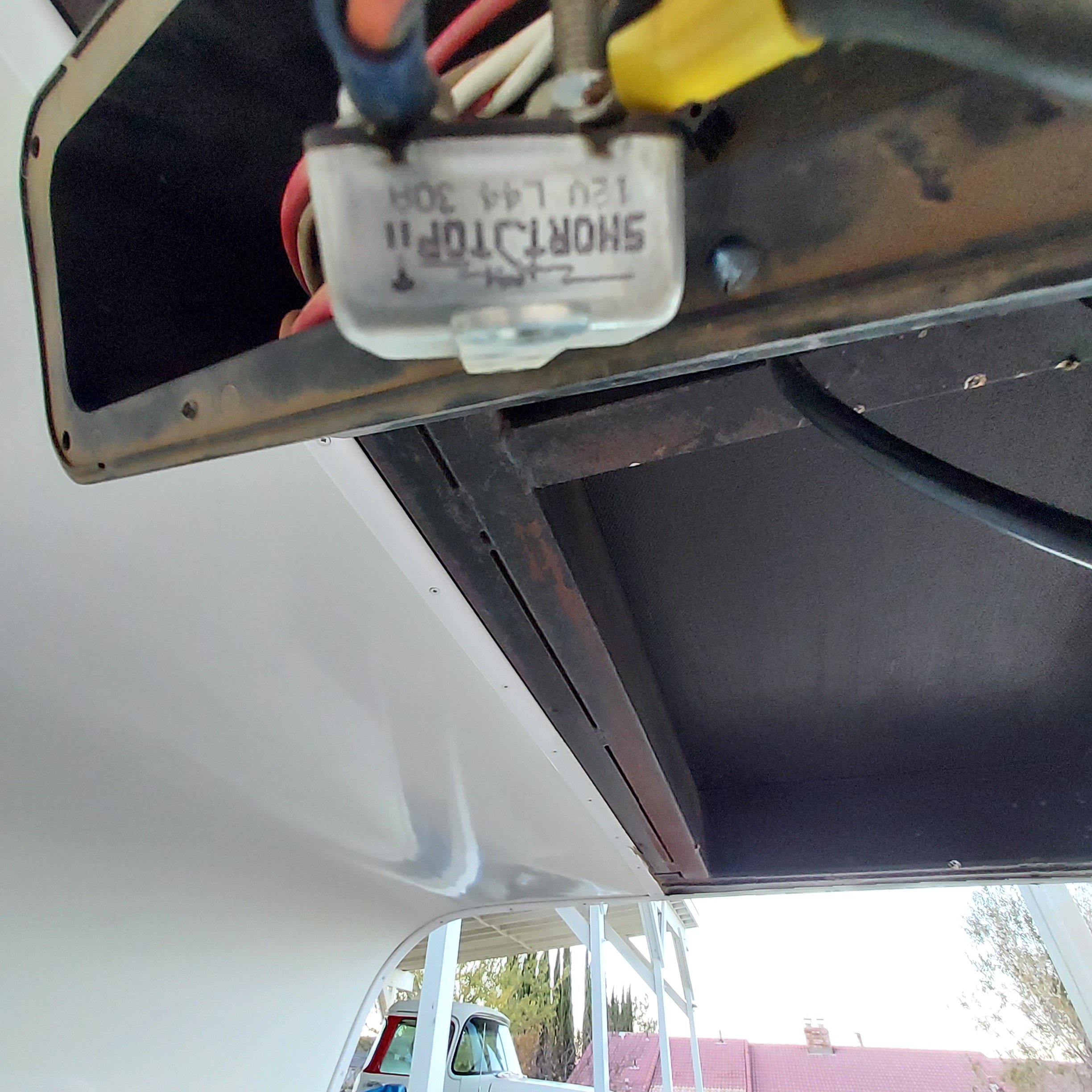

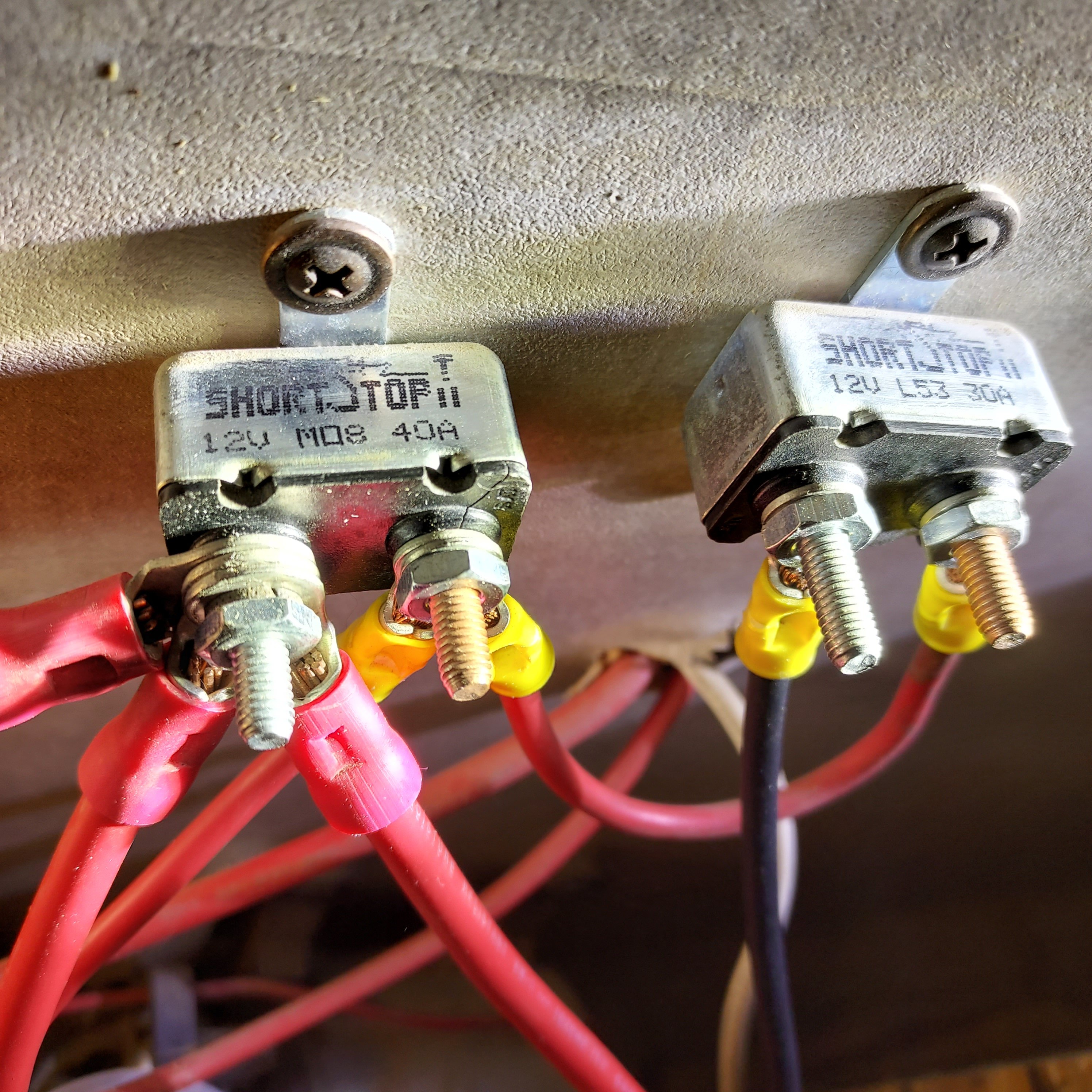

Not sure how I check these here, what I believe are breakers for being still good?
The single one comes from the breakaway switch and the other 2 are in the waterpump comp. Just inbd. of the battery, should have said this in my previous reply.

Not sure how I check these here, what I believe are breakers for being still good?View attachment 94961View attachment 94962
It's unlikely those circuit breakers are your problem. You typically have a circuit breaker on the battery charging line from the tow vehicle, while the other two circuit breakers are protecting high-current accessories, such as the landing gear motor. There probably isn't a circuit breaker between the power converter and the battery, although there should be two large fuses in the power converter's fuse panel to protect against installing the battery backwards.
If you read 12 volts on both sides of a circuit breaker, it's probably good. To be more certain, first disconnect the battery, then remove one lead from the breaker. You should read less than an ohm of resistance across the CB terminals.
Those are Circuit Breakers which are typically auto reset type that OPEN if current exceeds their rating but after a time auto re CLOSE until current may rise to high again. Think of them as a switch which is Normally On/Closed but Off/Open if current exceeds their rating.
PS I sorta doubt those breakers pictured are your problem !!!!!!!!!!!!!!!!! I more suspect a faulty Converter/Charger (it MUST have power be ON and working) or a blown fuse (in or on the Converter/Charger) or a fuse or breaker in the circuit from charger to battery........
To test: 1) If they are to protect the 12 VDC wiring/output of perhaps a Battery or Converter/Charger and its ON and working, there would be 12 VDC on one side and IF On/Closed (NOT tripped) 12 VDC on the other side. Thats a simple easy check using a 12 VDC test lamp or DC Voltmeter SEE IF THERES VOLTAGE (with respect to the Negative) ON BOTH SIDE OF THE BREAKERS !!!!!!! If so they are okay and ON/Closed and NOT your problem.......
2) With their wires removed if On/Closed and NOT tripped, there should be continuity side to side which a continuity tester can verify or there would be near zero ohms side to side if checked with an Ohmmeter.......
As I mentioned above check alllllllllll Fuses, Circuit Breakers, Reset Switches (maybe small red buttons) ON the Converter/Charger as well as wiring FROM Converter/Charger TO the Battery. On some Converter/Chargers the circuit is protected by PLUG IN BLADE TYPE FUSES these are NOT the type you pictured so look for and check any (often typically) blade type plug in fuses right ON the Converter/Charger. In Line type fuses or circuit breakers are often right at the battery and there may be one in the circuit back from the tow vehicle to the RV battery via the 7 pin Round Plug on rear of two vehicle. Look for and check (per above methods) allllllllllllll the breakers you pictured PLUS any inline fuses PLUS any plug in fuses or re set switches ON the Converter/Charger. Those blade type plug in fuses (could be located in/on Converter/Charger or in line using a blade type fuse holder) will have continuity IE near zero ohms side to side if good but an Open circuit (NO continuity) if blown which you can also see by looking inside.
