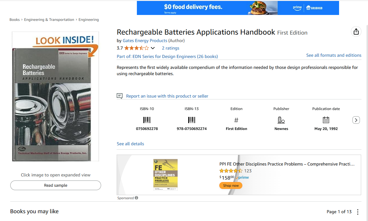

Amazon still sells the applications guide from Gates Energy Products, put out back in the 1990's, that I "teethed" on, as a designer of handheld, battery powered systems. It was, like, a hundred and something pages...
Trying to condense that knowledge into a thread here on YT is a daunting task. I salute you on that one... I will also offer no other advice; because you're asking all the right questions...and any other direction would just confuse the OP.
