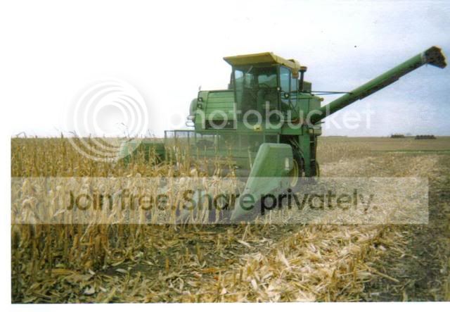

picture of all crop head

In corn as the one picure shows, understand one is running the whole plant through the combine, so it slows you down in corn.
