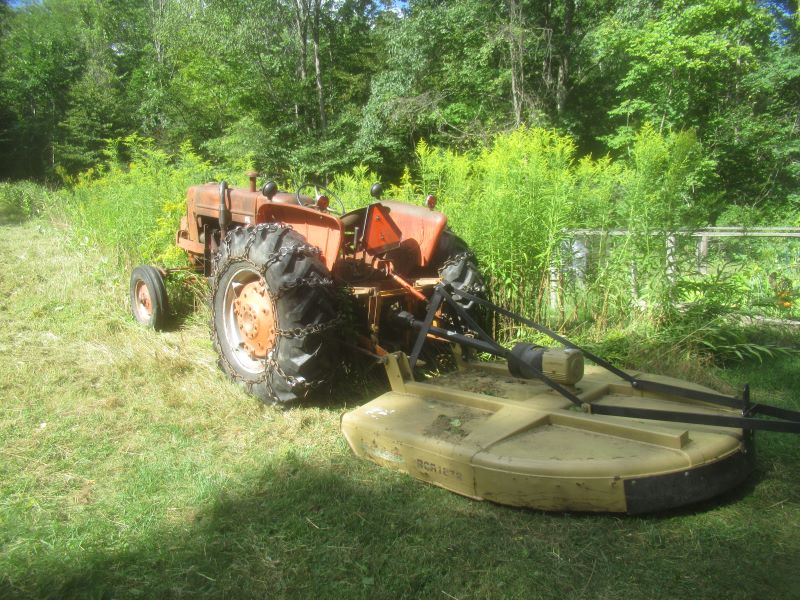

My old 5' Bush Hog Squeeler was fine on the Allis WD but quite a few years ago I got a Series II D-17 Allis which has a LOT more power and I have been wanting to upgrade to a 6 footer.
Never found one at a price I wanted to spend til now.
My wife spotted this on Facebook Marketplace for $600 and I was lucky enough to buy it.
It is a LandPride Model 1872 and is very well constructed. This model is still being sold.
Kubota now owns the company.
Price nowaday
Speeds up the work significant;ly though!
It's in really good shape except the blades have had the he!! beat out of them.
I really have to remove them to be able to sharpen them right.
Haven't been able to break those big ol' nuts loose yet but I'm still trying.
3 Foot cheater pipe on a 3/4" drive socket doesn't seem to be quite enough.
I had a 72" Land Pride mower for about 20 years. You will need a 6' cheater pipe on a 3/4" socket to get those big nuts loose and tighten them again. As I recall, the specs called for 600 lb ft of torque. You can get the manuals for these mowers online at the Land Pride website. Pics show a Kubota M6800 which handled it nicely (62 PTO HP).
