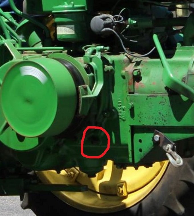

Don't have an H, but if it's like the A's and B's there will be a check plug down below the belt pulley. Screw it out a couple turns. If oil comes out, you're good to go.
Edited to add pic. This is my '42 A. My '36 unstyled A has it on the left side below the flywheel.
Here are the oil level check points. And you should probably crack open the transmission drain plug (swing the drawbar to the side to expose the plug) to drain any accumulated water before you check the transmission oil level - and there almost certainly will be some!
