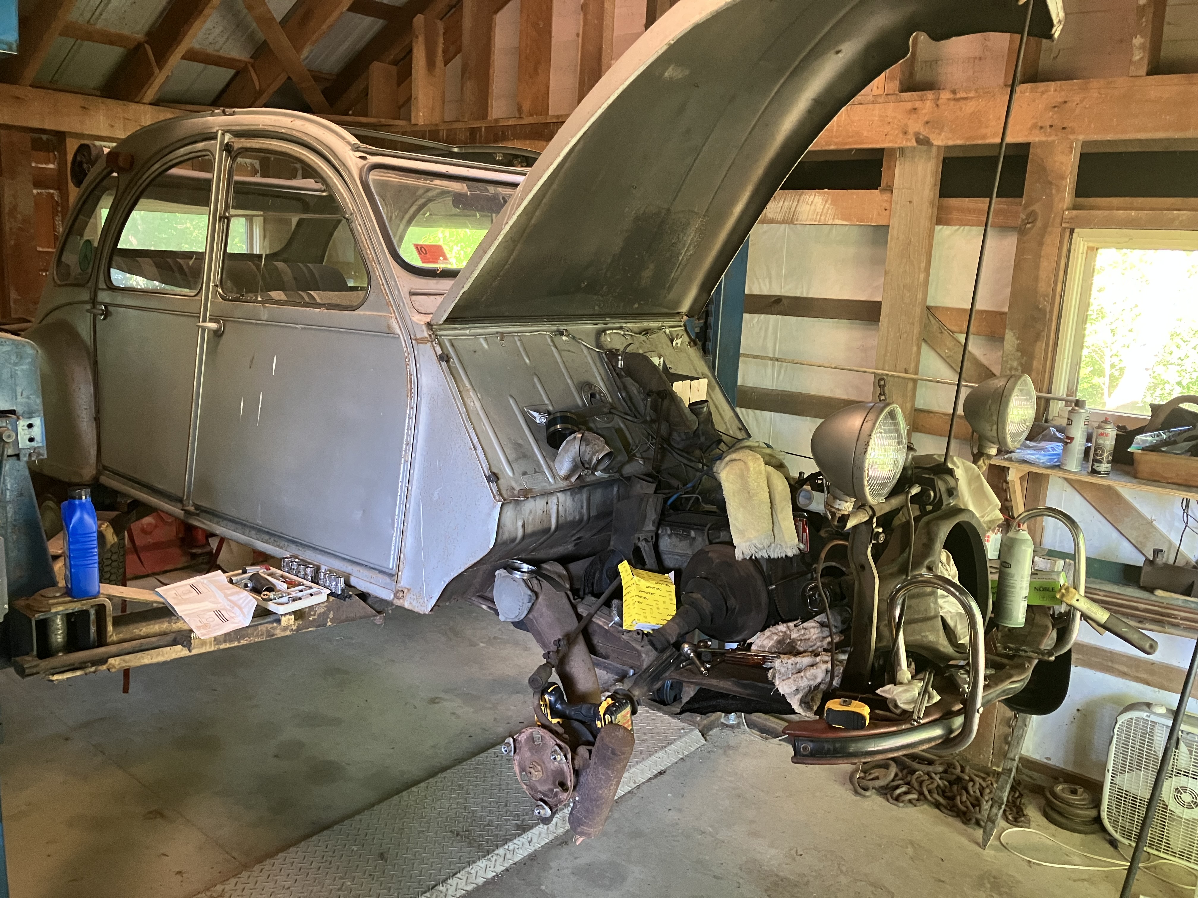

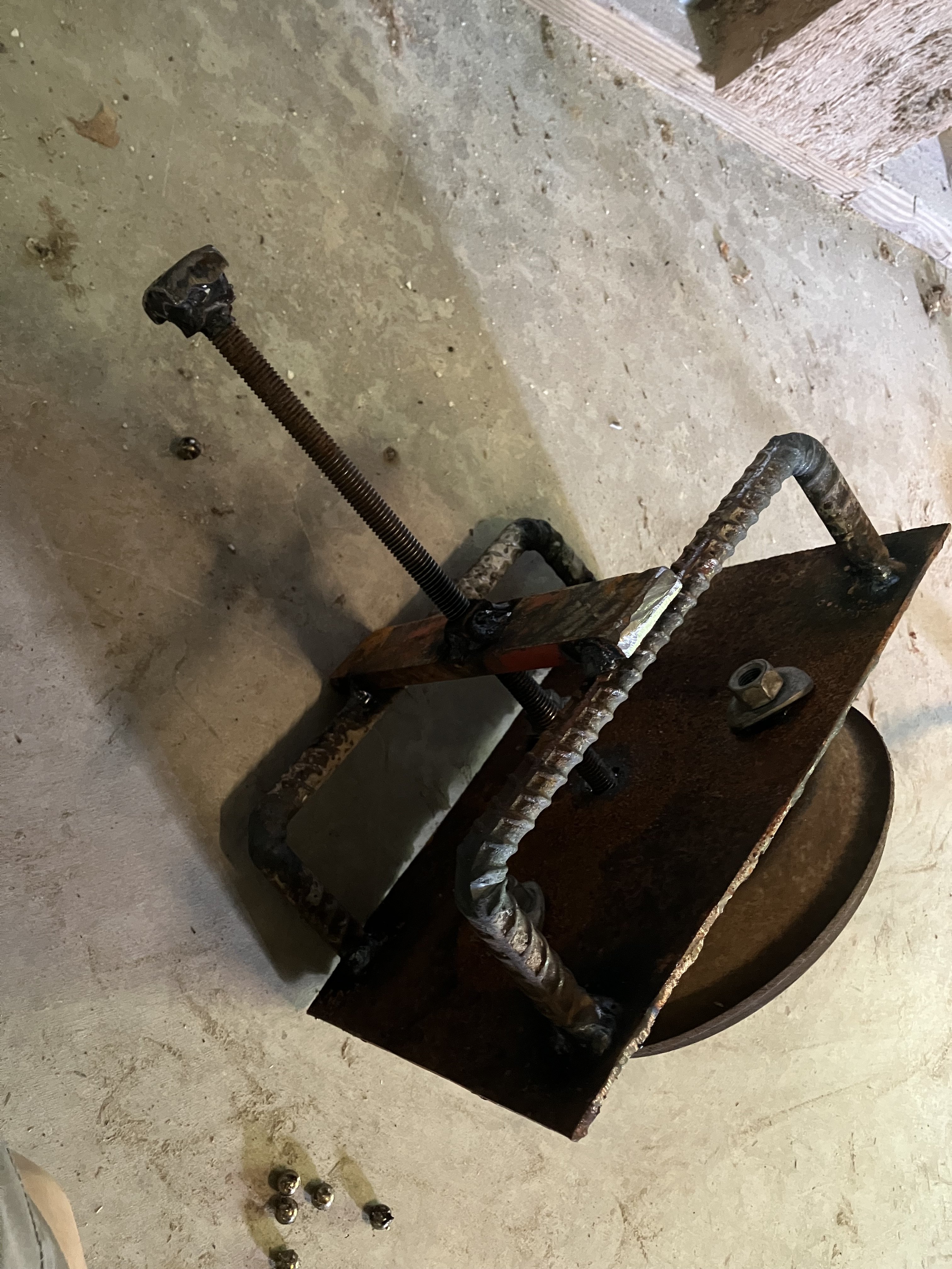

A little show and tell. I have a 1966 Citroën 2CV that I’m hopefully bringing back to life. Rear brake drums were stuck, beating on them didn’t work. Just needed to get in there to inspect the brakes.
This puller I built did a fantastic job. I have to say though that I was cranking so hard on it for so long that I felt like the drum was going to come flying off when it finally broke free. Fortunately that didn’t happen. I did stand clear, however.
THREE lug nuts hold the wheels on. Yes, three. And a hub nut holds the brake drum. It gets torqued to about 250 ft lbs.

First: great job on "make a tool". Second: a 2CV is not exactly run of the mill and congratulations on having one. I'm looking forward to updates.

I’ve been looking for a while, finally found one locally for money I was willing to part with. Definitely a project. I have the cylinder heads back from the machine shop and also put in new piston rings. The motor was tired, but overall in good shape. If I come across a 602 cc engine I’ll probably do a swap. Mine has the 435 cc motor, I’ll be sure to stay off the interstates.
gees, if it took that much pressure, is the drums salvageable? Usually when they are hard to get off the shoes have worn a groove into the drum.
Brake shoes looked almost brand new. The drums on these cars are notorious for being difficult to remove and are often stuck. Possibly because the hub nut is torqued so tight? Not a matter of just undoing the lug nuts and sliding the drum off. I’m learning as I go along.
I've got the old style hub puller made to pull drums and hubs like on an 8N or old Mopar. It's the HD one that you can hit with a hammer to turn. Usually they will lend you one at AutoZone.
