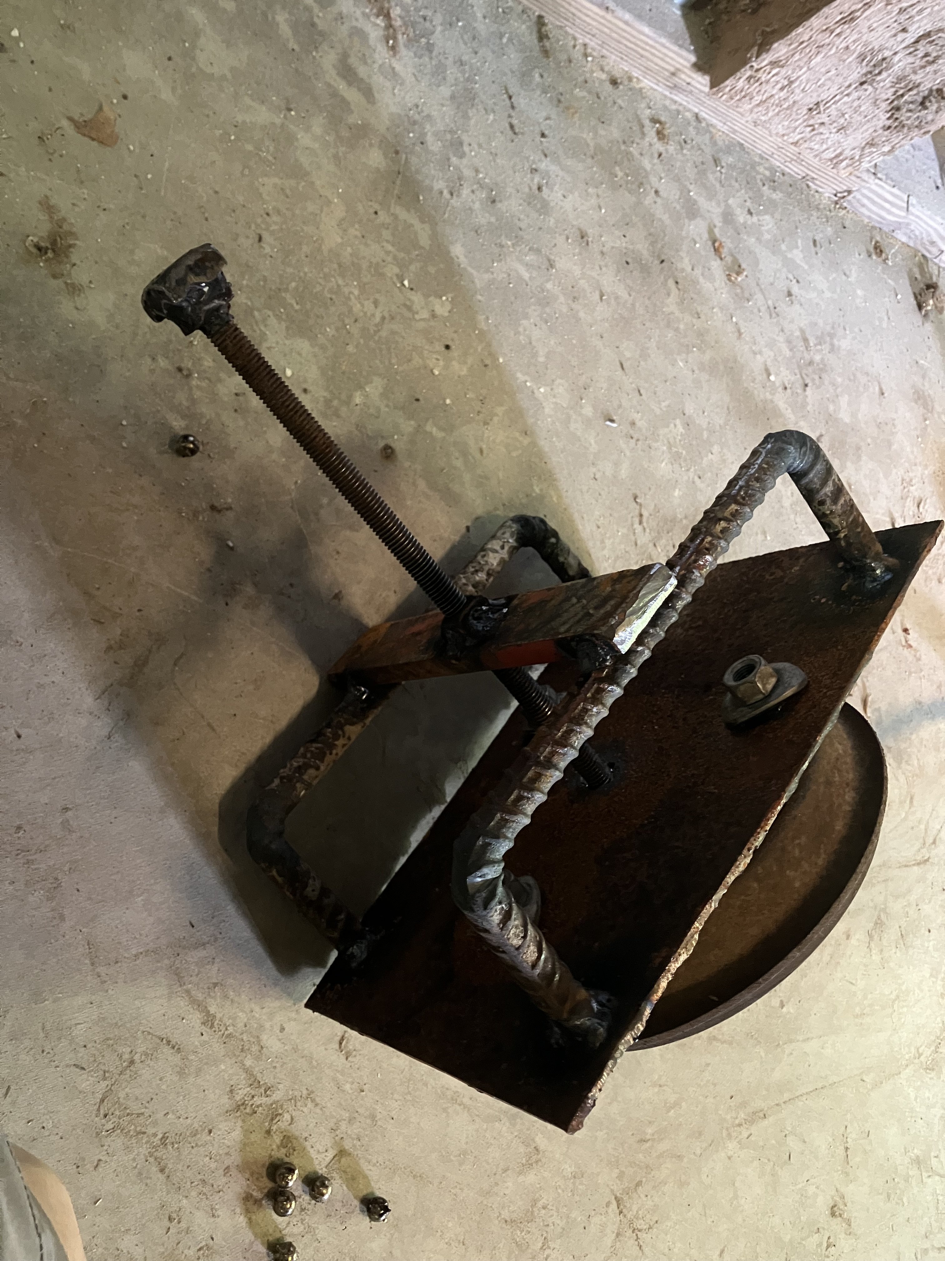

Thanks, it evolved because I was just going to attach those rebar handles and yank on the plate thinking that would work. I would have pulled the car off the lift before the brake drum would budge based on what others were telling me so I made a real puller since I had all the parts and I can always use more welding practice.When I make a tool I make it fast and do not care about the looks Nice job

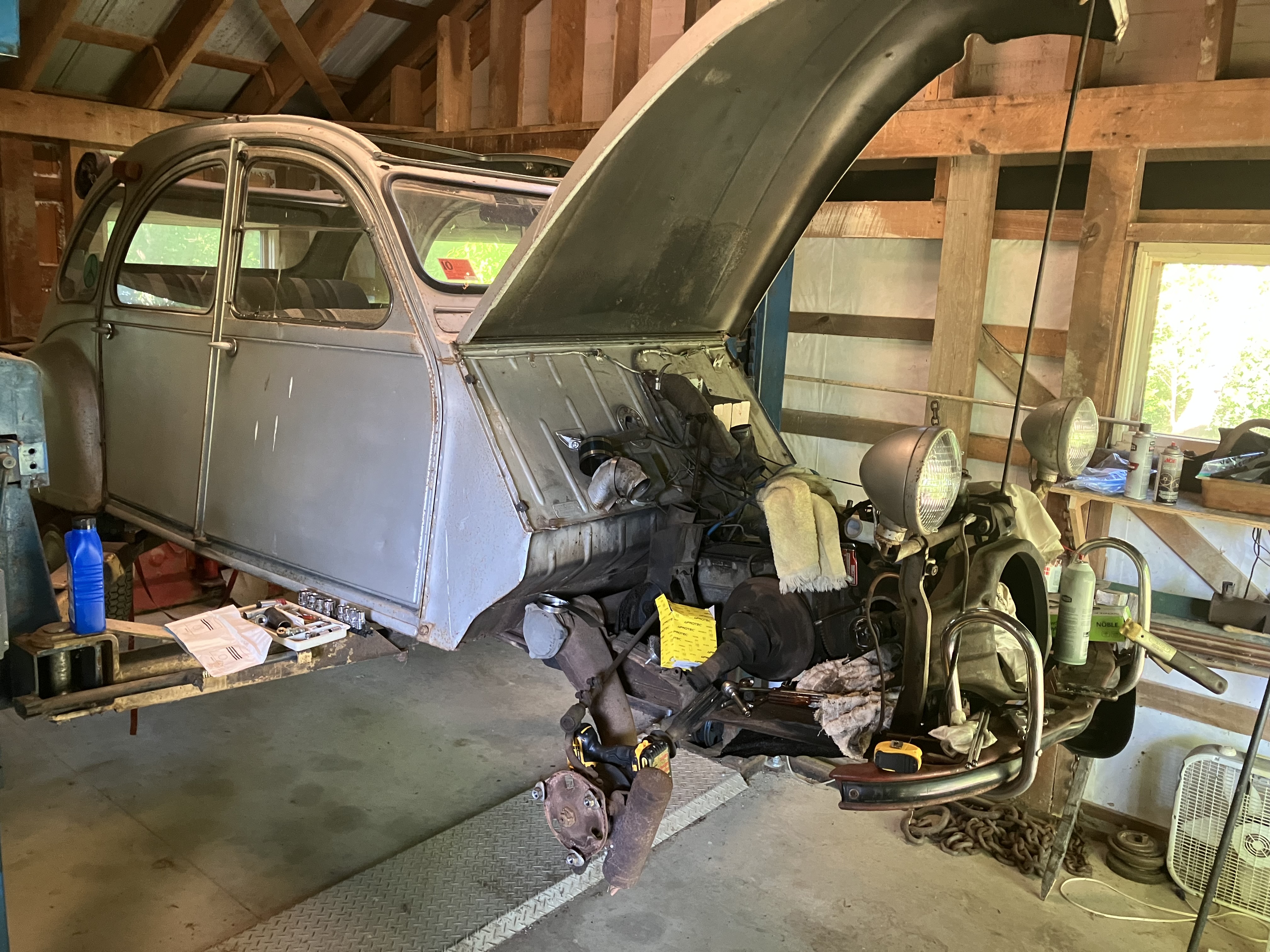

I spent time in, France / Spain / Switzerland , June,1974. Your Vehicle brings back great memories,as well as the Citroën DS. while having lunch on the Avenue des Champs-Élysées.A little show and tell. I have a 1966 Citroën 2CV that I’m hopefully bringing back to life. Rear brake drums were stuck, beating on them didn’t work. Just needed to get in there to inspect the brakes.
This puller I built did a fantastic job. I have to say though that I was cranking so hard on it for so long that I felt like the drum was going to come flying off when it finally broke free. Fortunately that didn’t happen. I did stand clear, however.
THREE lug nuts hold the wheels on. Yes, three. And a hub nut holds the brake drum. It gets torqued to about 250 ft lbs. View attachment 154834
