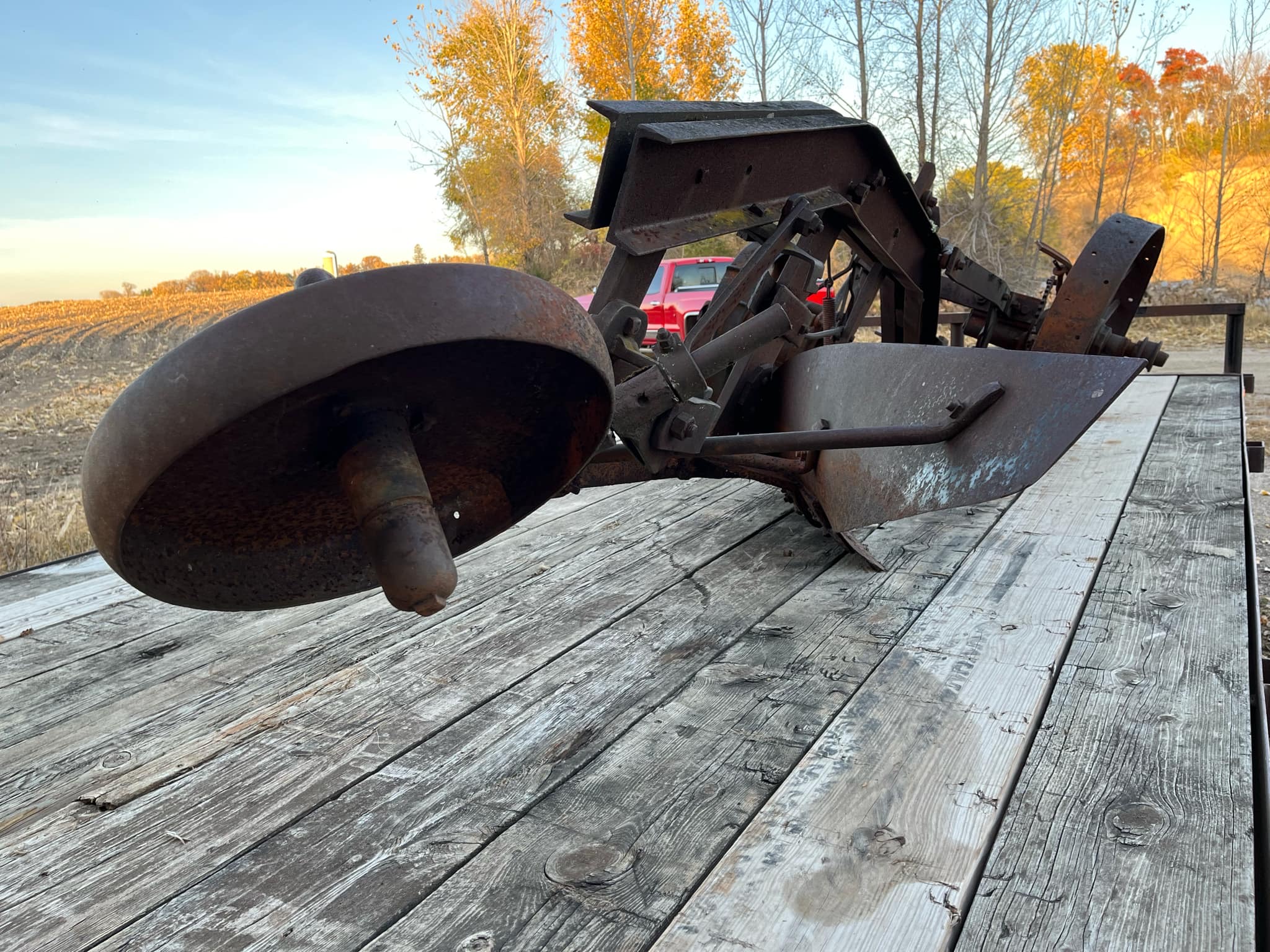

I have 3 casting numbers from it, but I don't know where to look.Hopefully you can find some cast parts with part numbers that will help to identify the manufacturer.
List the part numbers. Maybe someone can help. Google the part number; that may help as well.I have 3 casting numbers from it, but I don't know where to look.

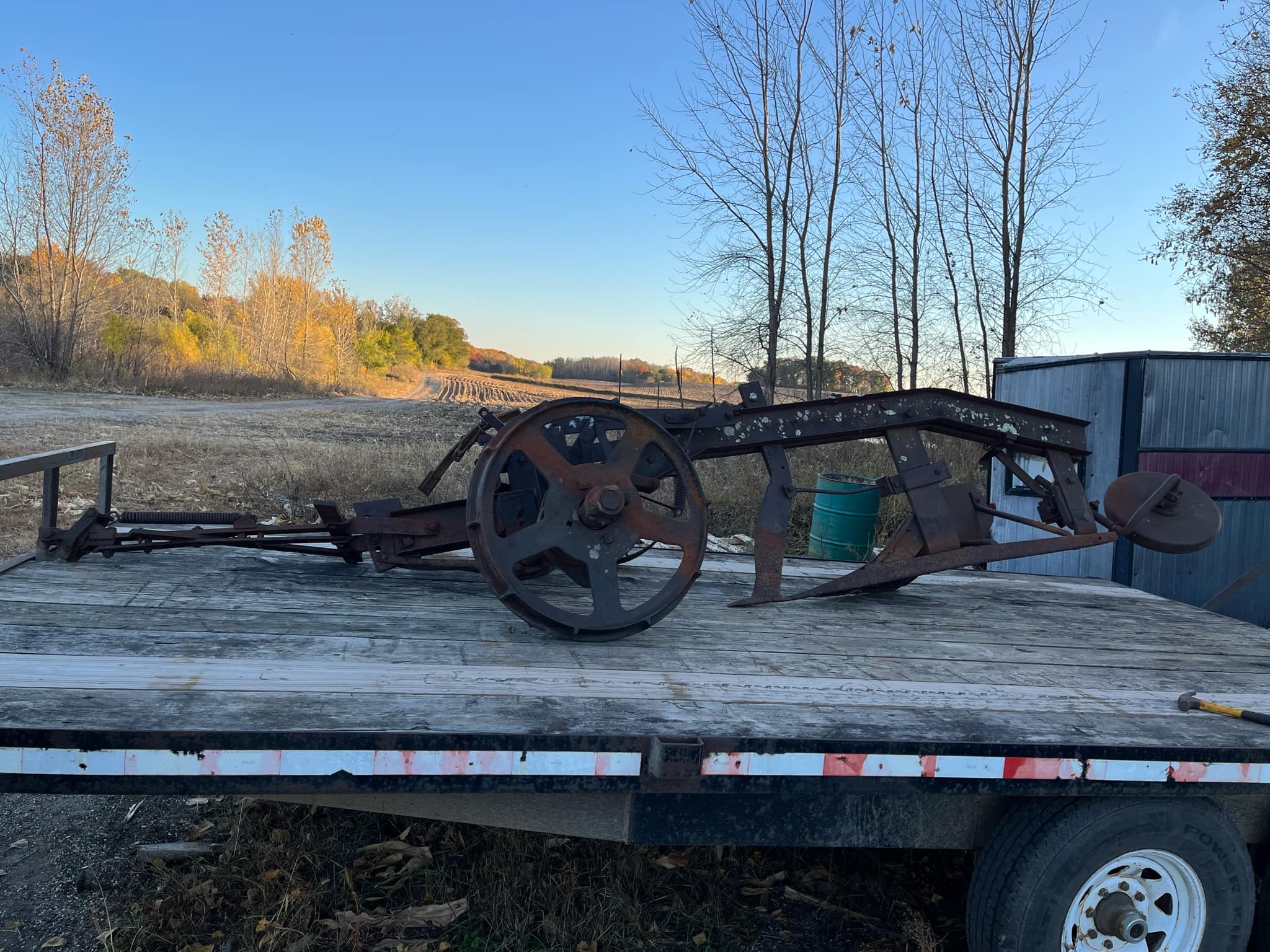

That is quite a rig!!! Never seen anything like it. Probably not used around here but maybe in the eastern or southeastern part of the state.Picked up this Brush Breaker. Does anyone know the brand and model, years it was made? Thanks for any information on it.
Lift hub part no. EXP746, Hub clamp holds lift wheel on part no. EXP143, casting that holds tailwheel shaft part no.GX66, inner sand cap for lift wheel part no.P66, tailwheel inner hub part no. G173. Hope this helps.List the part numbers. Maybe someone can help. Google the part number; that may help as well.

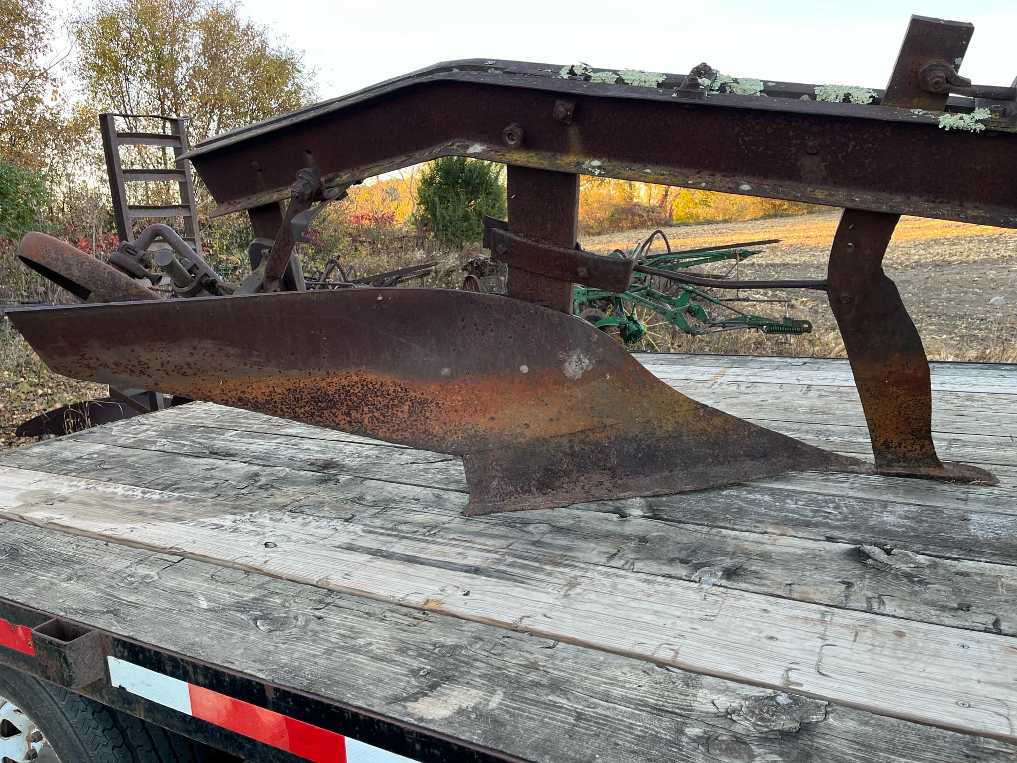

Kinda thought that.Don't know who made the plow but it definitely has a Little Genius tongue and hook .
Picked it up in northern MN.That is quite a rig!!! Never seen anything like it. Probably not used around here but maybe in the eastern or southeastern part of the state.
That was for cuting roots when plowing brush.It has a sub-soiler instead of coulter in front of the plow-point, now that will turn hard ground, even blue shale if you have enough tractor to pull it.
