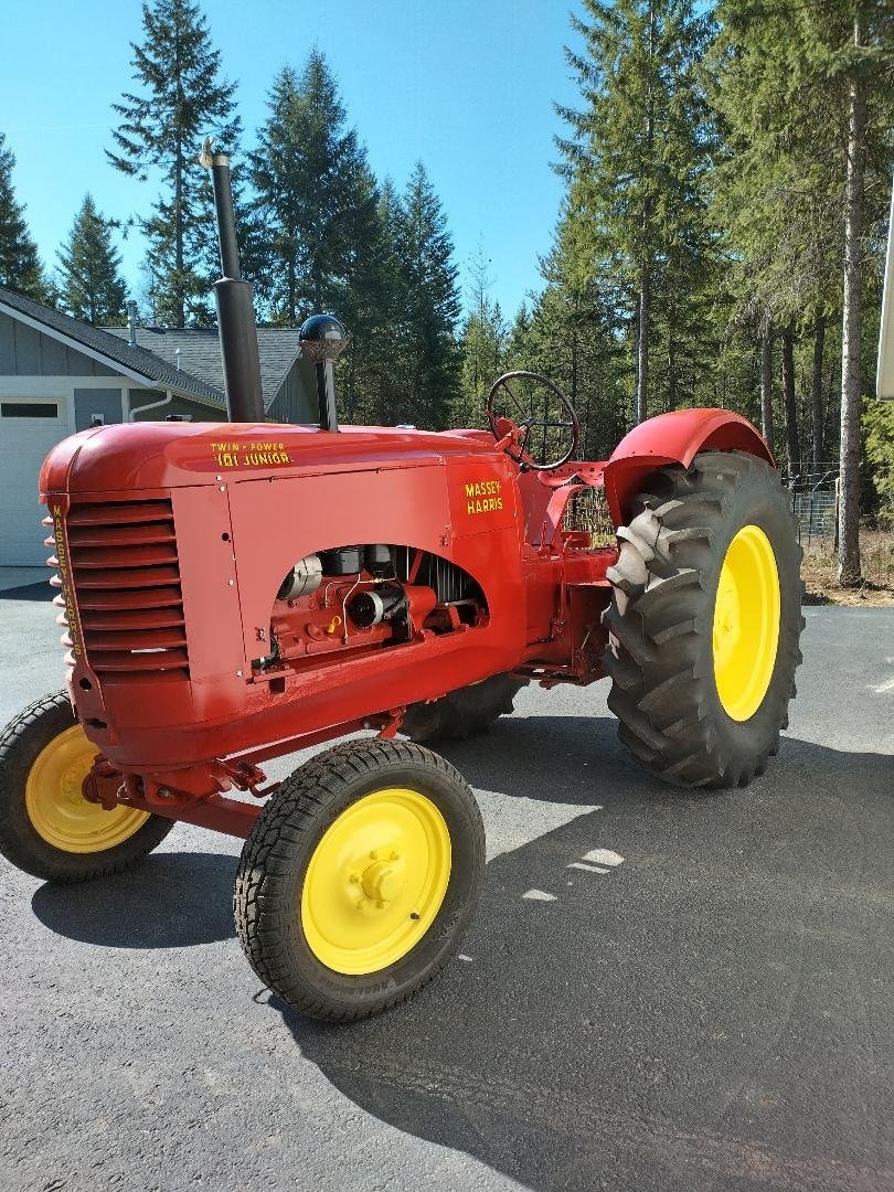

Every single one of these were brushed and rattle can painted. I would challenge anyone to find a single brush stroke on any of them. Prep is most important. We brush the cast and rattle can the sheet metal. Sheet metal gets 10-12 coats of spray paint, so it's thick and shiny. A couple coats will not last.
