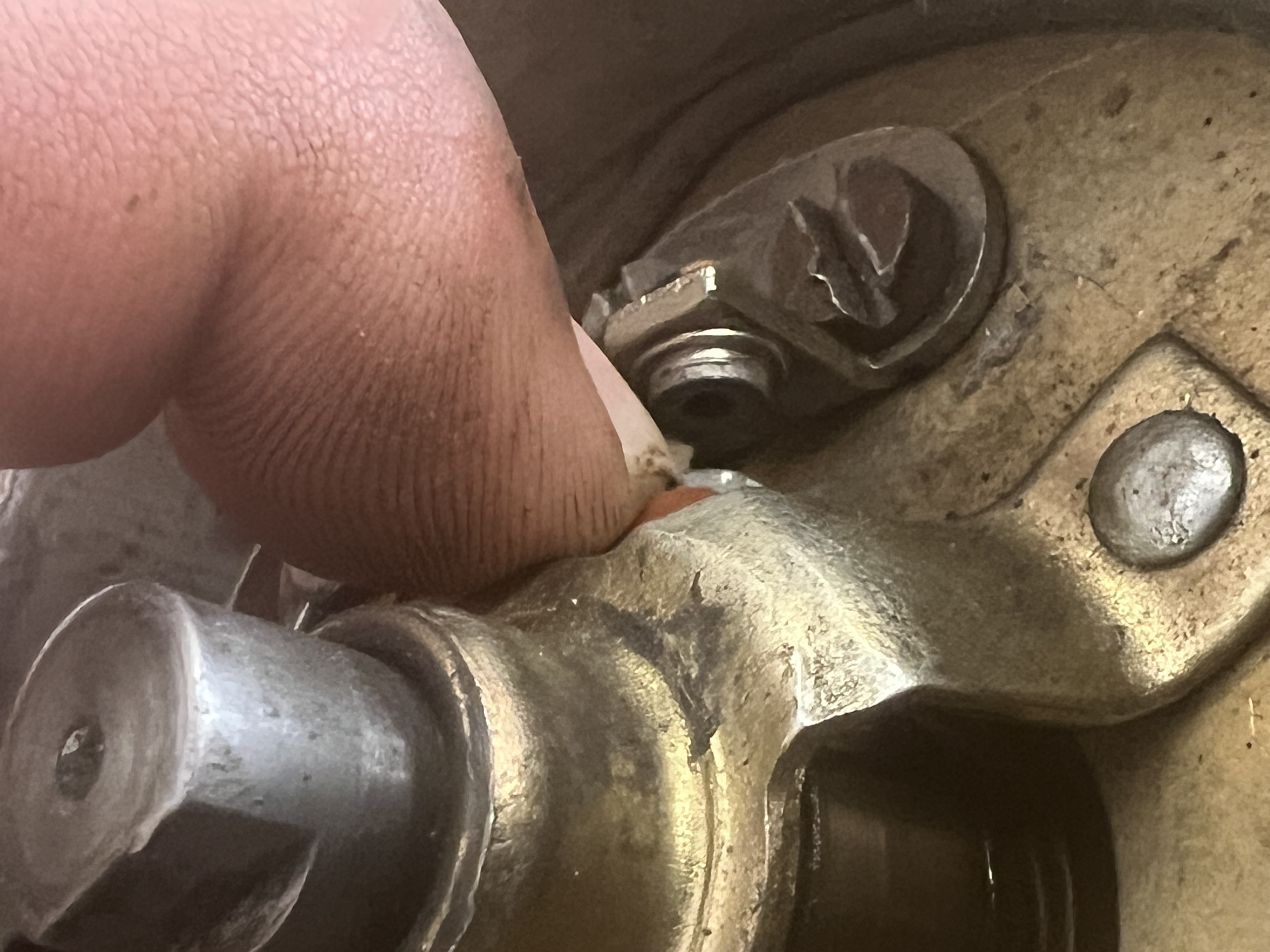

Is this what bad points look like? Left the ignition switch on by accident last night on my 2N and have quickly learned it has caused an issue. My issue im having now is no spark. Should I change the points and condenser?

Yes good chance you now need new points and good chance you will also need a new coil since leaving the key on cause both to over heat and burn up or as some say you have let the smoke out of both
View attachment 6164Is this what bad points look like? Left the ignition switch on by accident last night on my 2N and have quickly learned it has caused an issue. My issue im having now is no spark. Should I change the points and condenser?
If it were mine, I would rotate until points closed (on flat of cam) then turn on ign and open & close points with insulated 'stick' or screwdriver and watch for spark at points opening/closing. If none, clean/scrape/file and try again. This may at least tell you if coil is still alive.
Hard to do on a front mount distributor. Easier to do on a bench with a multitester.
I would just run a points file through them and reset the gap. You will be good till the next time you leave the key on 🔧

Run a points file through the points and clean them up, yes a points file is a real thing. No points file use a nail file or a piece of fine sand paper then clean it all.

His do have holes. The ones I put in my old Fergie last summer have two completely flat contact surfaces.
I took your post to mean that you say all point sets have the corresponding "donut" holes.
I may have misinterpreted your post due to lack of clarity.

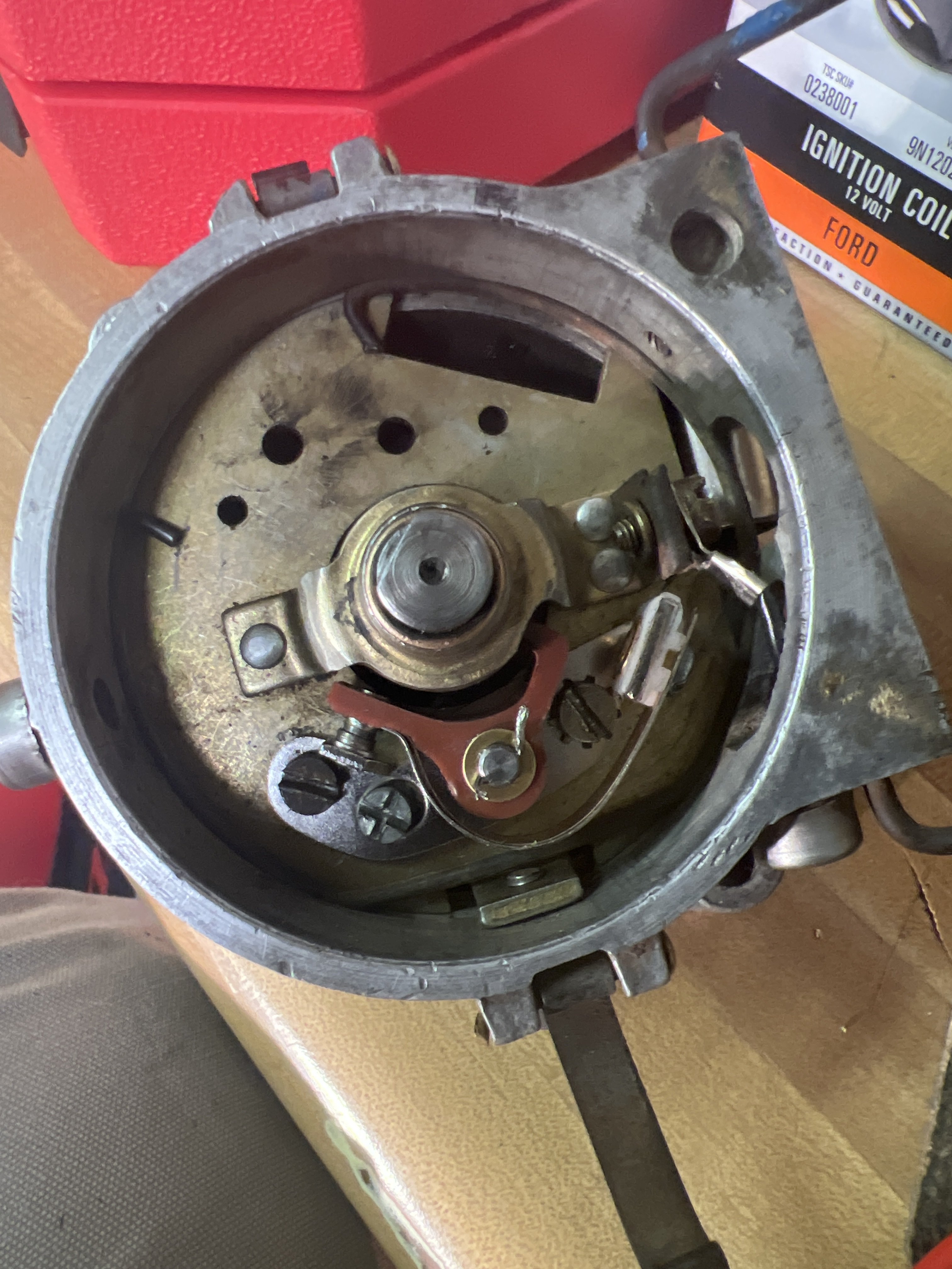

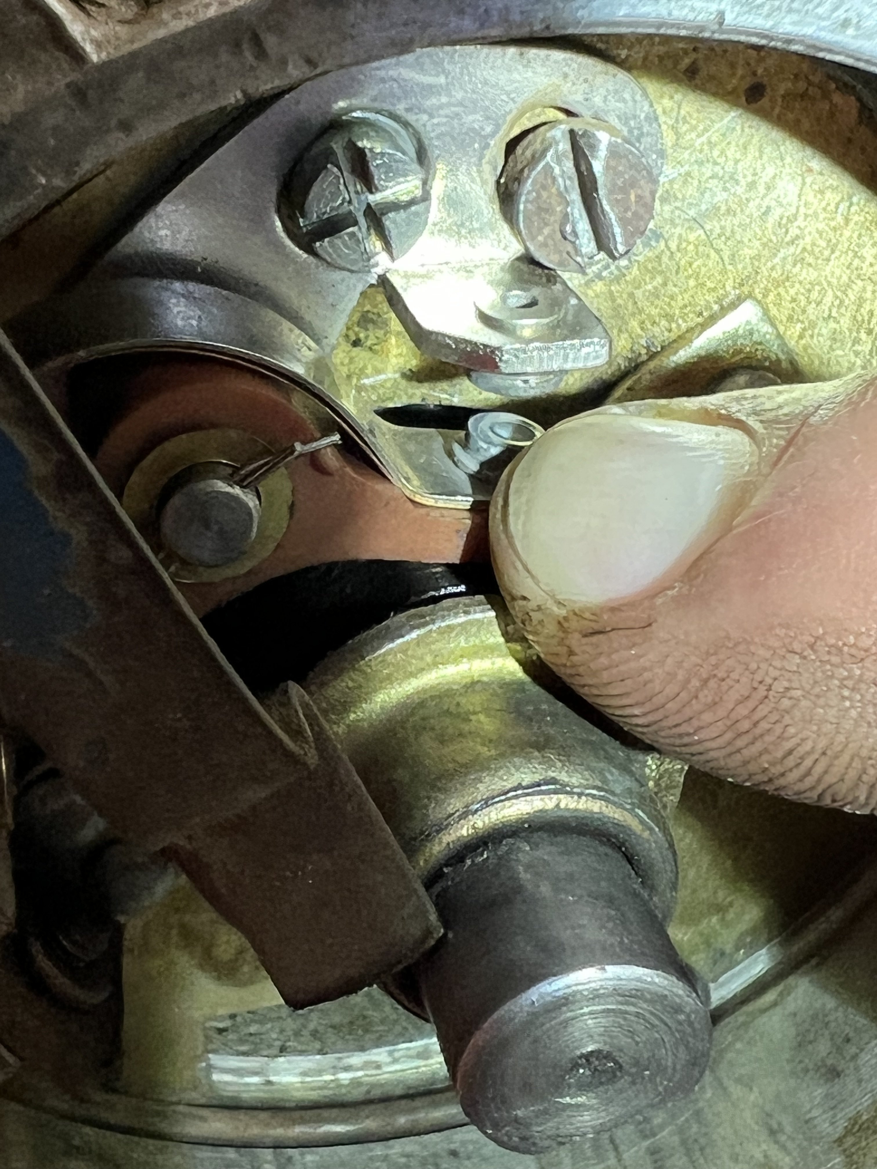

so I got this distributor back off. When I’m checking for continuity from the brass screw to the body of the distributor I’m getting nothing with the points closed or open. I attached a picture of it incase you see something obvious that’s wrong.

The copper strap "A" appears to be missing, therefore no connection from brass screw ( G ) to points (F ).
