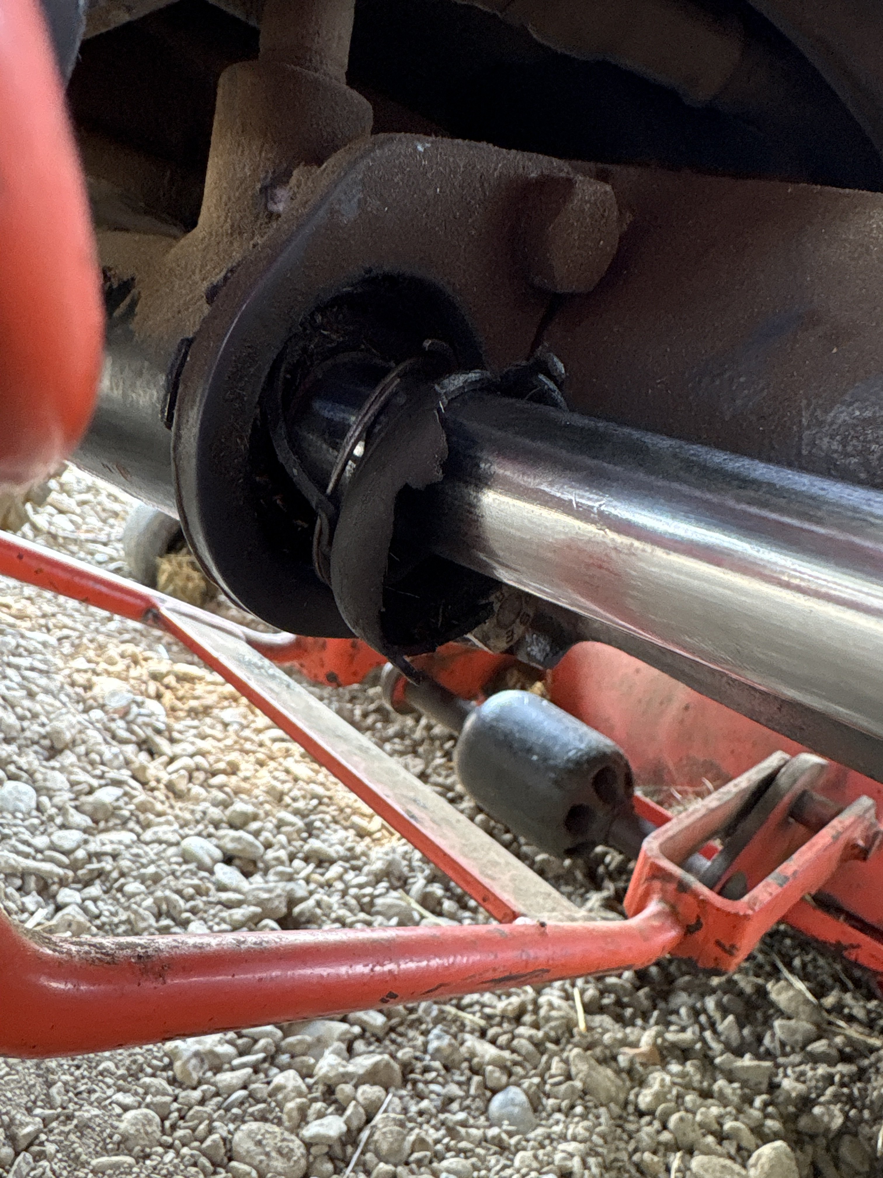

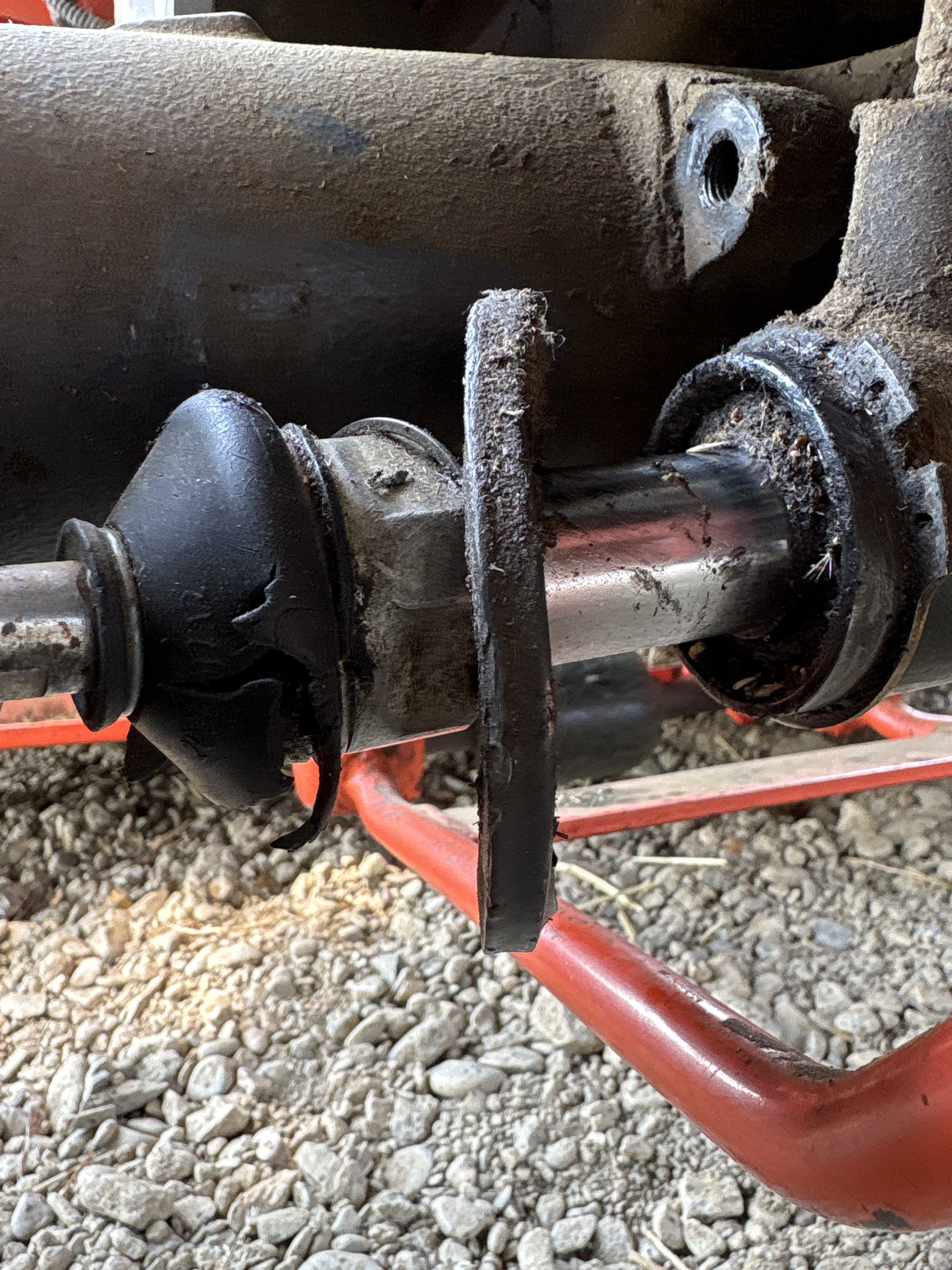

P.S does anyone know how to put the steering cilnder back in its brackets? Popped it out mowing the ditch.

Look at Messicks Website, https://messicks.com/ it appears that they have both the fuel pump and starter in stock. As to the steering cylinder, if it is out and both of the retainer plates are still in position, remove one of the plates, put the cylinder back in position and reinstall the plate. After you get everything back in position, check the bolts periodically to make sure they stay tight. The only problem you may have is if either of the retaining plates are bent, if they are you may need to remove the tie rod ends, remove the plates, straighten them, and then reassemble

The bolts on the right hand side were not tight at all. Got them off by hand. The brackets, again the right hand side is bent.
