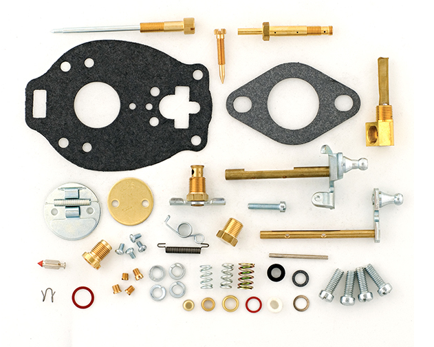

I'm rebuilding the carb on my '43 2N, a Marvel Schebler TSX 241, with the kit I bought at Yesterday's Tractors.
The kit does not come with new seals for the choke and throttle shafts, are o-rings sufficient for these?

The more complete kits sold here have the packings and the retainers.
That looks like what they call the comprehensive kit, #182486.
I don't know why I didn't see that when I bought my kit, I got the complete kit, #112445.
Thanks, I'll get one ordered.

After looking at the pictures for the above supplied part numbers I think my kit has the seals and retainers.
Who ever was into this carb last installed them in the wrong locations, which is why I didn't think I had them.
