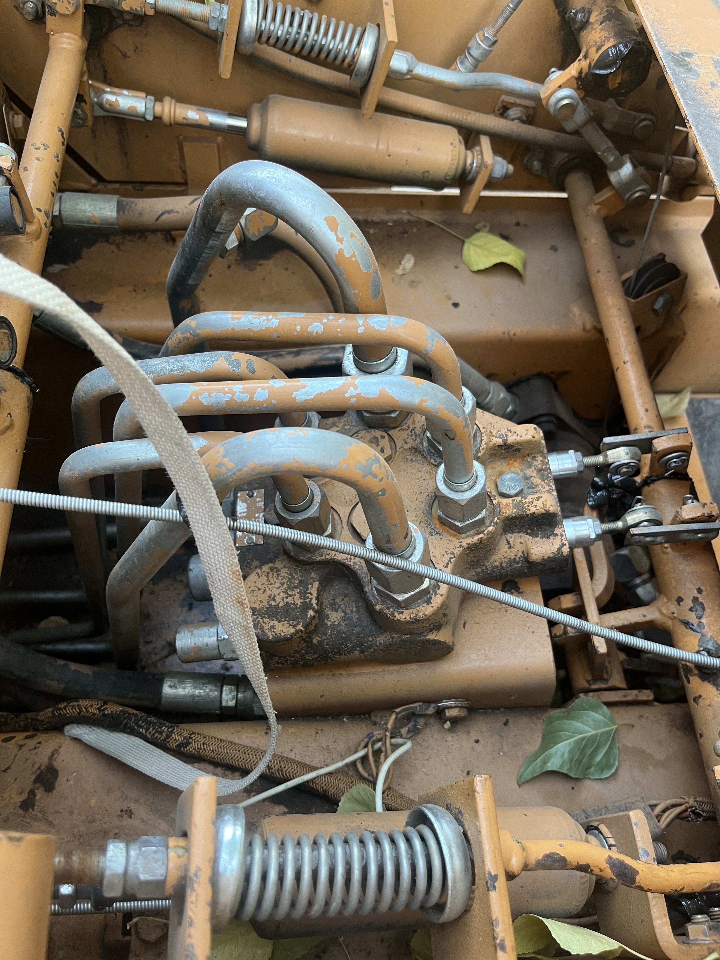

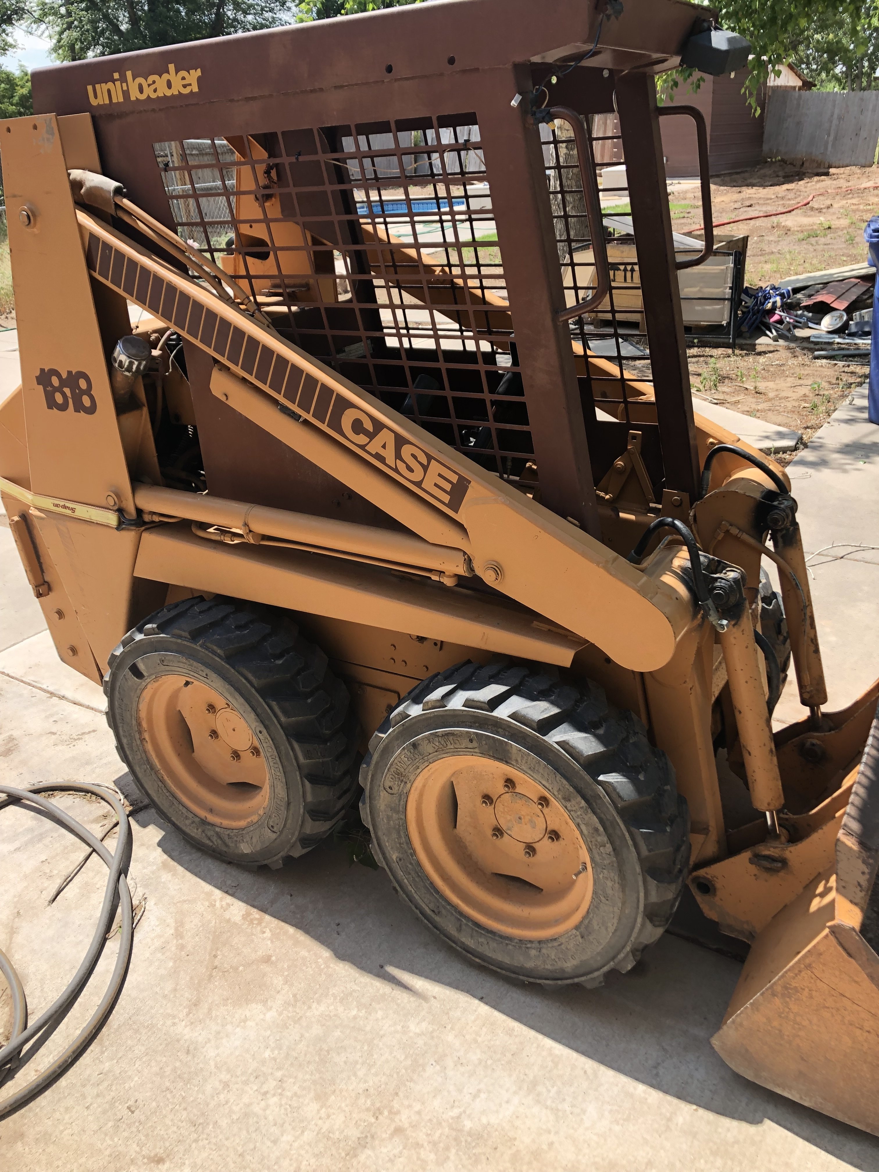

Hi all, I need help I have a case 1818 small skid steer when I have a load in the bucket it won’t lift it
It struggles and is very slow. With out a load seems like it works good. I changed the filter and fluid still does the same any suggestion's it has three belts and they seem to be ok not sure if they have anything to do with it

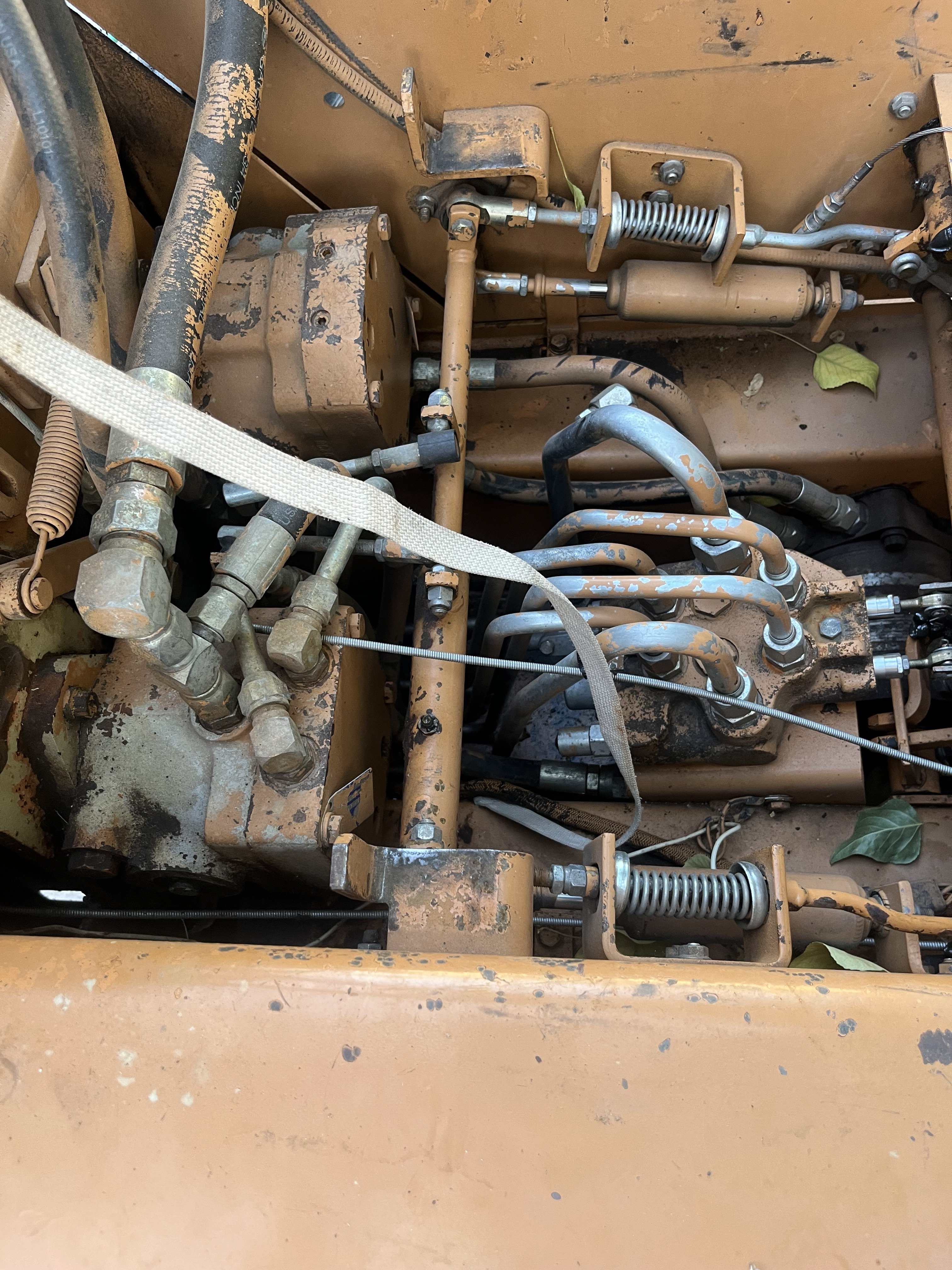

The first two pics are of the hydrostatic drive, the adjustment for those belts is the two set screws above the linkage. The hydraulic pump is above those and has 2 bolts you loosen and pry the pump up to tighten the belt. You need to take the seat out to get to them.

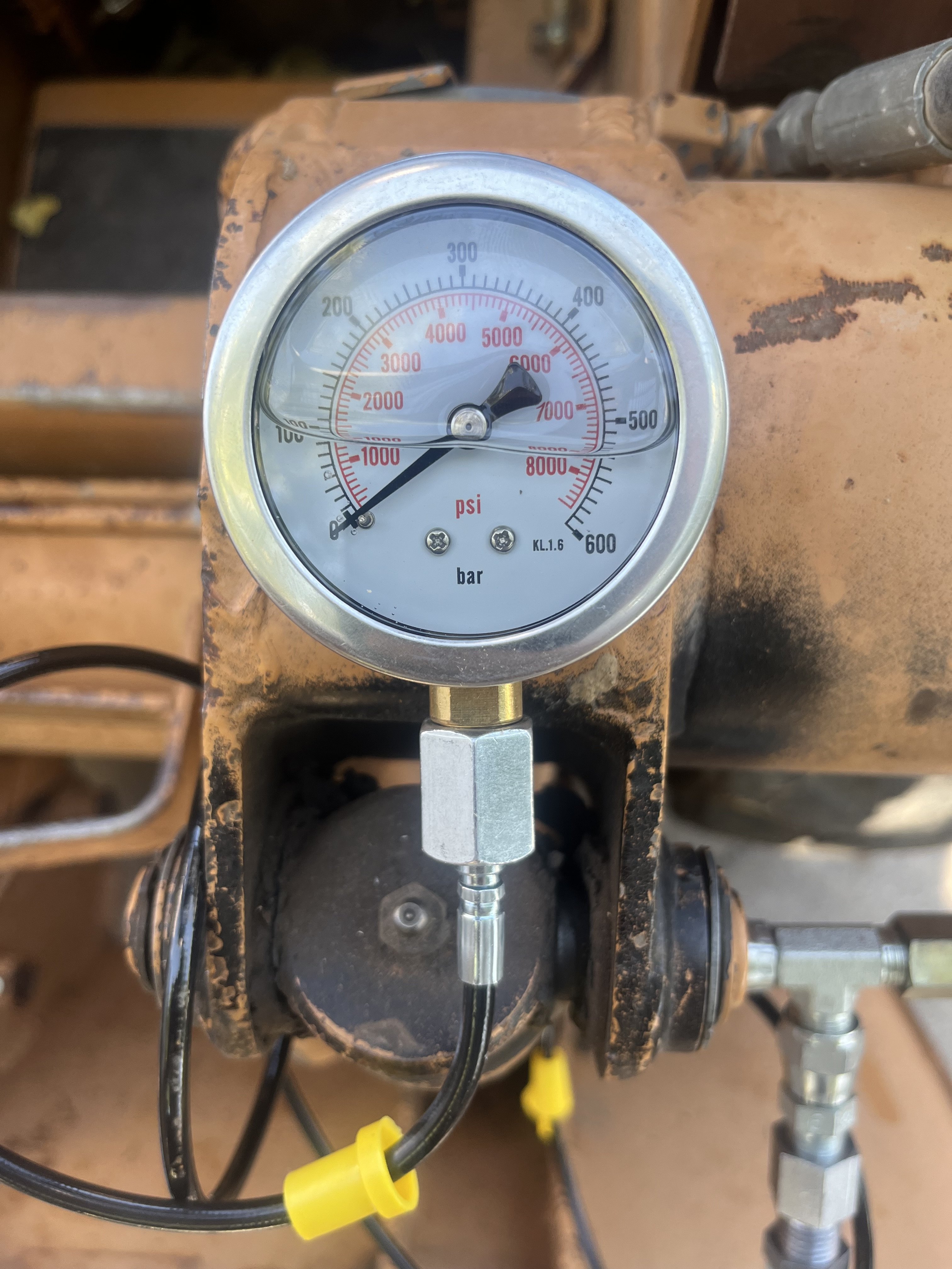

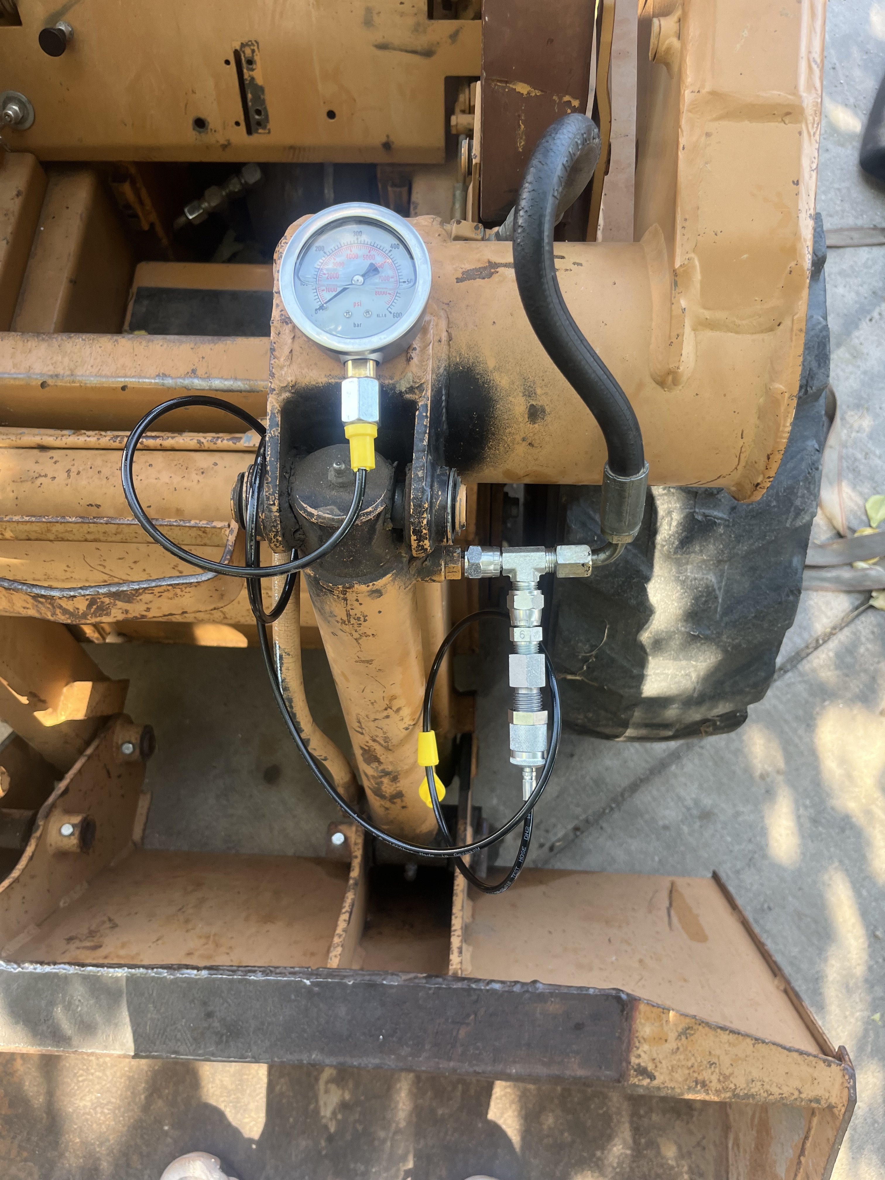

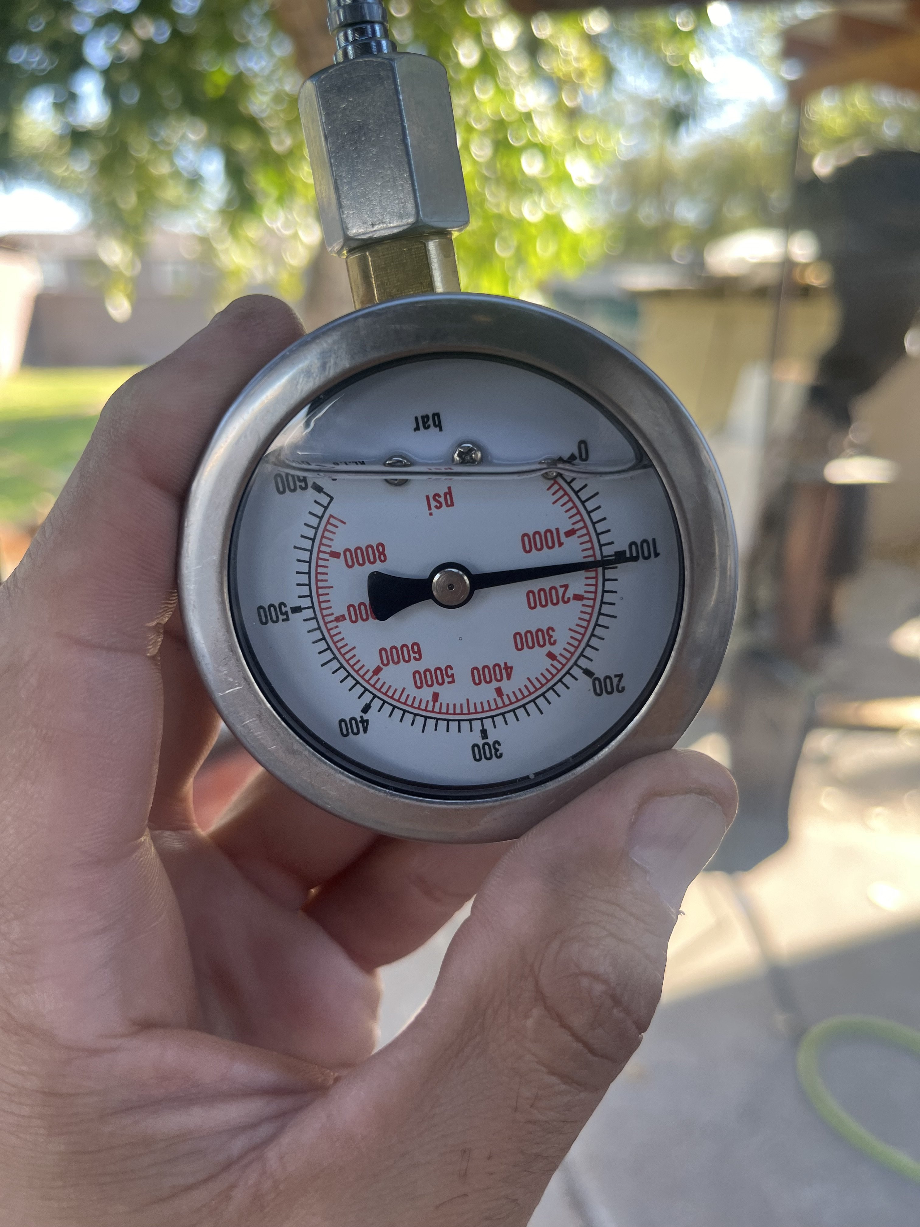

I got the gauge in today I plumbed it into the hydraulic cylinder powered up the skidder and no rating from the gauge at all I put it in full throttle lifted the bucket up down, tilted the bucket no rating on the gauge I would assume there’s pressure because it is moving the bucket
It appears you are hooked into the piston side of a bucket cylinder. Did you run the cylinder rod all the way out until the bucket stopped moving and hold the bucket control there, at full throttle, while reading the pressure?
It was on the down pressure. I guess my mistake but there is a reading now (see picture)

I’m assuming the pressure psi is ok. When I was holding the pressure to see it on the gauge the pump squeals then when I release the pressure it stops squealing I tried to upload a video, but it wouldn’t let me
Was that pressure at full rpms?
Not sure, the belt was a little loose I tightened it up still very sluggish. Without a load in the bucket, it works fine maybe a little bit lazy. On Friday I’m going to try and use it. My neighbor wants me to grade some dirt. We’ll see how that goes.
