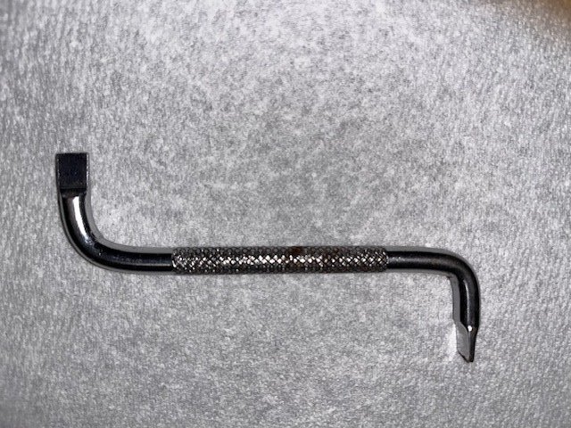

1. How the f*&$ do I get the distributor clamp loosened? The clamp screw is set in a lateral orientation and has a slot screw head with about 5/8" to get a screwdriver on it (see attached jpg: the clamp is located under the distributor in way of the arrows). Since I don't have a 5/8" long screwdriver, it would appear that, to get proper access to it, I would have to remove the starter, or at least the starter bussbar. On my parts tractor (310), the distributor uses a normal (or at least, my version of 'normal') clamp, with a hex-head bolt with a 7/16" hex-head nut, and the bolt is oriented longitudinally rather than laterally on the 530. I can't quite read the number plate on the 310's distributor, but it appears to be different from the IAD-6003-2F on the 530. Can I swap the clamp from the 310 onto the 530?

I can't make out anything from that pic, maybe a different angle? Pic 1 is my Case 310 with factory Autolite IAD6003 2J and bracket VTA2775, does your bracket look like that? Orientation?. Pic 2 is a partial list of tractors that use the VTA2775 bracket. Pic 3 & 4 is your distributor from the original Case 530 parts catalog with a VTA2775 bracket and ID. Pic 5 is a one inch off-set screwdriver. You can buy these in smaller sizes or bend a screwdriver to fit, would either work? Probably not I suspect you already been down that road. Try another pic.

The first problem is that the space in way of the distributor is so limited that I can't get my camera close enough to take a photo from a better angle (my 530 has a Model 31 loader fitted, so it's not open on the side like an Ag tractor).
As for the bracket, the bracket on the 530 is indeed the VTA-2775, in the same orientation as shown for your 310, but the bracket on my parts-310 is a different part: The hole for the screw used to fasten it to the block is in the same orientation and appears to be in the same location as VTA-2775 but the clamp screw is a 1/4" bolt oriented 90° counter-clockwise (parallel with the block and on the right hand side of the distributor) from the unit on the VTA-2775.
Having said all of that, if your 310 has an IAD-6003 distributor, then can I assume that the distributor on my 310 is also an IAD-6003 (as previously mentioned, the number plate on the 310 distributor is illegible)? If so, I can take the clamp from that unit and fit it to the 530 distributor and have easy access to the clamp nut.
As for the offset screwdriver, yes I tried that but the blade leg of my offset screwdriver is about 7/8" long and the space between the clamp screw head and the starter bussbar is only 5/8", so no go. It should be noted that the 530 has a different starter than your 310, with the solenoid mounted on the top near the forward end and a bussbar extend forward from that on the left side.
