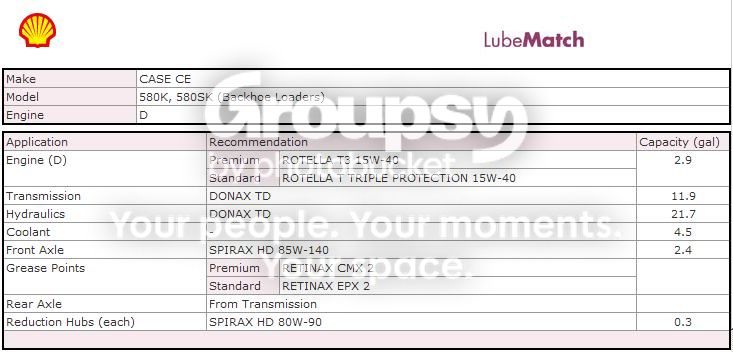

At my place we have been using Shell oils and greases for over fifty years,above is a scan of the page for the 580K.
AJ
