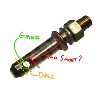

It sounds like the balls on the arms are a smidge too wide to be able to get the lynch pins in (not that you can't get the arms close enough together). I've had this on a couple implements. On our post-hole auger, I just used a die-grinder to widen out the pin holes on the auger a smidge so there was enough room (and used smaller diameter lynch pins - green in pic below). On something else (I can't remember what - may have been a sickle mower) I drilled a second set of holes in the implement pins at 90 degrees, further out to give enough room (orange). Not sure if you'll have enough meat on your plow for that though, and depending on how hard the old pins are, that might be easier said than done. Or just cut off and weld new pins on - you can stick with Cat I pins, because any newer Cat 1 pins you buy will have a longer distance between the flange and the hole.

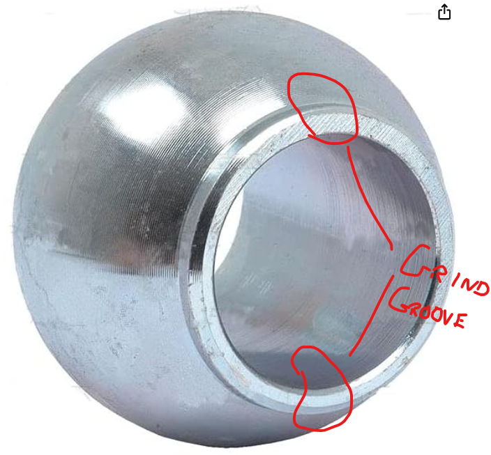

I never thought of putting a grove in the balls, hmmmm.If they're a cast piece, putting new pins on is definitely problematic. But I doubt it would be cast iron (it'd be too brittle): It's probably cast or formed steel, so it should still be weldable. If you cut the old pins off and weld new ones on (with a decent weld-prep groove and some pre-heating as of the new pin as it will probably be hardened) you'd be able to weld them on just dandy. Or us a carbide burr on a die-grinder to lengthen the holes.
But ultimately, although I say it's a shame to modify a new tractor to fit an old plow. If I were in that situation with an implement and needed to get to the field asap, I'd just do it as quickly/easily as possible. Which would probably mean shaving the balls down just like you're planning. You probably don't even need to shave the whole face of the ball down - just grind a couple grooves in it so the pin can fit in a little closer. Grind them just on one side, so when you go to hook a Cat 2 implement up you can just turn the ball to face inward and still have the same support and tight clearance to the pin.

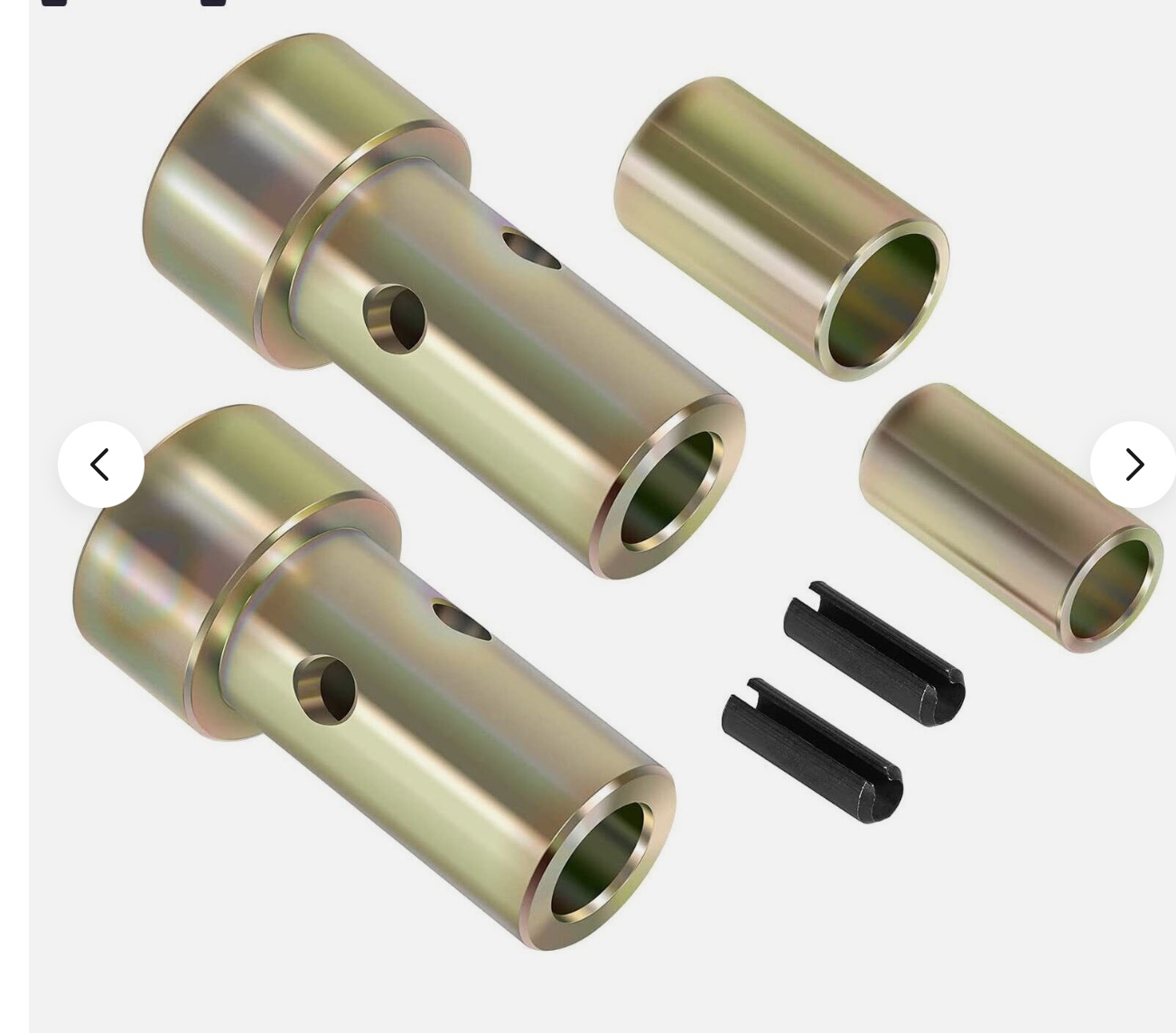

I have bushingsSome of my Fords use interchangeable balls in the lift arms, rather than having 2 sets of balls I use cat 2 balls with flat sides and just carry a set of reducer bushings to switch from cat 1 to cat 2
These balls are narrow enough to work with my Ford 3-16” plows that has cat 1 hitch
For your app I would have not issues grinding a little off the sides of those balls on the tractor to get them to work with any implements you may have and then use bushings to tighten up the fit
You’ll definitely need bushings with those plows or it’ll never plow properly
You can get lift pins for the implement that are extra long with nuts on both sides rather than a nut on one side and flange on the other side of the attachment point allowing for added room.My tractor (484) has a cat 2 3pt hitch, my plow (old Ford 2 bottom) is cat 1.
The problem is the ball ends on the tractor are too wide for the plow.
Can I just shave a little off the tractor ends to make it fit the plow.

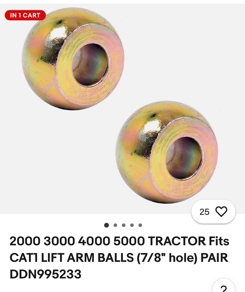

I’ve never worn out a set of lift arm balls, but I have worn out the socket in the lift arm that the balls fit in, that’s why weld on replacement ends are availableI’d really not want to modify the tractor itself for this. Those balls do wear and fall out over the years, making them narrower might cause some issues. As well they will have less meat on them for using tough pulling equipment. Looking over the years I’d just not want to do that.
