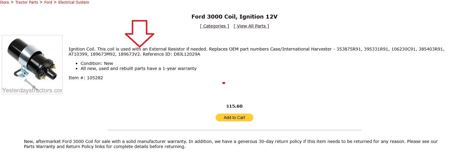

Well, I couldnt figure out why when I hit the starter switch I got nothing, drove me crazy till I touched the Coil. It was burning hot, come to find out they sent me a coil without a resister built in so it was draining the power from the battery. Freaking Yesterday Tractor!!!

Some coils are labeled as 12 volt External Resistor Required. Some say 12 volt No Resistor Required. Was the one you got labeled?

Honestly, Yesterday's Tractor sent you what you ordered. There are no such thing as "internal resistor" coils. There are "no external resistor required" coils, and "external resistor required" coils. This stems from the days of yore when 12V electrical systems were a new thing. Car manufacturers would still equip the cars with "6V" coils, but use a ballast resistor (or resistance wire) to step down the voltage. Shadetree mechanics would come into the auto parts store and ask for a 12V coil for their such-and-such, and the parts man would hand them a 6V coil, because it's the same thing. The customer would go, "HEY!" and a fight would ensue. Clueless parts man knows nothing. Foul words said. Punches thrown... Well, maybe not that dramatic, but it was a source of confusion because those shadetree mechanics didn't understand the technology.
Having a "6V" coil with a ballast resistor offers one distinct advantage. It allowed car manufacturers to BYPASS the ballast resistor during start-up, so that the engine would receive a good hot spark during cranking, when the battery voltage dropped. If your starter solenoid has a port labeled "I" that is what that is for.

My Coil was not labeled.

105282 Distributor Coil 12 Volt

So first, this is a hobby not a job for me. I enjoy figuring it out and seeing the results.
Second, if the part shows internal resistor for a coil then I expect that is what it means. If mechanics around the world think differently, okay sure.
Third, I actually called into the YDT and told them what I needed, so they are the ones who sent me the parts based on the fact that I am starting from scratch on all the parts.
Finally, the reason coming to the forum is to learn but also vent some frustration. With or without resistor is a mute point if the person ordering for me knows the story and has better insight into requirements.

Even if you stripped the wiring from the tractor it's considered a conversion. You still need the ballast resistor unless you buy the "no external resistor required" coil. A standard 12V coil requires an external resistor.

Okay, point taken on the conversion. The coil I received requires an external resistor which I plan to change out for one that doesnt require.
Looks like you got a 12 volt coil that needs an external resistor
