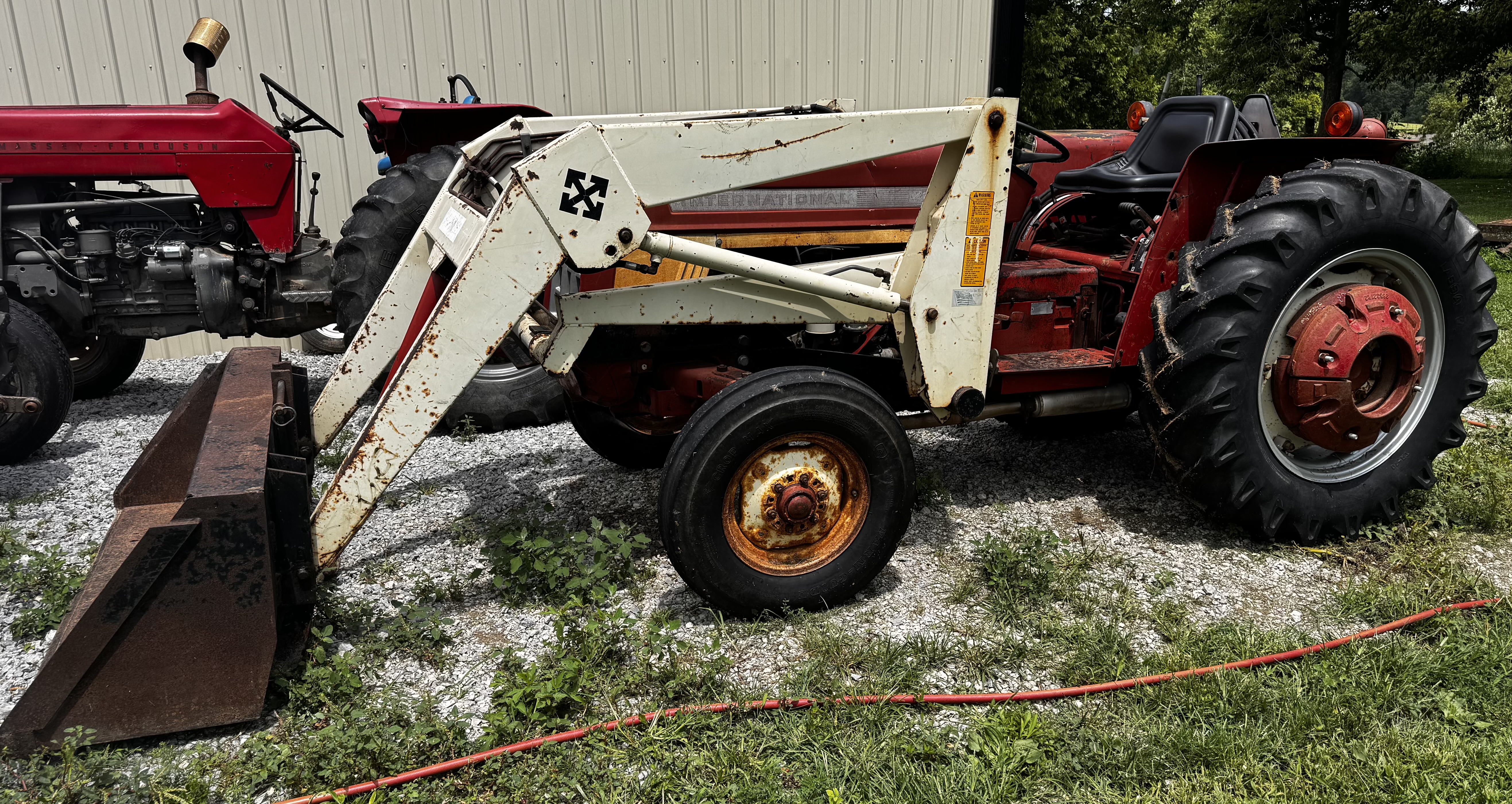

What’s some counter weight options for my loader tractor? I’ve got an IH 464 with a loader, it has rear wheel weights, the rear tires are not loaded and I don’t plan on loading them. I can’t hardly pick anything up without the back tires spinning out.

That's a BIG bucket on a relatively light (5000 lbs ) 50 HP tractor, and it's WAY out ahead of the front wheels. What are you trying to lift with it?
As mentioned, that is a pretty large bucket for the distance it is in front of the front axle on that tractor. If you are using clamp on forks or a spear for round bales the weight transfer from the rear will be even worse than just using the bucket.
