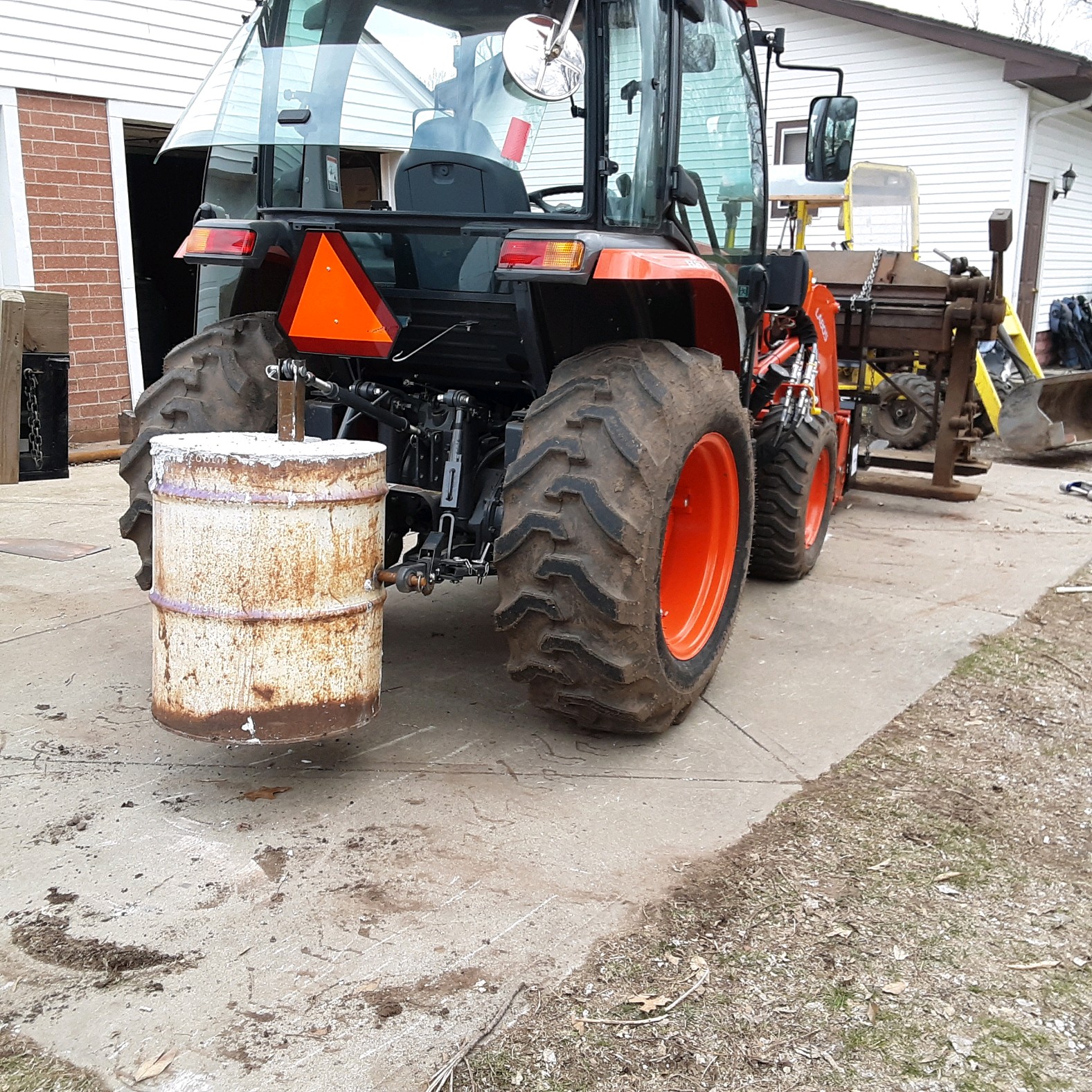

My uncle had if not exactly that same tractor and loader, really close to that same set.
We did manure runs each fall when I was a kid, the 4 neighbors all ran 20-60 beef and had a pile of manure from winter barn. Pretty big piles here in Minnesota. Anyhow that tractor did 90% of the manure loading, as the neighbors ran 4 spreaders continuously hauling.
While me and my cousin would sometimes ride one on each fender, we probably didn’t add a whole lot of weight.
The 35 gallon barrel of concrete on the 3 pt did a lot.
That’s what I would do. 55 gallons might be kinda big, with your wheel weights a 35 gallon might be about right. Maybe a 55 gallon and fill it 3/4 full, leave the top 1/4 lip as a place to store chains, tools, etc.

This will solve your issue to make it even more handy make a dolly so you can roll it on a concrete pad and move it around.
